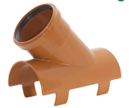

I was thinking of something like this with a rodding point above ground, then use a saddle connection to existing drainage pipe - but was unsure if the saddle connection would require further access for rodding? - there is existing access around 3-4 meters from where the new saddle joint would be made.

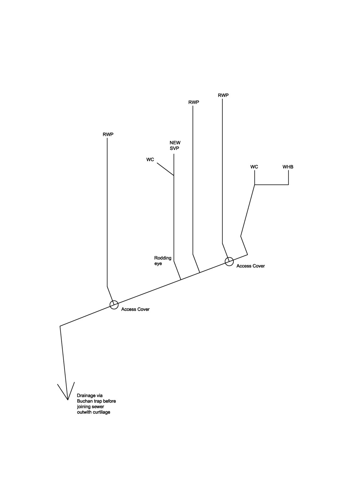

Yeah just noticed your reply as i posted - here's a really crude sketch of whats going on (its an old property circa 1850 - with combined drain)

I would imagine the RWP's shown with access covers have traps to stop smells going up them. I see now that there is no existing SVP. The drain just serves downstairs WC etc. Joining and going to a Buchan trap is all correct for the period. I have to say I've not seen 9 inch (stoneware ) pipe - could it be 6 inch bore ( I presume you're measuring the O.D. Cutting in a plastic manhole now seems the best way.

Yeah was OD measure so id imagine its likely to be 6in bore now you mention it, if using a manhole what sort of sizing do you think would be suitable? Drains prib about 1m below ground where new svp will connect, is there any particular way to connect onto this type of pipe when using the manhole? Im planning on noting connections on a schematic with the warrant but just trying to work out what i may need to show depending on report back
If its a 6" drain, you'll get away with a plastic chamber, anything bigger and you'll be looking at building one yourself. Assuming existing drain is salt glazed stoneware, you'll need to cut a section out, and join to a plastic stub fitted to the through channel on the chamber base. Your 110mm connection can use the appropriate side connection(s) as required. Nige F. has already given you a link, the main page you need is: http://www.pavingexpert.com/drain15.htm
Assuming it is 6", a saddle is a non starter, either a junction or chamber needs to be fitted, chamber would probably be the required method I suspect. At 1m depth, a 450mm diameter chamber will be ok. You'll need a long radius bend at the foot of a stack, traps are purely for gullies. Looking at the diagram, you'll probably need to fit a chamber where the WC'/SVP's join onto the runs. You cant have a blind run to a WC, that you are unable to get rods or jetting hose in to clear if it blocks. If the pipework is reasonably shallow at these points, shallow access chambers can be used. Rainwater will need to be discharged into trapped gullies, the 'Bottle' type gullies are probably superior, and offer rodding access downstream so can be connected to the main runs blind.

Thanks for this, so basically break out a section of the existing pipe and add in a new section that connects the new soil pipe and has a rodding point that can be accessed via a plastic chamber. The rwps are already connected via ptraps/or bottle traps and we shouldn't be touching these.
As far as im aware - the water company don't own this run until it passes on through the buchan trap onto the street side

Can you clarify if it's just your property using this drain, or are there others connected? 6" is extremely unusual for a single property, 4" can happily cope with half a dozen homes. Is your sketch a plan view, if so it'll make it easier to suggest what access is need at what point.
