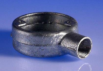

Saw this on a prev thread. These look like what I have insitu

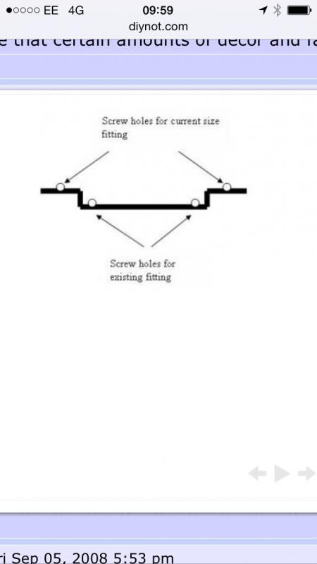

And was thinking with the use of some kind of plate adaptor similar to this
I could just put on new face plate and it would screw Into adaptor.
How much depth is there between the front of the conduit box and the wall surface? I'm guessing not enough to accommodate the internals of a switch, so you might as well just put a surface pattress over it. You can get wooden ones if that would be more appropriate.

Hi, if the boxes are round cast iron, you are snookered ! If they are square cast iron with fixings inside the box for the old toggle switches, MK used to make a conversion bracket to enable replacing the older switches with new.
That was in the 80's !

Yeah it is old round cast iron I believe so am going to see of there is enough room in front for space for back of new switch/cover and get my mate to try to make some kind of plate adaptor like I posted above.
Failing that I will just have to be careful with wires and maybe use my multi cutter to get old one out.

Is it round, 20mm/¾" diameter, or smaller and oval?
