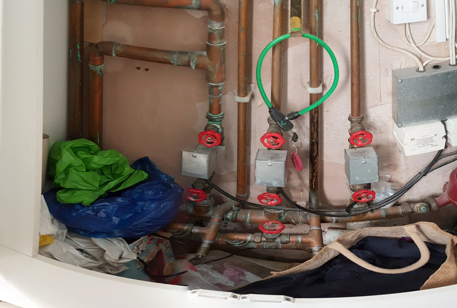

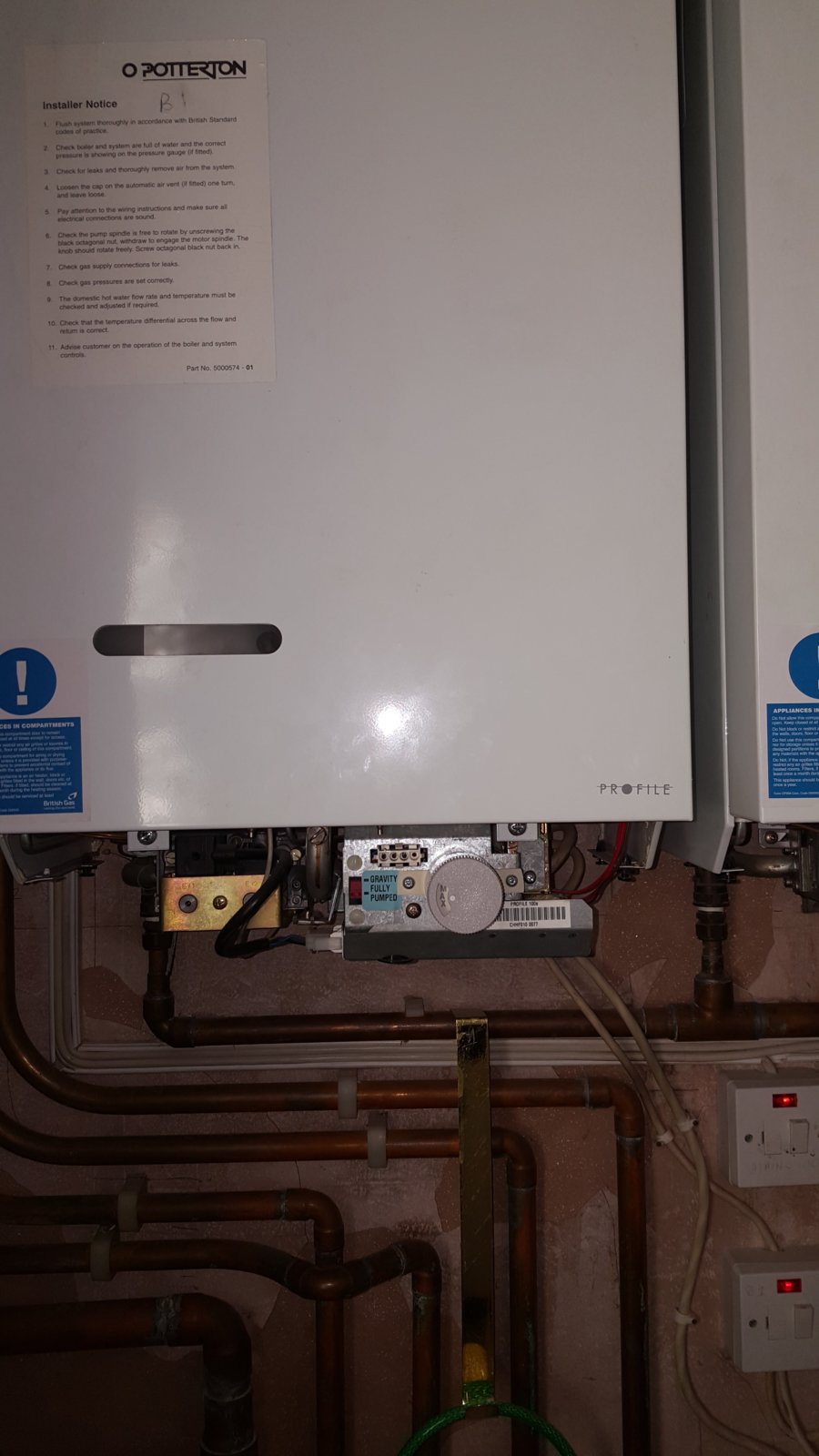

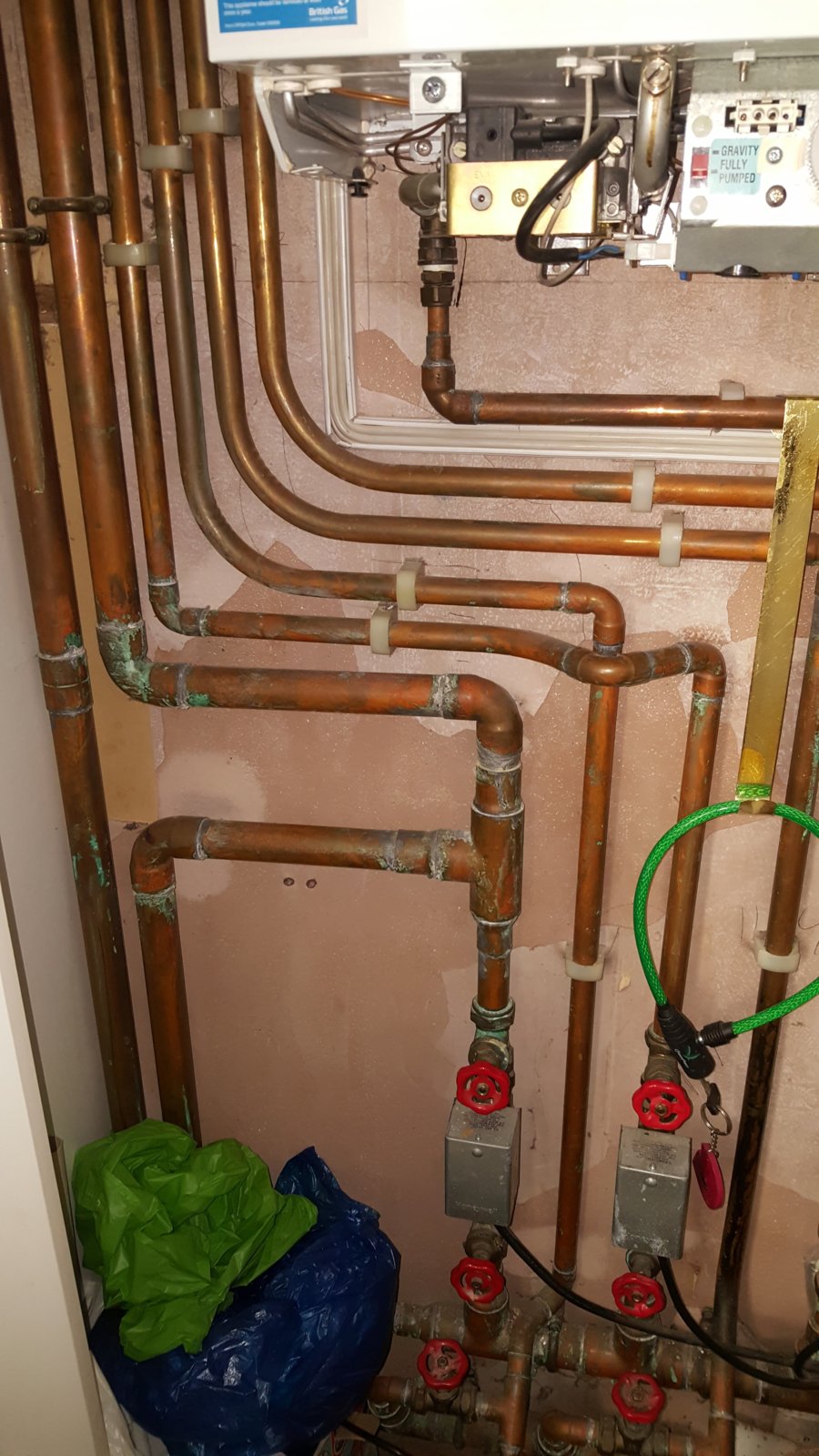

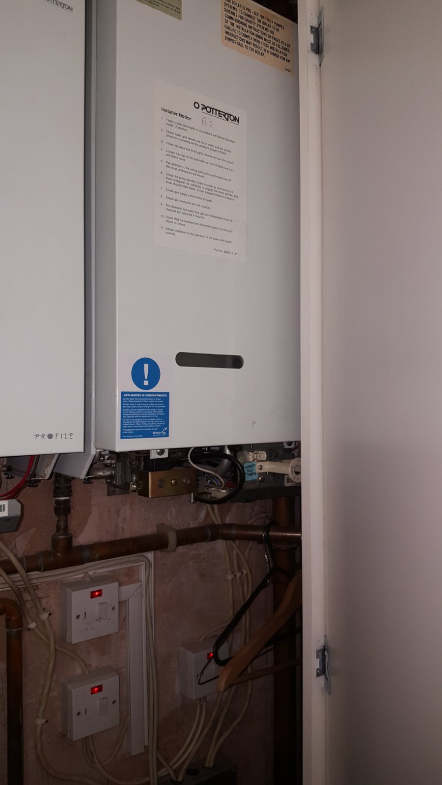

What doesn't make sense to me is the design of the system. More than one heating engineer has said that this looks like a semi commercial system (I've included some pictures of the cupboard with the boilers and the surrounding pipes so that you can make your own mind up). If it was designed well, then if two boilers were needed 2 would have been installed together initially but in this case one was added afterwards.
