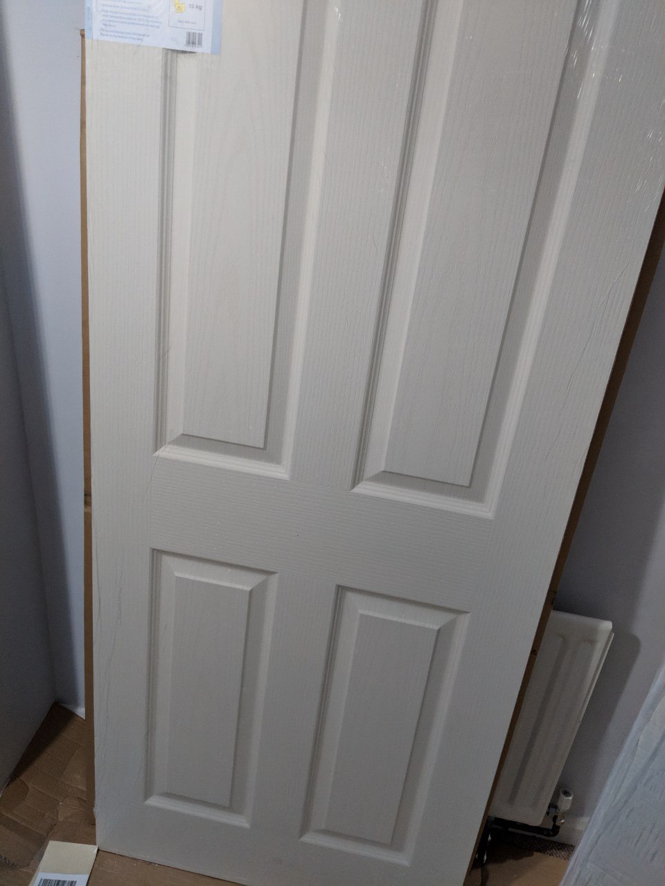

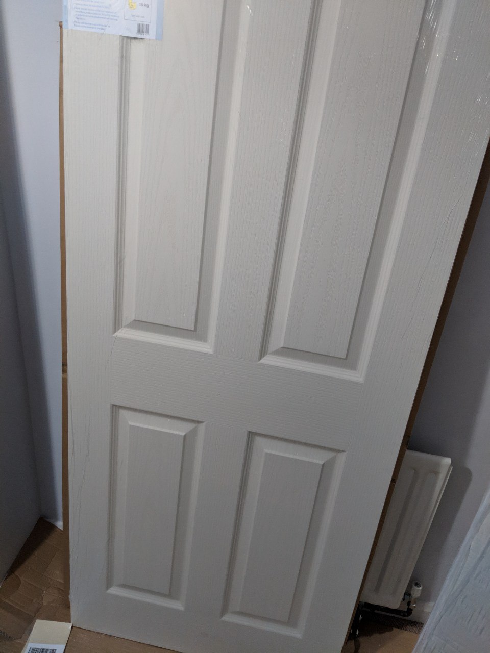

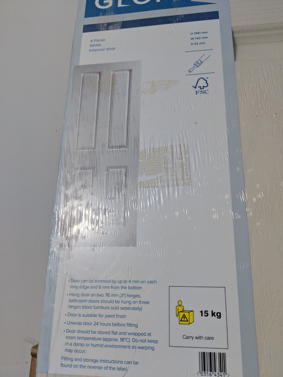

Having a bathroom installed by Wickes and the tiles have been laid on the floor over 15mm board. I had asked for a new door to be fitted which I supplied using the same measurements as the one it was replacing (bought ages ago)
I have now been told that due to the tile height the door will not fit and can only be trimmed 6mm from bottom (door size 1981 x 762 x 35). For the door to fit it, the distance is now 1940 from tile to frame. I also supplied a Z bar door threshold but obviously that is not going to work now so they are ummin and arriing the best approach.
They have told me I need to find a door that is 1940 height but think it shouldn't be my problem now as the old door wouldn't of fit either. Looking in B&Q I cant find any this size.

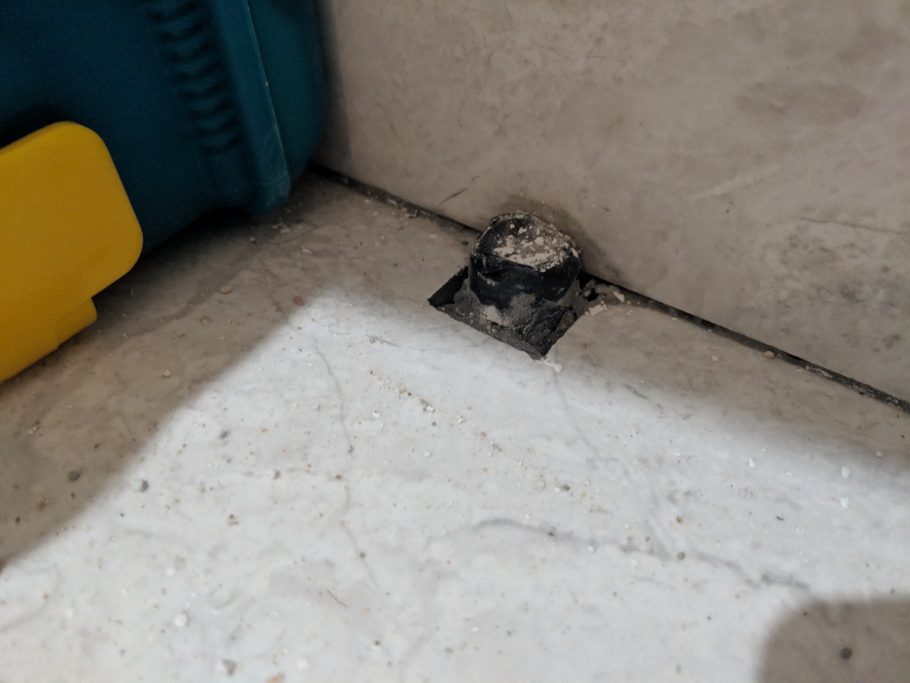

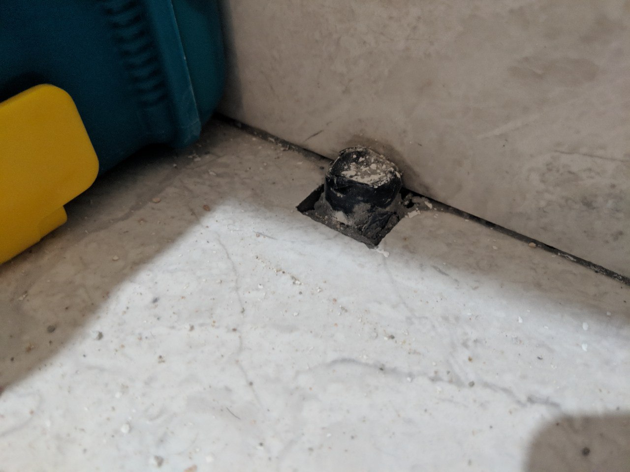

Along with the door i noticed that the central heating isolation valves seem lower than the tiles now so cant see how they will be able to get the screwdriver in to open them when connecting the new rad.
Your problem is the hollow door that you have ,not the tiles and plywood bracing. Can you post pic of door ? I have came across hollow doors, that have to be cut umpteen times . any half decent joiner can sort it.
Can you post pics of isolation valves ,dont know what you mean re those.
thanks for the reply. see pic of door and isolation valve which is taped up. If I remember correctly the screw to open the valve is midway on it - pretty sure this is under the tile line. The valve on the other pipe is a bit higher up and I can feel the screw under the tape so not an issue.

Looks high
Cut the door , clean up the bottom rail and glue it back in .

Unless the valves are fitted to pipes ( plastic maybe ?) That can be pulled up and above the tiles ,so the entire valves are accessible, then it could well be a big issue in the future.
Those type of doors are typical of what i have came across ,and can be doctored up. Timber added to the bottom ,inside, glued in.

Good point about maybe the isolation valve can be lifted. I am pretty sure there is no plastic piping feeding that rad though. I also think the pipes are horizontal to the boards quite close to the surface so we will see. Not my problem to solve though. I will be making sure the valves are accessible at the end.

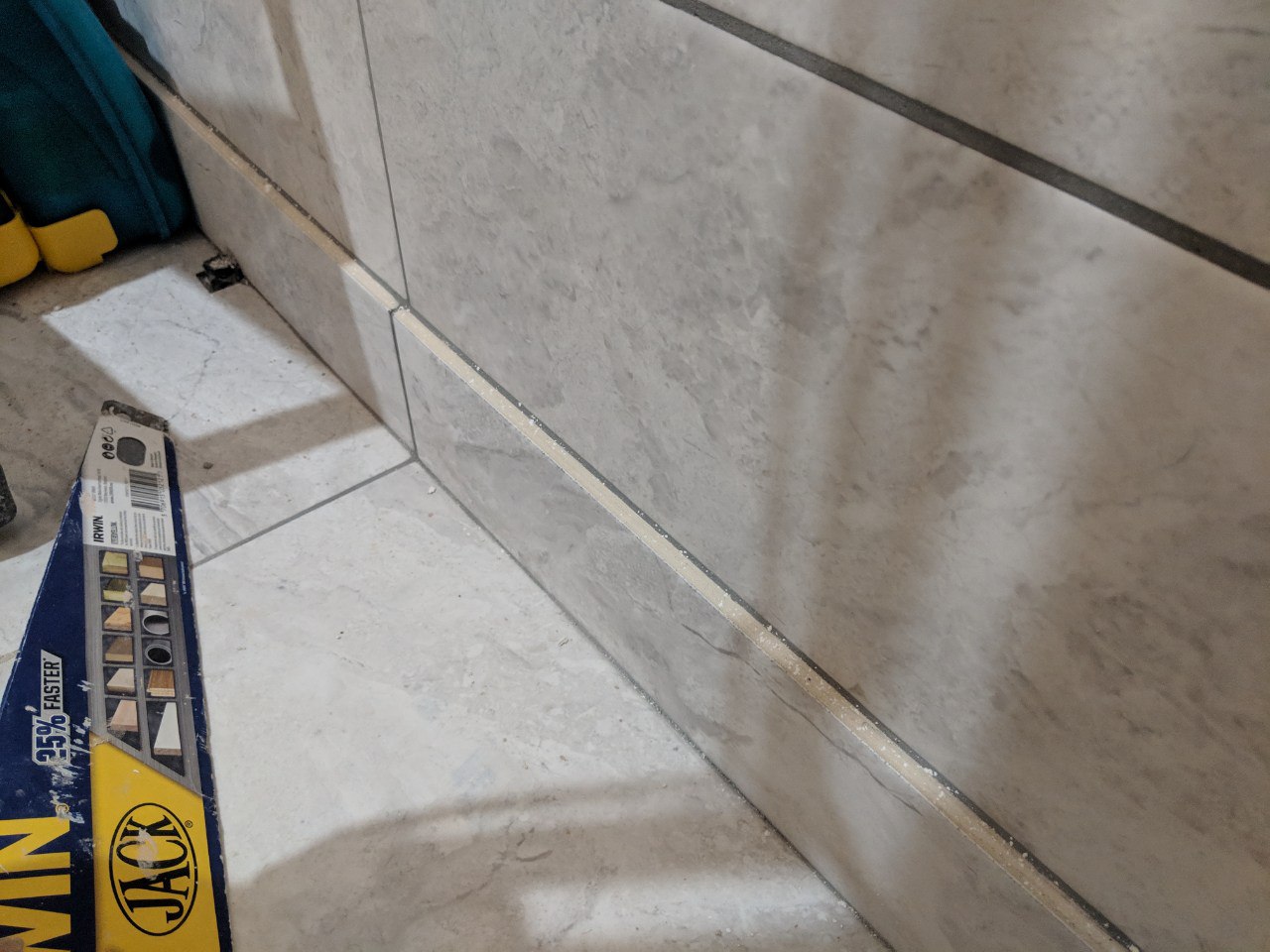

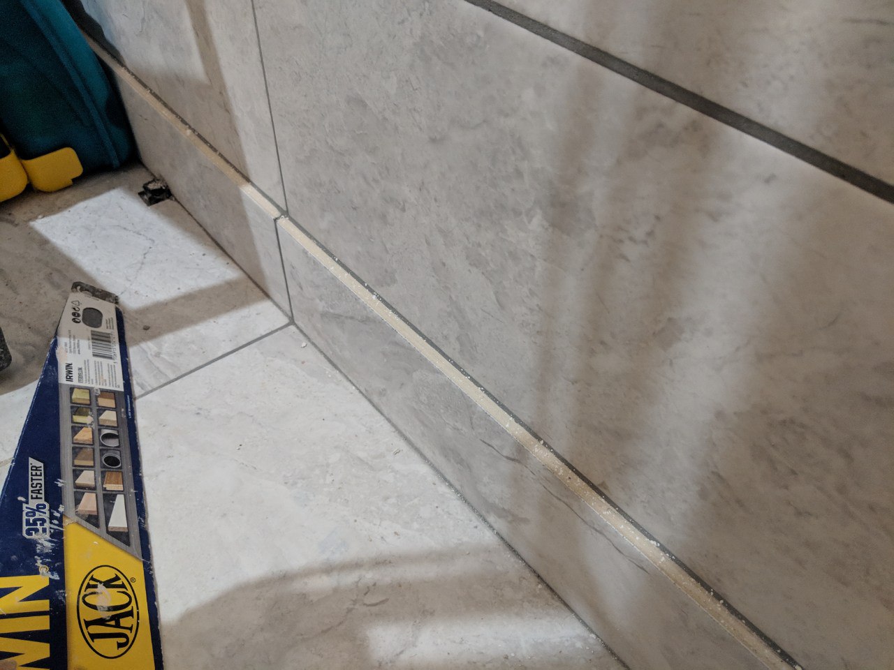

One other thing is the pic the sort of thing that is done with tiling? On one wall the tiles do not go to the ceiling - they stop half way. To match them up at the top part there was a gap at the bottom. The cut offcuts of tiles and they sit proud of the wall?

Is only 25 mm of wood bottom of your door then is hollow .
Cut 40mm or whatever from bottom , clean up the piece to remove face board with plane and glue it back in with wood glue few claps .
Half hour job , door weighs nothing .
Bathroom fitter needs to be multi skilled .
The tile skirt detail , hmm looks ok if all round ? Should of planned not to end up with a slither at the bottom , although if its what you want the tile skirt looks ok .
Not saying anything about the isolation valves until you know more
Thanks it seems like most people have said that the door can be cut / cleaned / glued so I will ask him to do that. He asked me to find a door 1940 in height which I cant seem to find so think it would be a wild goose chase. If he cant do it I will ask him to find a joiner that can. They are charging me £60 for the door hanging, so I expect a better job that I could do myself.

Didnt really understand your description regarding wall tiles only half way on one wall etc ,nor do i know the reason why the bottom row is fitted as is ,( maybe as floor tile edge's do not meet wall ,as wall is out of true and this is a way to get around that ) but it looks neat enough .

Ok basically there was no trap or u bend on the bath drainage. Its just a right angle elbow that flows under the bath to the drainage stack. Thought it was a building reg? Regarding the tiles, only have one tile high along the sink worktop area. The follows the walls and then meets the full wall tiles. The grout lines all follow a horizontal line, and have full height tiles on the worktop. To get full height tiles top level there had to be a gap on the floor. I assumed its sticking proud because it would be too hard to cut such a thin offcut of tile? I cant say it looks professional though - unless it cant be helped. Just need to know when wickes turn up at the end.

i dont now what youve got taped an buried but i do now that rad valves are self isolatin so you dont typicly need isolators lower down the pipe stubs .
no one with an ounce of experience would have buried the rad pipes like that - or left them that tight to the wall.
its almost a guarantee that thers a few other bad news surprises waiting under the prep floor an tile.
