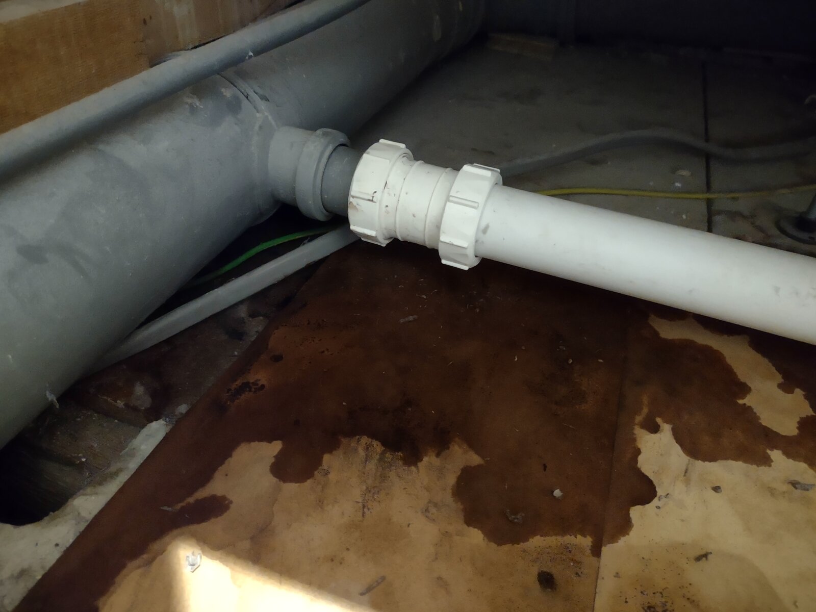

However, a couple of days later water started seeping out from under the bath panel (image below).
The water seems to be leaking where the grey pipe coming out of the soil goes into the coupling.
Questions:
1. Is it possible that the Buster did something to the seal or the washers?
2. Is the white thing I'm looking at a "compression straight coupling (40mm)" and do I just need to buy and fit a new one? (If so I'm hoping that's easy to do)

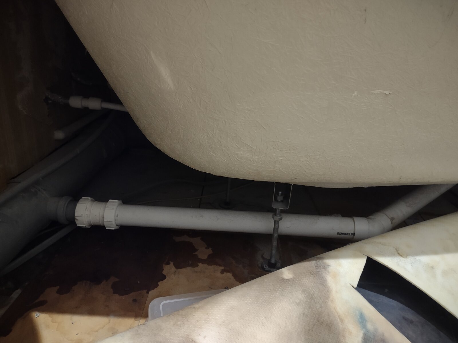

3. the overall angle of flow from the bath plug to the soil pipe seems a little shallow (image below). Am I storing up problems for the future - or should a new coupling sort things?
Thanks in advance for all your thoughts.
Bathing products are notorious for containing oils that will coagulate in waste pipes.
Especially if said pipes have insufficient fall to drain.
If you can, remove the compression coupling and the length of white pipe that goes to the bath waste, including trap.
Clean it out mechanically, outside by drawing a cloth through it (vacuum a string through and tie this to a cloth that fits snug in the pipe).
Also use hot water and maybe vinegar to help break down the oils.
Give trap and coupling a thorough clean too, including rubbers.
Put it back and test for leaks.
If it leaks from same coupling, replace the coupling.
Put some packers under the 45° fitting to stop it dropping at that point.
Clean out the boss fitting on the 4" pipe also, whilst you have everything out.
