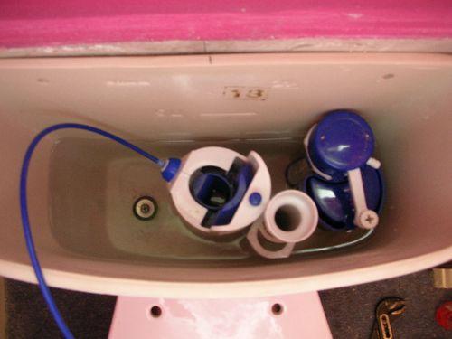

Evening all,
Fitted a new toilet today but when we turn the water on the valve doesn't stop when it gets full so it keeps filling then going down the overflow.
It's a modern type with a half flush feature but had no instructions in the box so assumed I didn't need to adjust anything on the valve but clearly something is amiss....
What should I be checking?
Thanks in advance
Make/model would be good, photos of the inside of the cistern would be even better, they don't all use the same mechanisms
Torbecks take a few seconds to shut off after the float arm has raised / you've held them up. Have you tried adjusting the float downwards? Also check that the hinge part of the arm is correctly located, if it's not it won't shut off.
turn the long threaded plastic up or down to control height of water.
Thanks for your reply, I tried this and it had no impact. The water flow is affected but either the height of the flow or whether it's up or down (even when adjusted by hand to try and stop the flow).
Perhaps I should replace the valve? Just seems strange as its brand new...
Might just be a duff one, either contact the supplier of your toilet and ask for a replacement or buy a Fluidmaster PRO45B
Thanks for your reply, it's definitely not stopping after a few seconds when pushed up by the water or by hand.
As for the hinged part of the arm is seems to move freely and was already situated in the cistern out of the box...
Thanks again for all your replies
