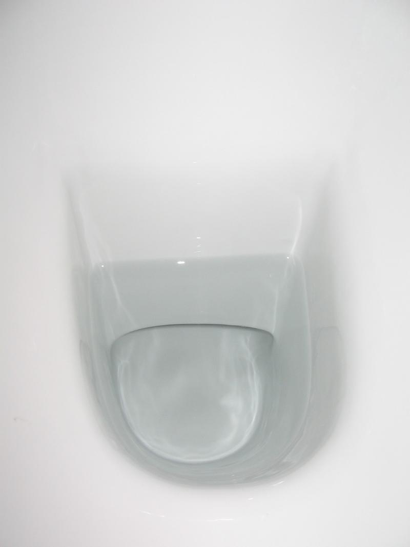

Last couple of days the bathroom has a bad drain smell, really struggled tracking it down, but my conclusion is the smell is seeping through the water inside the bottom of the toilet?? The back of the loo where the plastic waste connector is does not smell at all, but taking a wiff inside the toilet and its definitely coming from there??
How is this possible, there is good 2" of water above the trap??
It is relatively easy to replace loo with new one but thought i would ask you all for some advise before i rang the supplier and requested a new one?

hi all, after doing some reading around on the internet i reckon the pan has a hole in it somewhere and is allowing the gas to seep through the holes where the water flows through?
Does the above sound reasonable? Is there any way to prove it?
Reasonable? It sounds highly improbable, to say the least.
In 30 years - on and off - of selling sanitary ware I have never come across a pan letting foul air back through 'holes'.
Where on t'interweb did you read this?

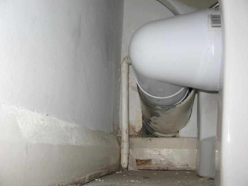

Did you re-plumb the soil pipe? What's the fall rate?
If it's too steep you can get the water travelling over the poo while the poo builds up on the pipe.

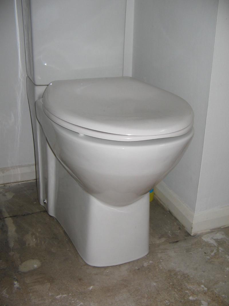

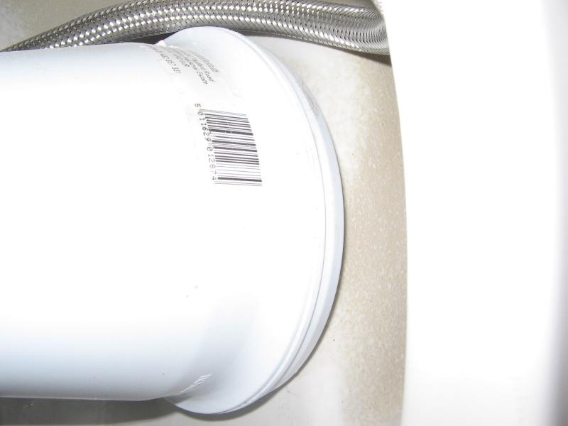

hi all,
the smell is definitely coming from inside the pan.
All around connections no smell at all!! Here are some photos, fall is same as the old toilet which was installed with no problems.
Look forward to hearing back from people as to possible other thoughts?
All other traps in bathroom do not smell, shower and basin.

forget the bog roll - put some bleach in the cistern - leave for a while and flush :idea:
because there might be something in that side of the workings that smells Like :mad: . It`s more likely than drain gas coming through any holes. Particularly as a lot of this sanitaryware comes from China :rolleyes: Peoples` republic. Who knows what`s in the clay .Never had a smell pass the trap in a WC in my plumbing experience - since 1970 ;)
Hi Nige,
Did as you suggest and i think you were right!! When i lifted the lid on the cistern could definitely smell something that was not very nice!! Cant say what it was though.... fingers crossed smell now goes away.
