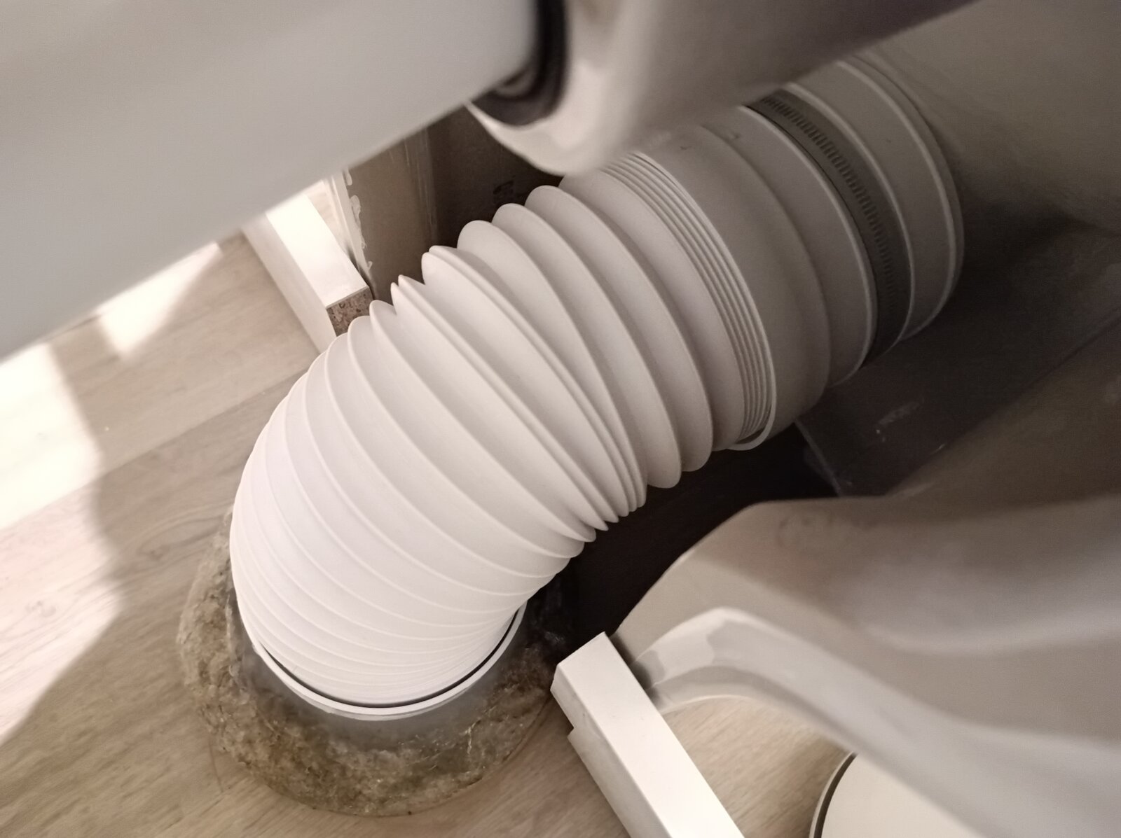

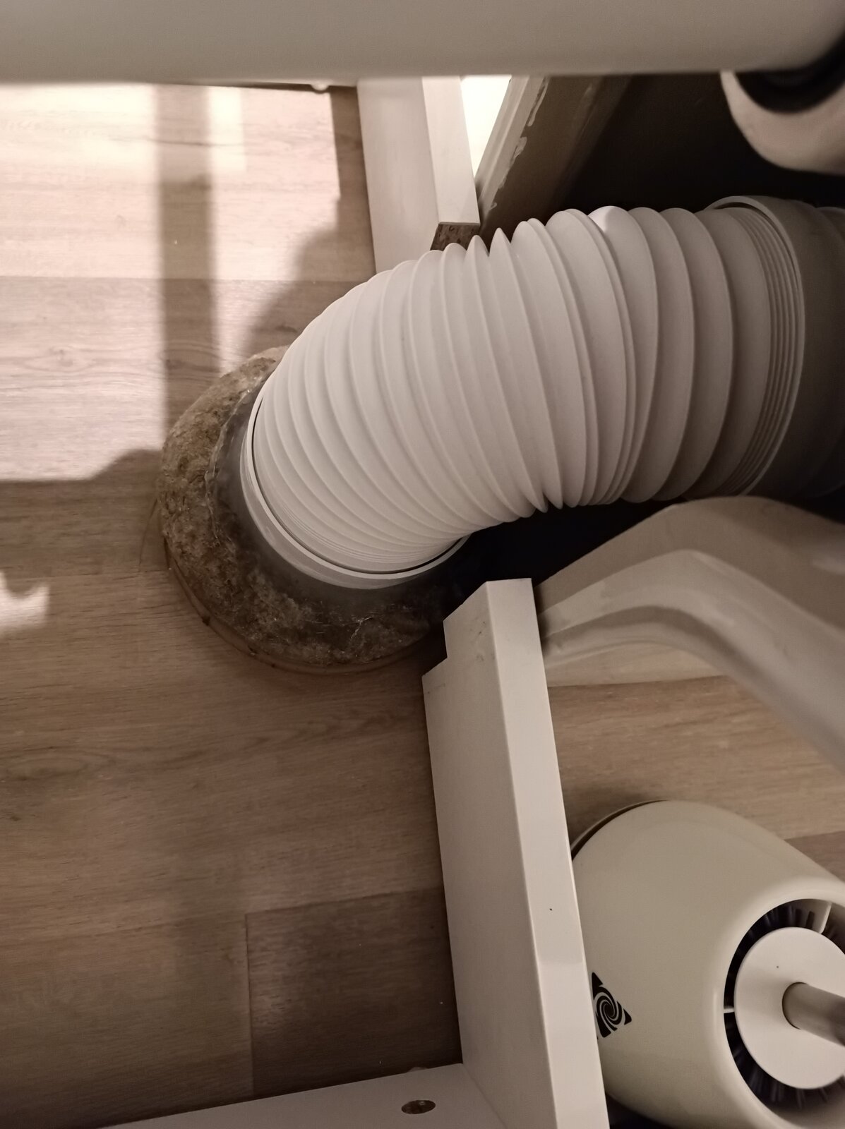

We've recently moved into a house that we've been renovating since the start of the year.
I've done a lot of work myself including fitting out the downstairs cloakroom with a new basin, toilet, cistern etc.
Everything has been running great until middle of the week when the downstairs toilet started to drain very slowly and gurgling when the water gets to the bottom of the pan.
It's been draining slower and slower over the course of the last few days and it's rather annoying.
It's a mid 1960's semi detached and the soil pipe is a clay pipe in the floor.

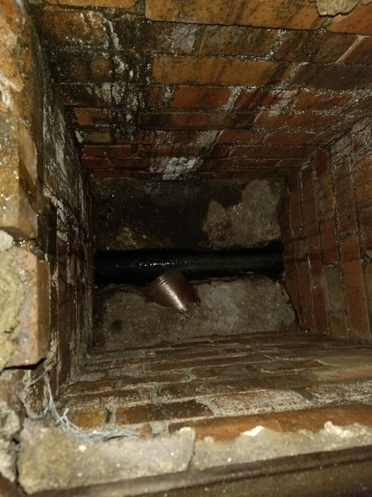

I am willing to say that the toilet and the run of pipe heading out to the street is not blocked.
We don't flush wipes or anything like that and honestly the toilet has been barely used since we moved in about three weeks ago.
I am wondering if there is some issue with air being trapped as there is no air admittance valve here, just a flexi pan connector that goes into the soil pipe in the floor.
Here are a couple of photos that show how the toilet is plumbed in:
Also a video here showing what is happening when flushing:
https://1drv.ms/v/c/99113be6c17538e8/ESAMcTGwyTZDgr85JEUkdl8Bcm1XBm-raqByaMpxT6vJzw?e=yaHOrU
To those of you with more experience with this sort of thing than me (it's the first toilet I've ever fitted), does this look like it could be trapped air, and an air admittance valve introduced would solve the issue?
The problem I have is the fall from the pan to the waste in the floor is decent with the setup as it is now.
If I introduce something like this
with an air admittance valve on the top (if this even all fits at the back), I'm not sure the fall on the waste will be sufficient, if present at all.
What are your thoughts on the above?
