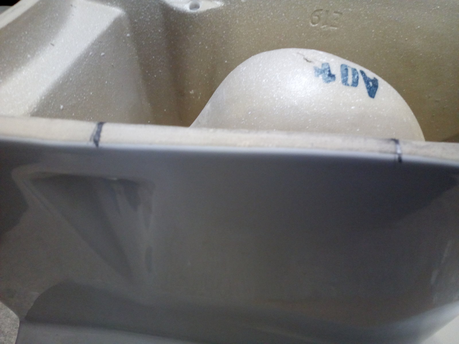

Hi all.
I bought a new back to the wall toilet from a local merchant which came as part of a furniture and basin package.
Standing it on a level flat surface it rocks from front to back by quite a bit. Pressing it down at the back makes the top of the pan level but there is about a 8mm gap at the front. So it needs packing 8mm at the front or cutting 8mm from the back to zero at the front.
Is this normal with new toilet pans? It was obviously manufactured like that. Are they easy to cut or grind?

10mm seems a big tolerance. 2mm fair enough but 10 is a bit mad. I could pack it and put a massive fillet of silicone around the bottom but I don't like that idea.
Anybody ever cut around the bottom of a pan? I'm wondering if a tile cutting blade in a hand grinder will work or if i have a good chance of breaking a chunk off. It looks about 12mm thick around the base so if I draw a line and cut 8mm off the back tapering to nothing at the front it should end up level. Do I stand a good chance of breaking it though?

you could pack it off the floor until level. Once you have got the shims right you can trim off the excess. I'd then "glue" them into place with white silicon to avoid shifting, and run silicon round to hide the gap. Put in plenty of packers to spread the load.

I can get my little finger into the gap which is all around the front and then tapers back to the rear. It's either cut it or bin it.
I want a neat and narrow silicone bead around the base it will be a 10mm fillet if I pack it.

Anyway it's sitting flat now and it was fairly easy to fix. I turned it over and found the base perimeter had a bump in the middle on both sides. It's hard to explain but the white gloss porcelain line around the bottom was straight but the clay between the pencil marks in the pic below had a 3mm ridge on it.
I used a diamond cutting blade on a hand grinder and just sanded it down till it was flat. It took ten minutes a side, better than the hour or more it would have taken to return it. I can now do the thin line of clear silicone I wanted to do around the bottom.
