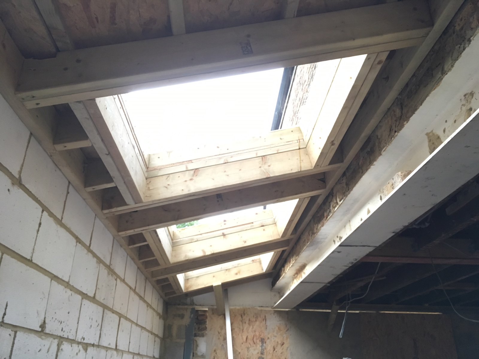

We are having a typical side return infill to a victorian terrace built. This involves a new section of roof approx 1.5m wide x 6m long, in which there are 4 large Velux rooflights.
The architect specified a GRP roof with the velux fitted to upstands. The roof is not flat but at a gentle pitch. Architects drawings showed a warm roof construction with continuous insulation just under the GRP surface. However - the builders have ignored this and built a standard roof made of deep timber joists with OSB deck, GRP on top, and pieces of Celotex pushed between the joists. There is no ventilation to the spaces within the roof.

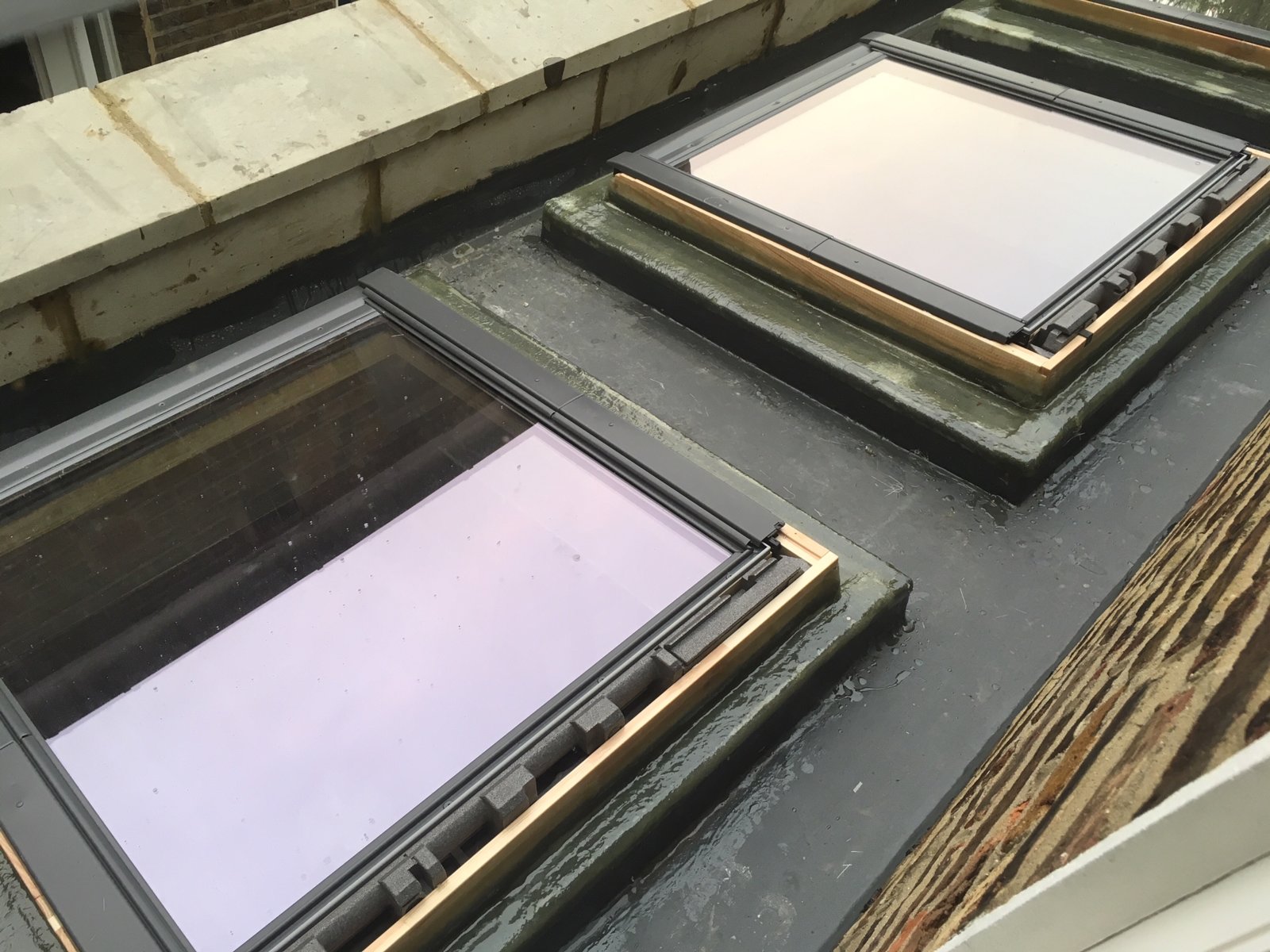

Pictures attached showing structure from below (before Celotex went in), and a section of the roof from above.

Just tack a vapour control layer (eg thick polythene or one of the proprietory types) under the rafters, tape the joints, and apply foil-backed plasterboard.

I'm not over impressed with the detail on the GRP roof- it looks as if they've just laid mat up against the parapet and slapped resin/topcoat on top (rather than flashing the edge properly). There will be movement between the timber and the block wall which will eventually cause the resin to crack and will give you leaks down the line- GRP is lovely stuff but not particularly flexible.
The detail round the Veluxes (not sure what the plural of Velux is- Velii?) is disturbing as well- the (admittedly brief) training course I did on GRP rooves advised using preformed trims for sharp angles like those for similar reasons.
Thanks oldbutnotdead - the 'Velli' do have preformed L shaped trims embedded somewhere under all that GRP, and will of course have the Velux flashing over the top.
Your comments on the gutter detail are useful and i will see if they can improve that junction - thanks.
