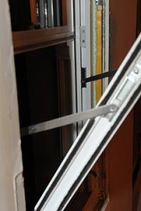

Hi everyone - we're having problems and hope you can help.
We're putting new windows in and we've noticed that when its windy there's a massive draft blowing up through the window - where the upper and lower sashes meet in the runners. I have no idea about windows so what could be the cause and how to fix it?

I assume they are Eco-slide from http://www.victoriansliders.co.uk/
I have fitted about 100 of these in the last few years, Many of which were in rural and windy locations and I haven't had any call backs for drafts so I would guess at a fitting problem.
Could you post some pics?
Here are a few pics.

Let me know if you want any specific angles or close ups - I took what I thought would be a helpful collection of pics but as I say I'm no expert.

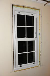

Your pics are a bit small. Can you post a big one from straight on inside?
I would be looking for any bows in the frame to start. Get some straight edges (preferably a 600mm level and 1200mm level but straight bits of wood would do). Put them against the sides of the frame and the cill on the bottom and look for any humps or bows.
I haven't fitted any other makes of sliders for about 10 years so its hard to make a comparison but I have found these to be very good windows.
I've tested the frames with a bit of trim that seems straight and the frames don't appear to have any humps or bumps. The drafts are only coming through one section of the window and the guys were here today - the fitter had a good look and suggests adding a little more fluffy trim and beefing up some of the fluffy thats already there - if it works we're happy. They're not doing anything till they've spoken with he manufacture... Where we are is VERY exposed so I guess we're getting winds that may be unusual. Having said that the frames did pass all the tests so I'm even more confused as to whats going on. Whats the standard procedure for this kind of situation?
Heres a straight on pic
//www.diynot.com/network/mwh11/albums/24348/91588
