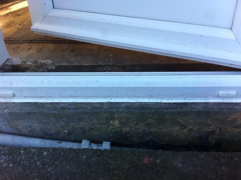

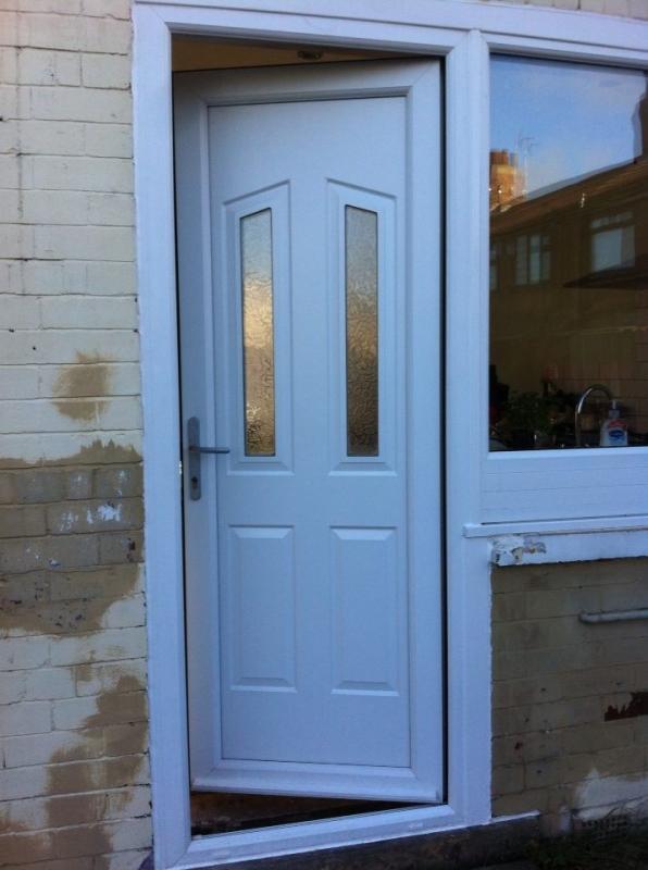

Hose the doors down from the outside , especially the base and see if anything gets thru. A pic of the actual installation would be useful.
So that's the back door from the outside, excuse the paint work, a job for the summer

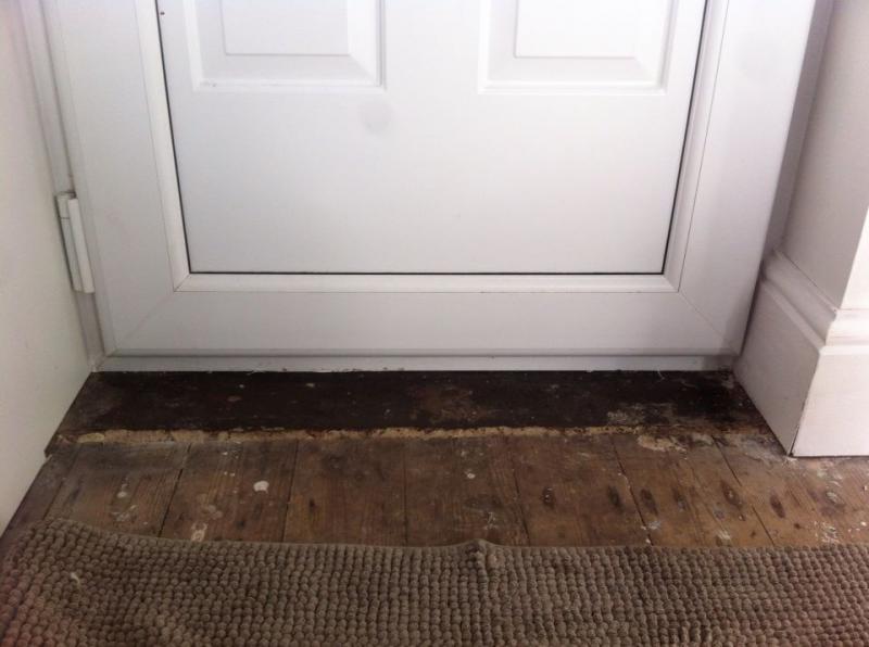

The bottom of the frame from the inside

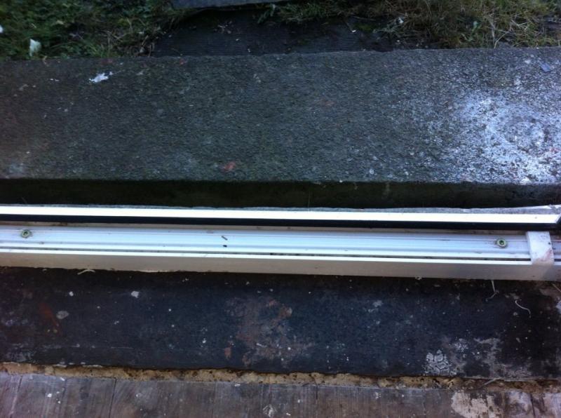

The bottom of the frame from the outside. The pipe going inbetween the pipe and the second step is the washing machine waste pipe and doesn't affect anything.
then this is from inside with the wet step and the skirting which has warped.
Are the weep holes clear, if water gets into the bottom frame section, then it should run out thru them.
Hi, Yes completely clear. One of the technicians thought water was getting down through the two screws that fix the bottom in place, as when we poured water in various places that seemed to be an entrance point, so it escaped through the drain holes and it leaked out from under the frame itself.

Ok this could be getting in a hundred different ways so its going to be a process of elimination. The fact that they have taken out and refitted the door will hopefully have cut these possibilitys down though.
My first starting point/guess would be that it is soaking in through that exposed concrete step. I would get a couple of coats of bitumen paint on it a.s.a.p.
Looking at your second picture I can't clearly see the drain holes in the bottom of the door frame. However they must be there if water is draining out from under the drain caps on the outside of the frame. I'm just wondering if the door was originally meant to sit on a plastic cill, which would mean the frame would be base drained. Were the drain holes and caps on the outside added afterwards?
I just spotted this bit.
There are 2 options for drainage on a door.
If the door is made to be fitted on a PVC cill, The drainage holes are put underneath the door (called concealed drainage). If the frame doesnt have a cill the drainage holes are made in the front of the frame and covered with those little caps (face drain) as you have.
Now what can happen is that someone messes up in the factory and puts holes in the bottom of the frame and the fitters dont notice so they drill some face drain holes thinking they have been forgotten.
If this has has happened to yours the water is just going straight out of the bottom of the door and soaking into/through the step.
Try pouting some water into the bottom channel and see what happens. Go slow to start with, If you pour a load in and the section fills upto about 15mm it will start coming through the face holes but you want to try and see if there are holes underneath.

That suggests to me exactly as gazman says, it has mistakenly been drained right through (called concealed drainage), the door needs to come back out and turned on its side to check for these slots, if they are there they need sealing with silicone, can't believe they wouldn't of checked for this though, its a classic manufacturing mistake
The yellow arrow shows where the 'face drain' slots are and covered with face drain caps just to tidy the hole up, water enters through the slot indicated by the top black arrow filling the chamber up till it reaches the drain level and then it exits, the black arrow underneath shows 'concealed drainage', you would generally have this IF the frame was sat on a pvc cill, water enters as before but it drains straight through the chamber and out over a pvc cill (which you don't have or need because of the stone cill), because the frame is sealed outside to the stone cill its not letting the water drain away hence it drains backwards.
My take on it is that the manufacturer has mistakenly drilled the frame from underneath (bottom arrow) for concealed drainage and the fitter has drilled face drainage holes on site once he realised there was no cill involved and didn't check to see if concealed drainage had been put in by mistake, but if the door has been taken out because of the leak then this is the first thing you would check for, if they haven't then I'm sorry but they shouldn't be fitting, stick to sweeping up
