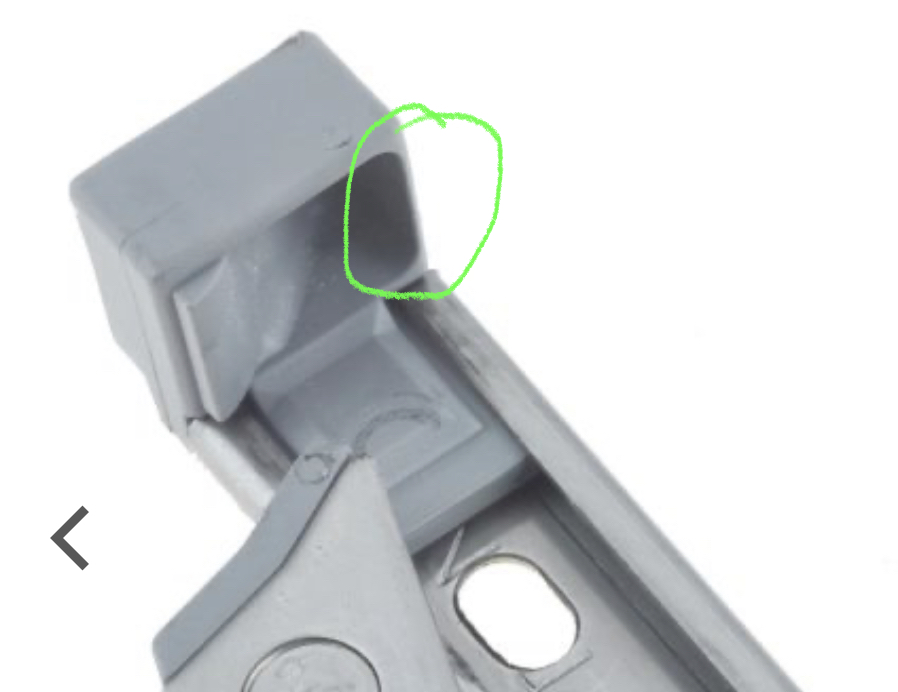

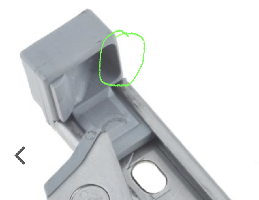

Hi all,
Just a quick one, have spent a large amount having all the UPVC hinges on my windows replaced, as they were sticking/broken/not closing.
And I’m very happy that my windows now work ok with not a single draught
Was going around cleaning all the frames afterwards, and noticed that on the majority of the new hinges, the hollow square plastic clip thingy (the one that the hook thing on the top of the window side of the hinge goes into, to pull the window close to the frame when closing) are either breaking or looking squashed/distorted already.
It’s as if when the window closes, the hook is not fitting into that socket properly, and is pushing out/on the plastic causing it to break/distort.
Now, all my windows close better than they have ever done, so just want to ask the community if that’s ok?
Or am I looking at problems down the line? It feels like it shouldn’t be happening, but I’m not an expert…
You all are :)
Thanks.
That’s the exact hinge, all those plastic bits are already broken, squashed, or deformed, have circled where the damage is occurring
It’s only been a week since install.

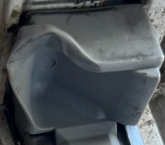

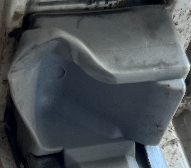

You have to bare in mind its metal on plastic and a snug fit so there will be a degree of marking up, any pictures?
Hopefully that’s all it is :)
Pic attached, if it’s to be expected, that’s cool
Blimey, thats incorrect. I suspect 13mm stack height hinges were used and you needed 17mm, it basically the thickness of the hinge when fully closed, as the hinge folds closed the casement is drawing the two hinges together not allowing the point to fit in its corresponding cup but riding on the edge of it, 17mm hinges required OR retain the hinges but use stack height spacers to convert the 13mm to a 17mm
Thank you. Do you think they can put the packers in now with those damaged parts, or is it whole new hinge time?
Salvageable, the point will locate into the middle of the cup afterwards so the little damage you have just becomes cosmetic
so not a total start again.
