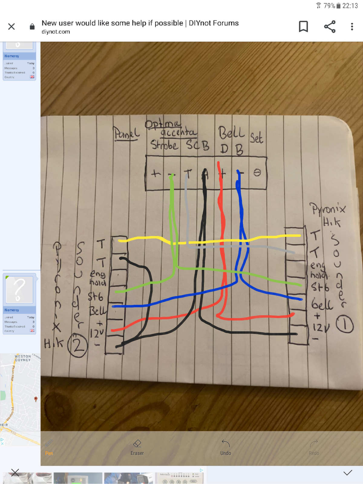

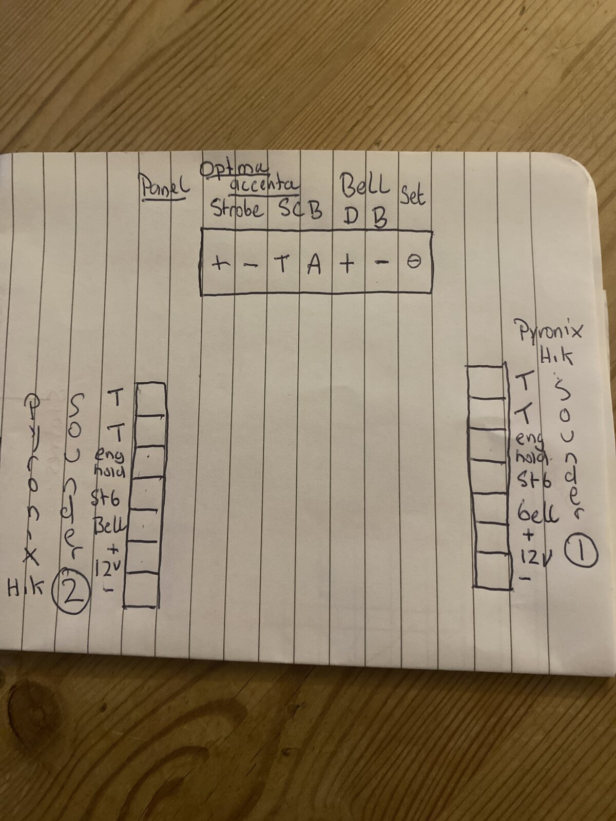

Good evening everyone , I am new to the forum and am looking for a little help from if possible from an alarm expert “guru”out there, I know the general wiring of the alarm but I am stuck with wiring an additional sounder , mainly the 2 tampers on both sounders I have included a diagram of what I wish to wire up.
The panel is a optima accenta ( Honeywell) and the 2 external sounders are pyronix hik vision.
Any help would be very much appreciated

Are both bell boxes wired back to control or from bell box to bell box ?
Hi
I have only just started to install this as a new system so I can wire it either way.I have enclosed a photo of what I wish to wire.
They will both be connected back to the panel, I am stuck with where to wire the t”s to on the pyronix sounders??
Wow Jo thanks Is it correct in saying I will need to change the mode to battery power on one sounder and disable strobe as there will be too much drain on alarm board??
No
Both strobes will be ok
On your bell boxes are jumpers for SAB & SCB make front bell box SAB and rear bell box SCB this will reduce current drain in alarm.
Depending on the bell power available on the açcenta and the bells draw in full alarm you may be able to have at full volume.
Would need to know models of bells being used to work it out.
It may be possible to take power from elsewhere on the panel depending on exact model and what's connectes
