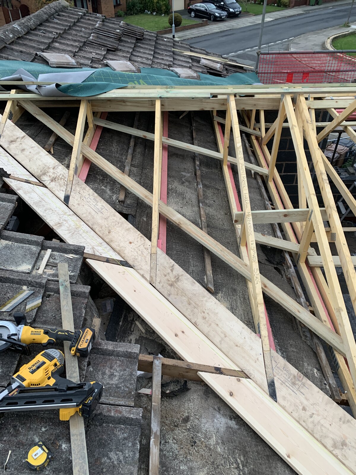

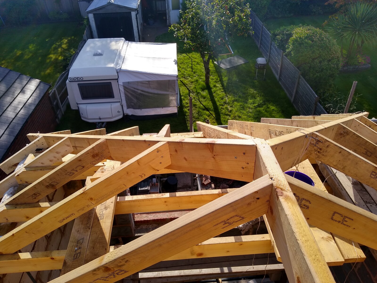

Here’s one of mine by the way, I just did it flush at the top and bottom.
I used 8 x 1 timber for mine, supported by 2 x 1 battons which I fixed to the trusses.
I also bought the compact circular saw especially for the roof - it’s a amazing little tool, made life easier when cutting these boards, and the battens, fasciae, soffits, etc.
Thanks for the pics and link Andy, both a great help. I think I can visualise it now. I guess using trusses rather than a cut roof means you didn't need lay boards. I was surprised to see that the tiles are laid so close to the upstand on the dry valley, I would have expected problems with leaf blockage but if that's how it's done!
