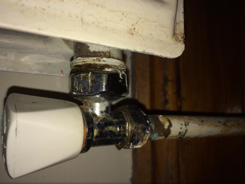

Some searching has presented a few similar threads, but not clear enough for me to understand the solution to my problem.
I have old radiators. One of the TRVs on one radiator was corroded closed and the lockshield at the other end leaks. I picked up a 15mm TRV and lockshield from Screwfix (for £6 - insane price). Replacing the TRV was easy enough. I used a freezing kit to avoid draining the system, very cool. When I went to replace the lockshield, I found the fitting to the radiator was a lot bigger than the valve and tails that came with it. I can't now easily get to the inside of the fitting, because my freeze thawed. The outside measurement of the nut is about 30mm, so I guess the inside is 3/4" or 1" - perhaps someone knows which is more common where it's not 1/2"? Photo included.
My question is: what is the easiest/cheapest way for me to replace this lockshield? Which parts do I need (with a minor preference to use the 15mm lockshield I already have). I think the answer may involve a bush, but I can't picture the obvious solution.
Thanks in advance for any advice.
