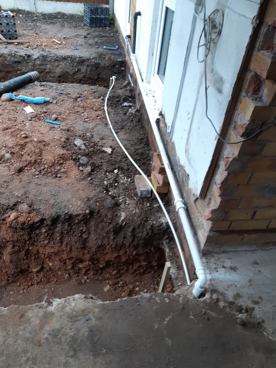

Seems we are doing exactly what you are proposing on yours.
We knew we would hit the water pipe at some pint during excavations, so we made sure (as we always do) that the road stop cock was working. We 'found' the water pipe unexpectedly when digging the first trench and were able to trace it back to an incoming position just outside the footprint of our new extension and at an optimum position to work on.
We cut the pipe and put a tee junction on it with one of the tees going back to the original supply inlet and the other we fitted 20mm blue plastic into our new extension. We fitted our own hose tap on the new blue.
Ultimately the new blue will become her new stop tap position and the old tee'd off supply will be blanked off.
We also re-hashed both her 40mm wastes and temporarily routed them into the new drain position so that she has no interruption to washing etc.

Hi guys. Wanted to get more advice on this.
We have got the costs back from waterboard and its going to cost £1100 to re connect. Would of been free if it was like for like swapout but as we are going seperate theres a cost. Thats fine.
I wanted to ask a little about fittings, im looking to put my own isilation valve down my drive, before going into the house stopcock.
What are the best brands to look out for when it comes to underground stop cocks? I seen the reviews for 25mm floplasts and they seem hit and miss, some suffer a leak at the stem.
Should i go brass body? Seen some philmac ones but not sure on the quality.
In the house im going to use a jg speedfit that is 25mm mdpe to 15mm.
Entry will likley be insuduct. The boiler is on the wall that i will be bringing the pipe through and i dont think i can get the bend radius using a duct.
Any help here would be great
