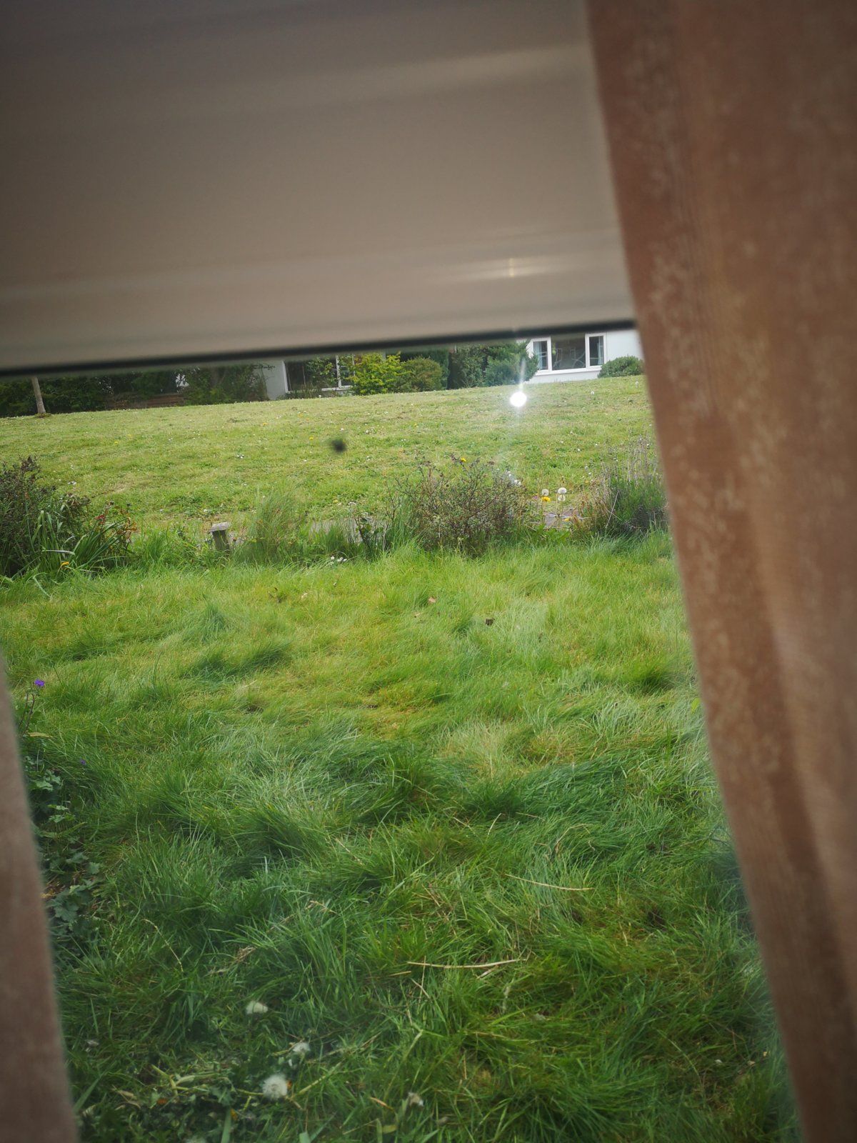

I just had new windows and French doors fitted.
One of the bigger windows has a black mark on the inside of the double glazing it can't be removed from the inside or outside of the house.

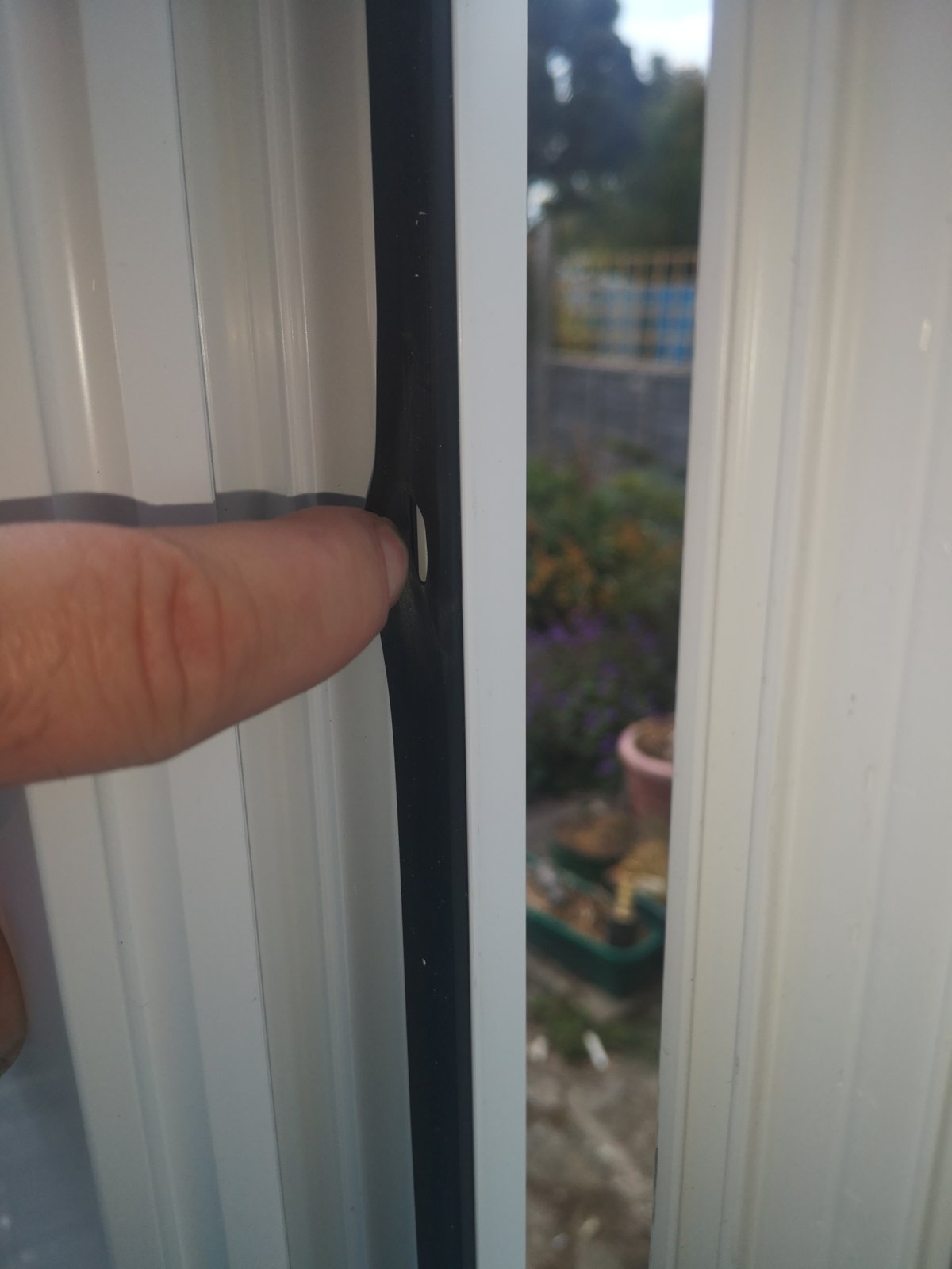

One of the seals on the French doors has a split of around 1cm

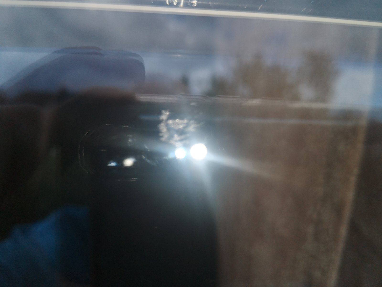

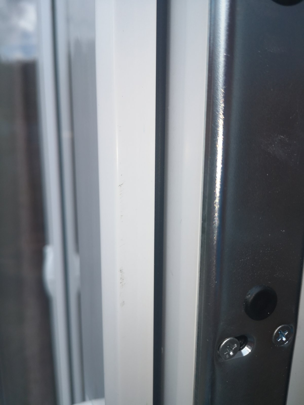

Also there some small scratch marks on the outside.if the French door trim where the French doors meet, and minor ones on the inside in a similar place.

Was only when I went to see for 2nd time, I checked out the french doors and saw the marks, which I tried to wipe away and realised it was small scratches with dirt, the black mark initially i thought was on the outside but later found was on inside of the glass panels.

The scratches and the mystery black mark may be tricky but only maybe- civil court = most likely rather than beyond reasonable doubt. The split seal is unacceptable. Give them time to respond (14 days is reasonable) then escalate if you need to.
Oddly the most expensive fix will be the scratches. Mystery mark on glass- replace the glass. Split seal - replace seal. External scratches- doubt they'll buff out, new frame incl fitting.
