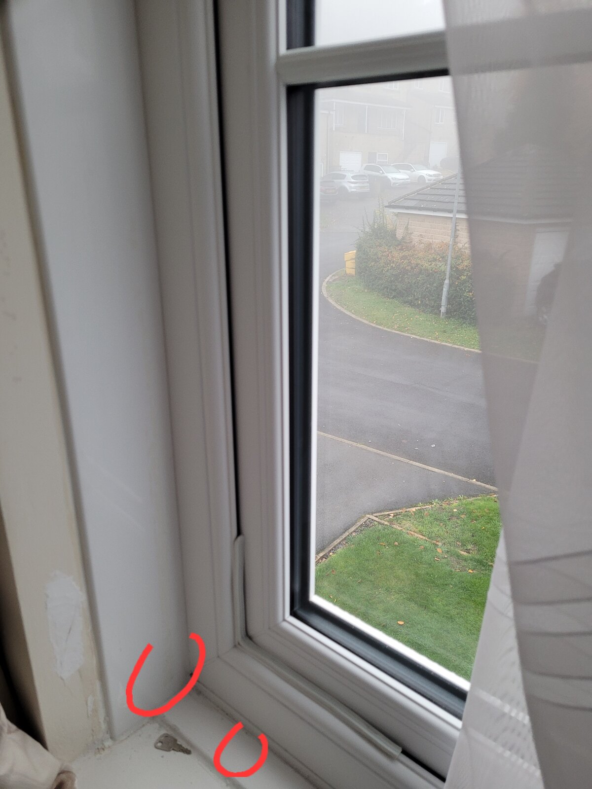

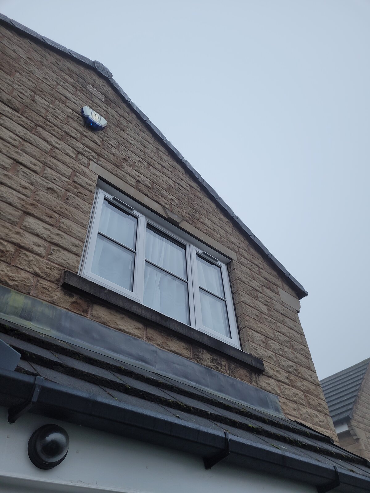

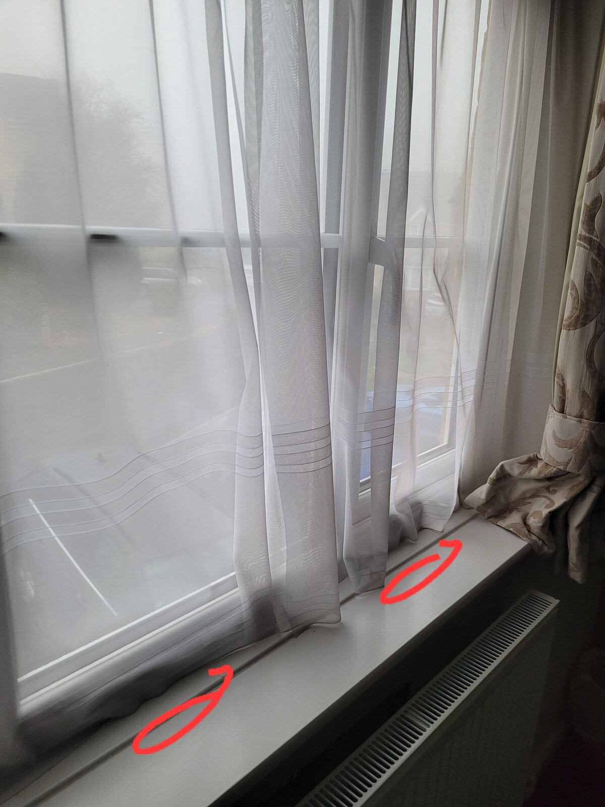

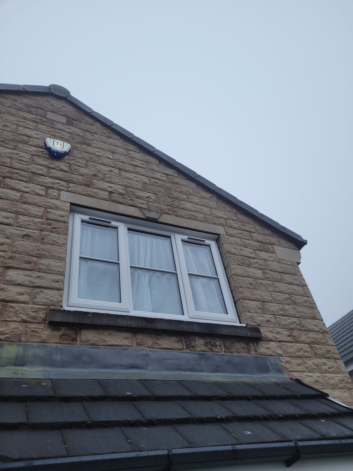

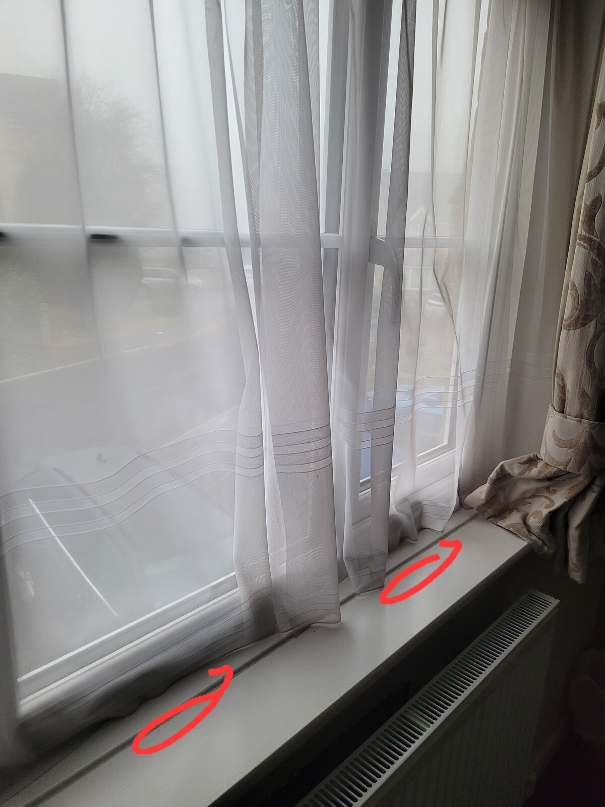

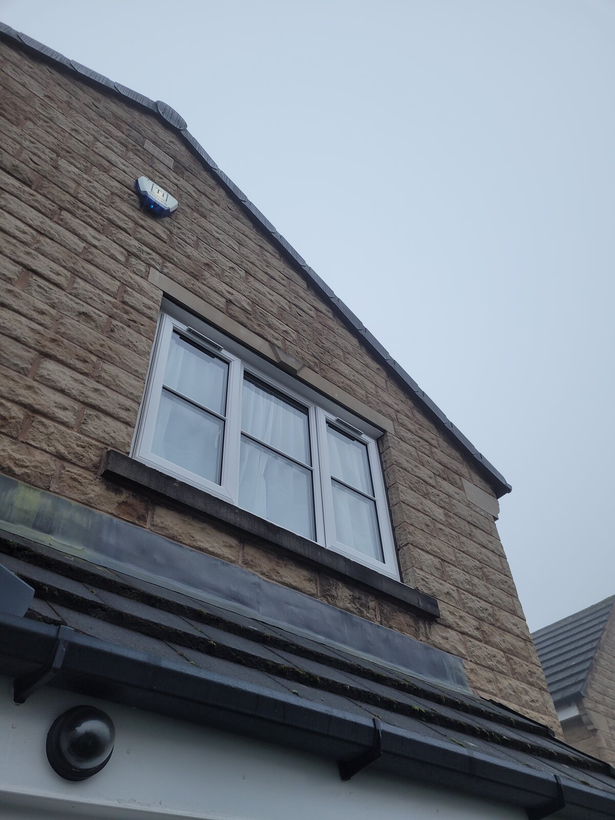

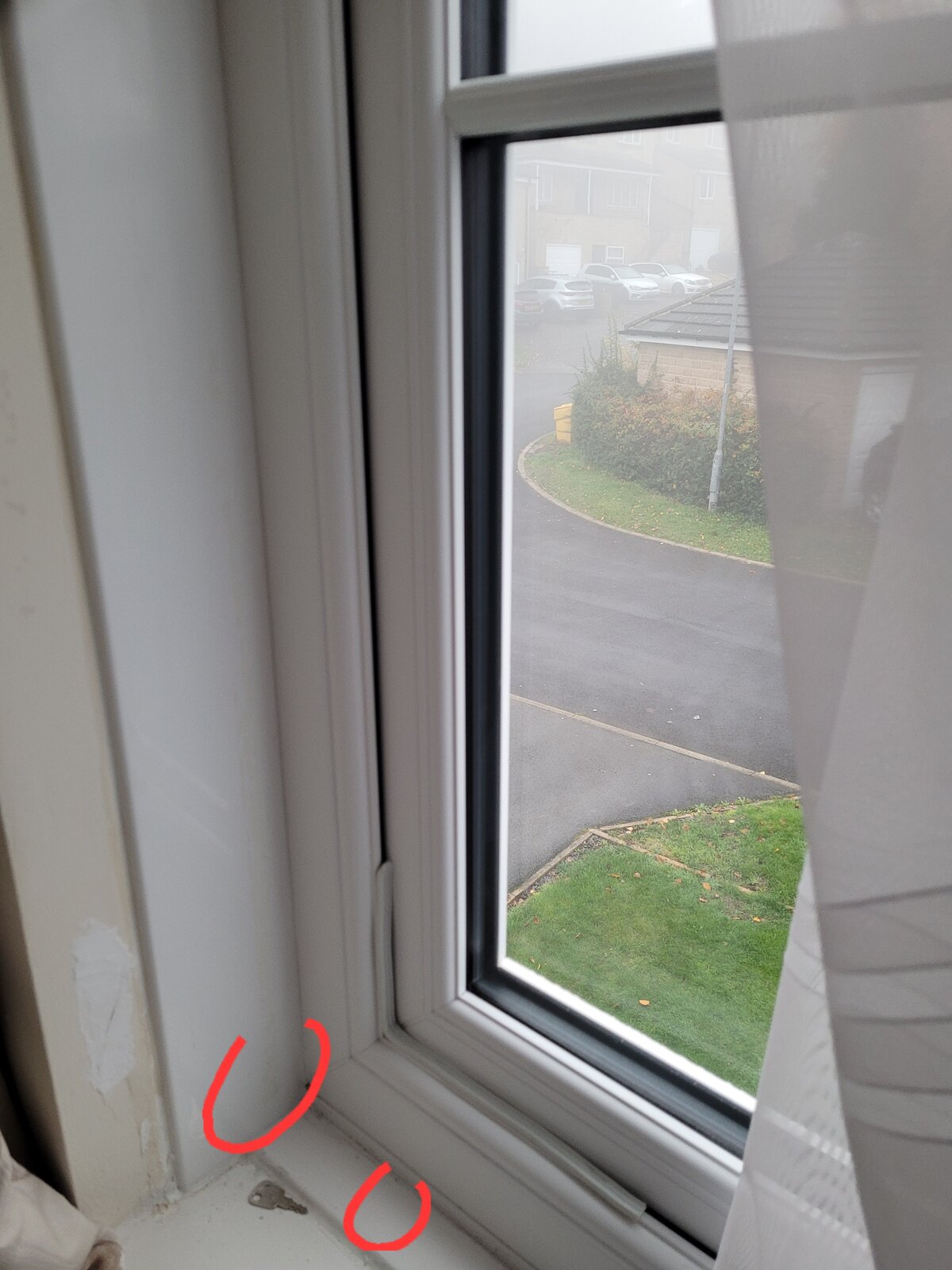

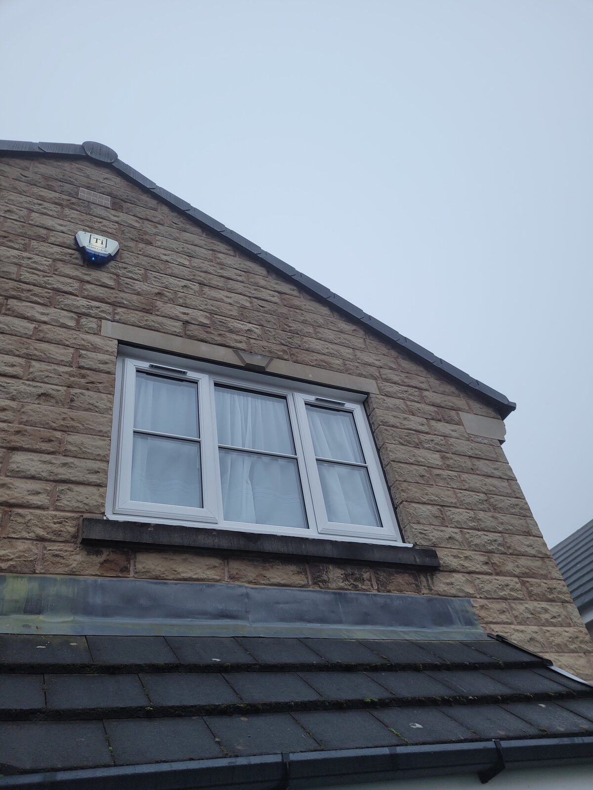

Images attached. Outside bedroom window. Inside 'red' marks indicate where its cold and feel draught, especially in corner. Is this what we likely feel when in room especially when on bed. I've spent a fair amount getting 3 windows done but this bedroom one is one we feel has more of draught. So is it because how it's now set without cavity closers and on outer leaf?
Should I get it replaced with cavity closer fitted?

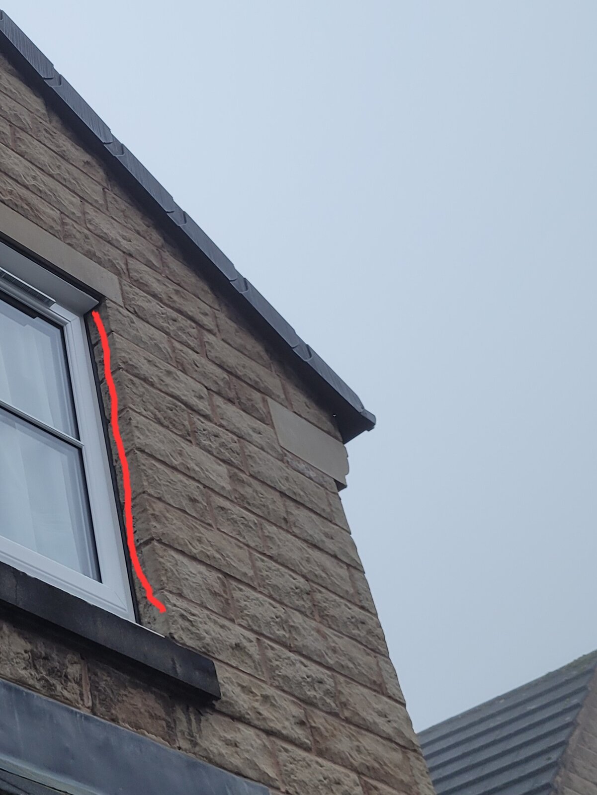

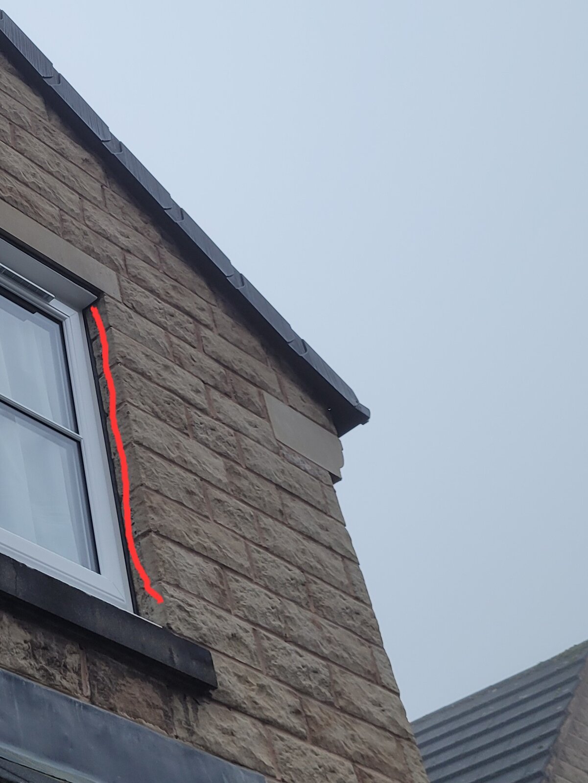

Just to highlight that the red line here shows where the window was when first fitter installed they had come further out and 2nd company took window back by couple of inches.

i would have expected the windows to be fitted in line with the end of the bricks/cavity , ideally situated just in the cavity , touching the back edge of the bricks ( not always possible I accept that ). On your second post with pics , how thick is that sealant on the outside? ( between window and brickwork)
As goes the draft , unusual to be drafty in the centre of a window , with the radiator there , it could well be Thermal convection you are feeling rather than a draft.
I do note on your second pic that the corner of the opening sash looks like it has something wedges in it?
If you have acces to a lighter or feather even , see how much they move where you think you have drafts

I think the original window was probably in the position you mention, but been moved twice now- perhaps it was in line with end of cavity?
Sealant on outside is fairly thick and there's no gaps around window frame.
As for the corner then that is a cold spot, always feel air there and on any slight wind a lighter, feather will flicker.
Guess option is to remove trims and see if there's anything that I can add to any missing insulation?
Last resort would be to re fit window but get cavity closer installed and hopefully window goes further back to cavity opening and tighter fit?
A quadrant trim may have been better down that edge rather than a thick sealant ( but sealed as well ) . I'm not a fan of thick sealant lines at all think it looks awful
Is the window closing properly though, as your picture shows something at the bottom of the window sash ...almost looks like foam draft excluder?
Are the trickle vents closed when you feel a draft?
Sealant looks good in that corner

Windows close properly and these are of high quality, can tell they're much better than the original and the lower quality used by first fitter.
I can get a quadrant fitted externally but not sure it'll solve the issue- still feel air is coming from under window/ left corner soon as temp drops or a slight breeze outside.
On the sash I put a small piece of draft strip as felt some air was passing through that part. I don't think it's the gasket or window seal but might just be due to that cold spot getting the better.
Trickle vents are closed. Not blocked up, they close over a plastic cover and dt thk these are reason for draught?? The window company did leave me some foam that is cut to place into trickle vent if required to block due to draught.
