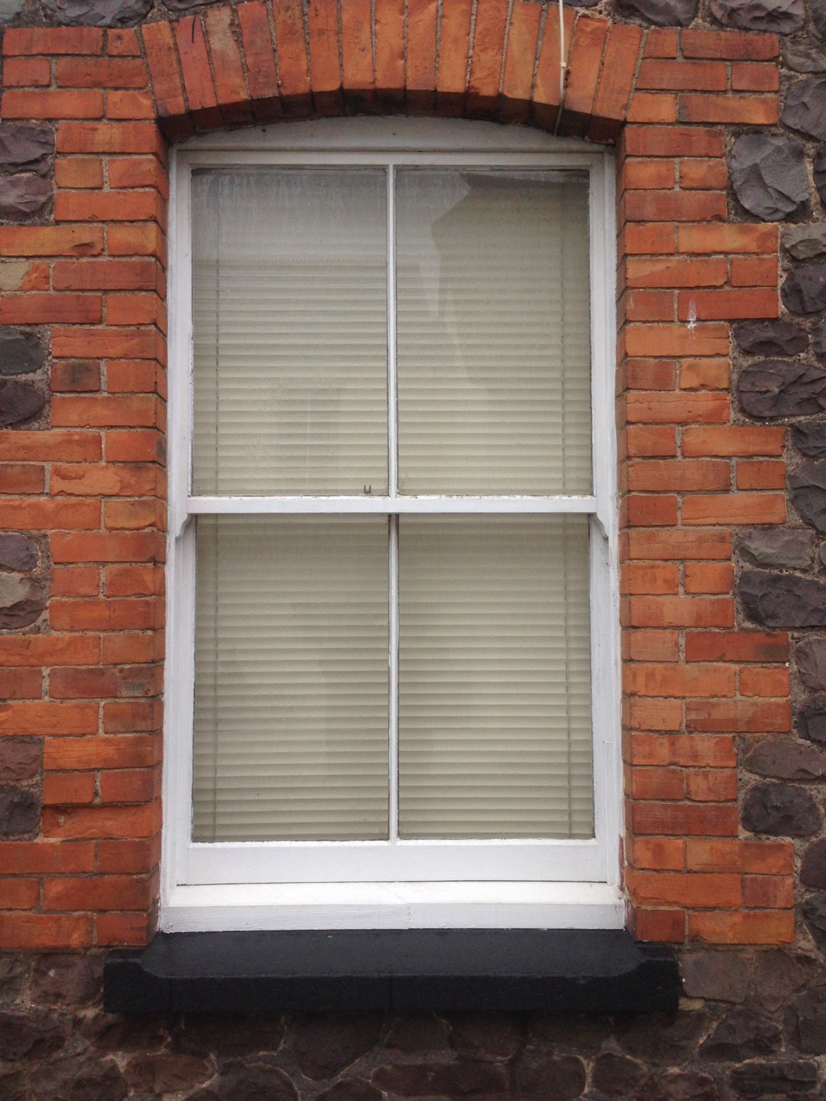

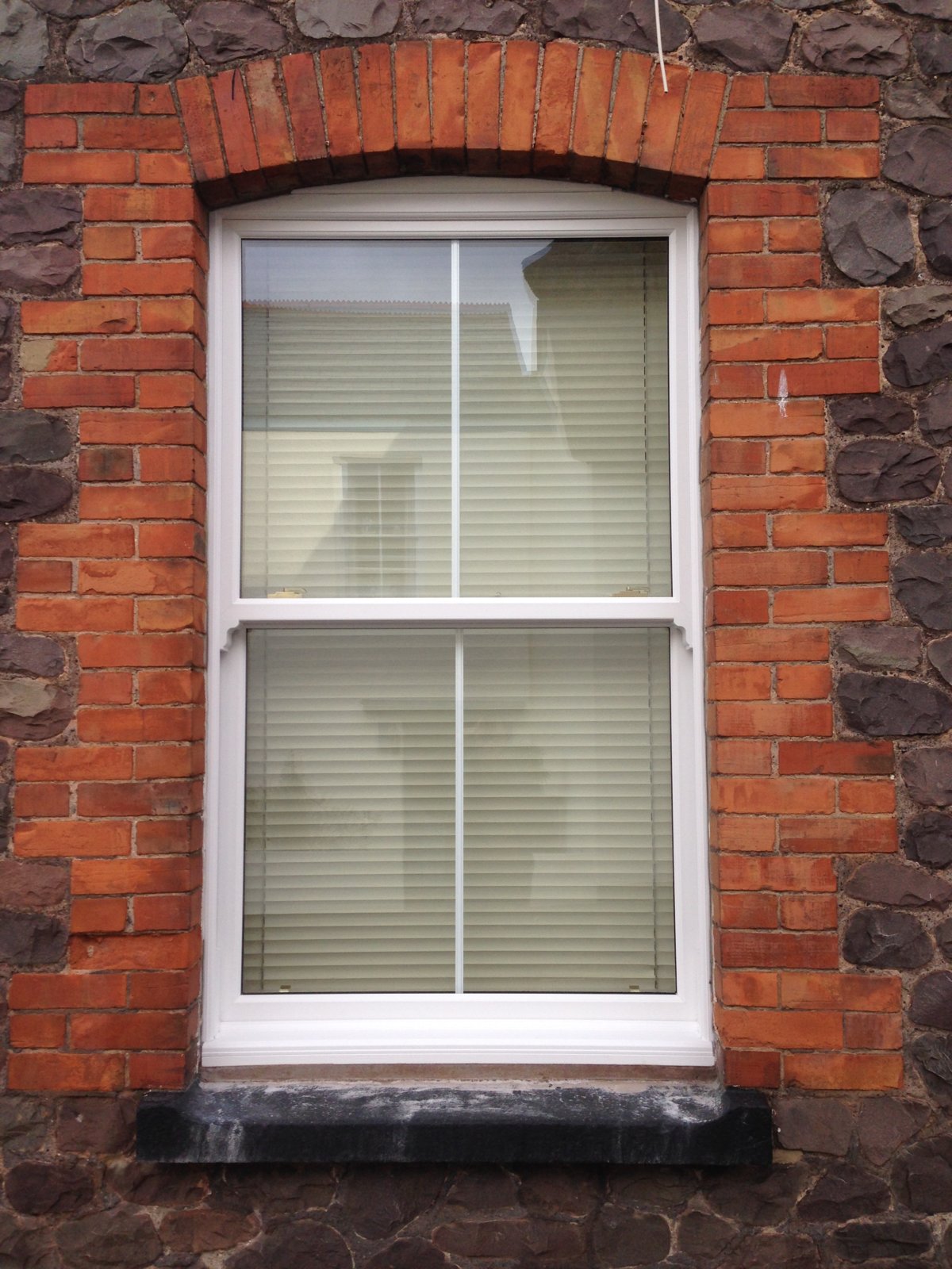

1. Cant recommend any manufactures for you personally, In my experience modern timber is rubbish full stop.
2. Builder can do it but you would need to get building control to sign it off and a builder wont generally give any fitting guarantees. Get some quotes from local double glazing company's as they "should" at least provide around a 10 year guarantee and be able to sign them off.
3. PVC! failing that hardwood. Softwood unlikely to last even 5 years.
I do think you should reconsider PVC you really can hardly tell the difference (except for being cheaper, Warmer, Maintenance & hassle free).
This is a few pics of a very basic one (cheapest options) before and after that I did recently.

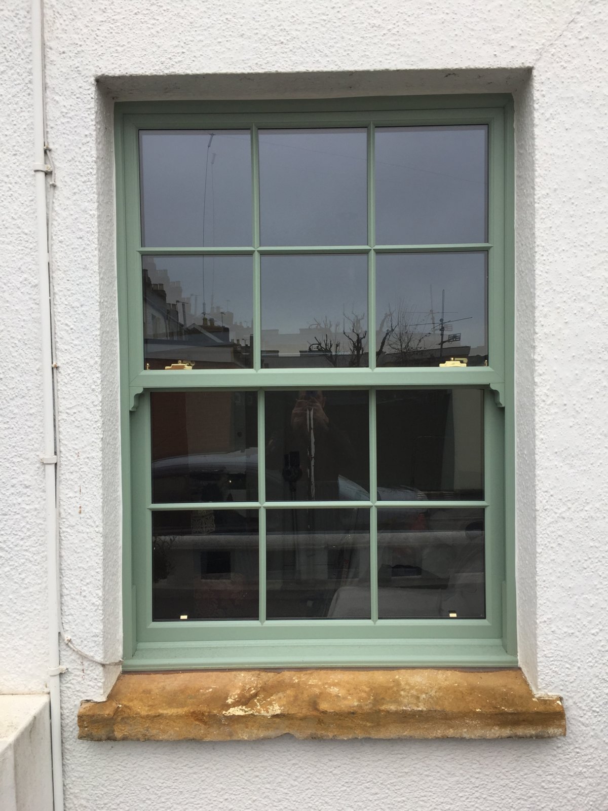

I would go R9 Or R7. This is a R9 we fitted a year ago.
[/URL][/IMG]
This is a R9 we fitted a while ago...sexy

Quickslide for your sliders I take it? Ive got one of their samples but didn't like the moldings or the Astragal miters on them so I have stuck with VS for standard sliders.
They are a bit of a pain with after-sales stuff but they do look much nicer in my opinion.

That is a synseal vs. We normally get ours from them and never been to bad. Just ordered 5 x rehau heritage which are due in 3weeks so we will see how they go. Was going to use roseview but easier to get them rom our existing supplier. The vs in the picture was fitted in the existing box that is why all the trims are on it. I was down your way last week for the weekend:)
