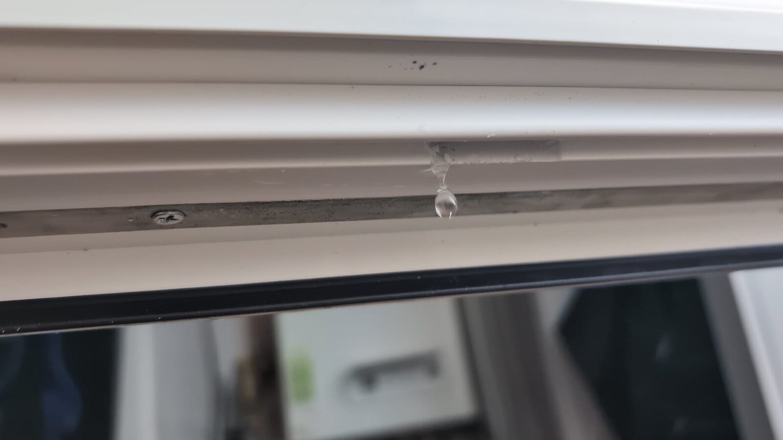

I got new uPVC tilt and turns installed and after the bit of rain we had this morning, there's still some water in the sash and frame. Can someone tell me if this is normal or going to be an issue?
Water seems to be collecting inside the sash and when I open the window, the momentum sloshing the water makes it come streaming out the weep hole and onto my floor. It was still dripping steadily by the time I got my phone and opened the camera app for a pic. The window sash is level and pretty big (1200 W x 1800 H) and there's only 2 weep holes, about a third of the way in from each corner. Is this unavoidable?

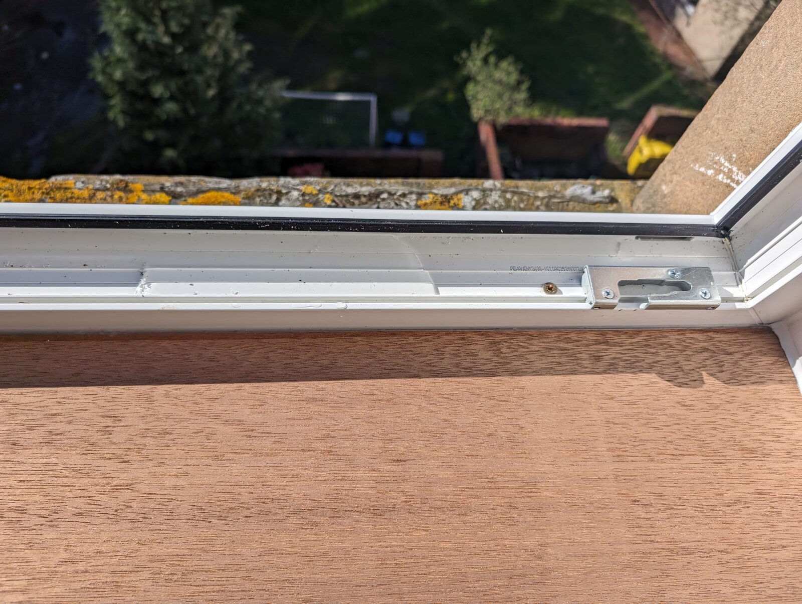

Water is also gathering in the frame. They've screwed the frame directly into the box, which I assume is normal, but wouldn't water just wick down the screw and eventually rot the window box?
My old windows had a raised lip in the middle to separate the water from the screws and keeps. These Rehau frames seem to have a tiny lip that isn't high enough to keep the water separated.
If its been fitted properly its presumably getting in through the weep hole, if by that you mean the closable vent. And from there to the framing screw which is a usual point of fixing. I think increasingly harsh and frequent driving rain is a factor.

By weep hole, I mean the drain hole in the bottom of the sash frame (the part that opens) to allow water out. When I open the window, water comes out onto my floor through that hole.
Driving rain is hitting the glass and getting into the sash from there presumably. The window is level so I'm guessing surface tension is holding some water in the middle of the sash and when you open it, the momentum makes the water travel outwards, towards the weep hole, draining onto my carpet. Don't know if anything can be done about that though due to the size.
The framing screws, I'm mainly concerned that water in the rain channel is going to wick down and eventually rot the window box as the screws aren't sealed with anything that I can see.

Maybe the weep holes are blocked or where they drain to is either by poor design or fitting.
the weep holes/slots in the sash are 600mm apart on centre. I think they're just spaced out too much and that allows enough water to collect and stream out when they get opened. I'll ask him to come back and put another hole in
