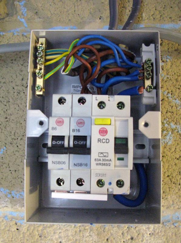

Hi Guys n Gals,
I'm new here so have a couple of questions. Basically I had an electrician come out to my house and he ran power out to a concrette workshop I built a couple of years ago. Anyway I had 3 x fluorescent 5ft strip lights installed and 8 double sockets all running from an RCD consumer unit. The main supply comes from the house but passes through another 14ft x 16ft concrette shed. So in my infinite wisdom I decided I wanted to wire this shed up I know that the sockets need to be ran on a ring so placed all cables in the roof space leaving plenty hanging down to work with. I also added lighting cable at the same time. However my problem is this.
Everytime I plug something in the consumer unit trips, this happens with the sockets and lights. I've looked on the diagram on this forums and the sockets are wired correctly, however I can't work it out. The lights I am completely lost over. I have a single metal clad and double metal clad light switch but nomatter what I try they keep tripping the RCD. I am a complete beginner so need help that I will understand because the diagram that came with it puts me right off and looks to complicated.
I better add that I cut the main supply in half and connected it to a small consumer unit in shed 1 which works because my workshop (shed 2) is live and lights/sockets all work.
Hope I've made sense..?
Thank you for any help any of you can offer, appreciated ;)

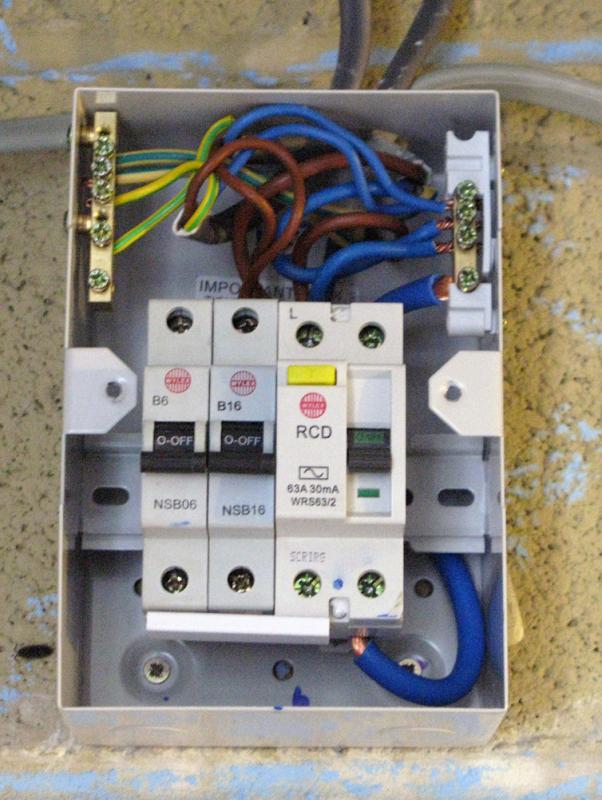

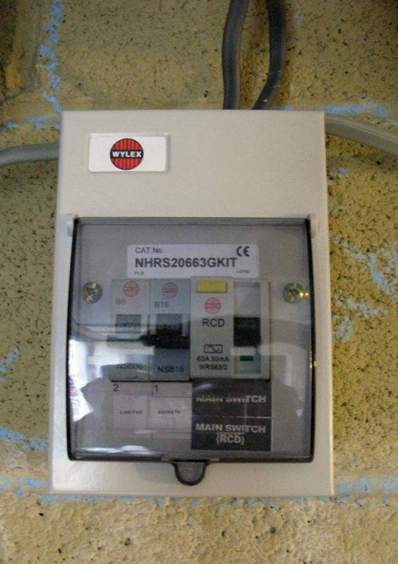

Here are some images to help in what I have installed. Hope this helps.
Let me know if anything is wrong, also the wiring in the conumer unit is messy but I would tidy it up one its corrct.
Some of the images are blurry but my camera is playing up :(
If you want any other pics let me now.
what wires are connected into the top of the RCD?
where are the incoming supply wires connected?
p.s. PLEASE isolate the supply to it NOW :!:
Wires going into the RCD is brown which is coming from the main supply, blue is running into brass block which then has a factory fitted blue running to the bottom of the RCD and into the same brass block. Grey cable which is 12mm coming from left and right of the consumer unit is main power supply.
Other wires in the unit are sockets and lights I un-wired so are outside the unit.
When you sau isolate what do you mean...? I think I answered all your questions, if not I'll post or edit this post.
You say you have the supply brown going into the top of the RCD, and the supply blue going into the Neutral block?
That's wrong and can never work.
Both supply wires go into the top of the RCD. Nothing else goes into the top of the RCD.
In your pic it looks like you also have some other browns going into the top of the RCD, which is also wrong
Here I have marked out more or less the diagram for you to see. Hope this helps.
What you've done is wrong and will not work. I suggest you get an electrician to do the work properly.
