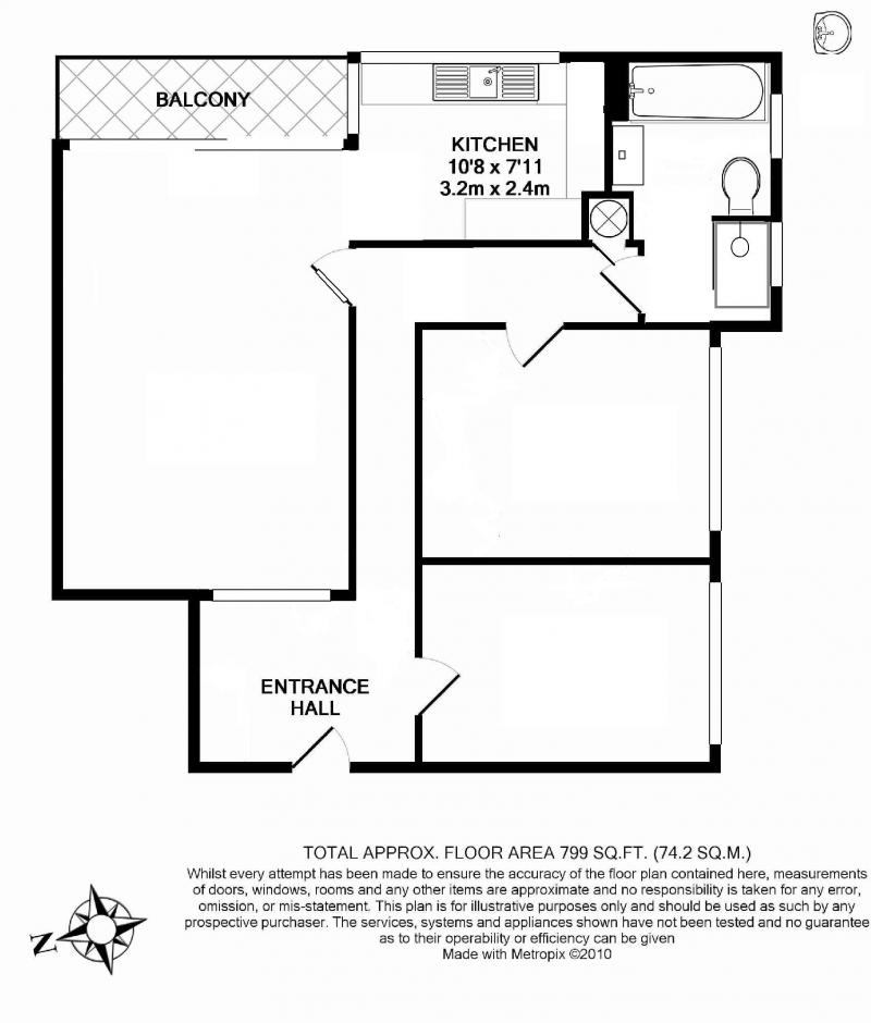

Newbie asking "Is this possible ?"
You have wasted space in the corridor to the bathroom.
Could you fit a WC in the hall (macerator if need be), change the corridor to a shower room off the lounge, and put a door from the bedroom to the bathroom to give you a master en-suite?
Moving part of the hall wall to give you a doorway to Bed 1 would ease access issues too.
I can't draw doors very well but they're the white rectangles in the wall - I've cut away part of the hall wall to put a new wall with door on the diagonal.

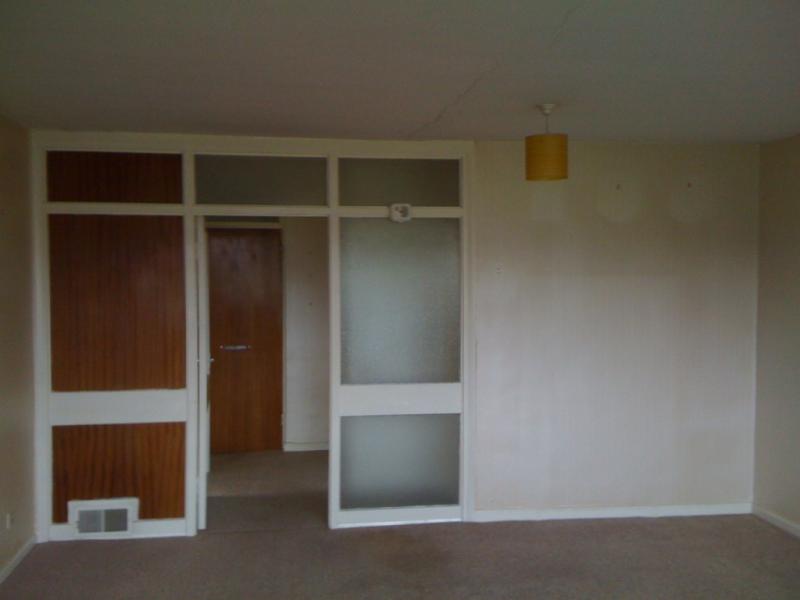

What do you think of this layout, this is what I originally sketched as I liked the idea of a hall way anyway as I would be wanting to rent the second bedroom out and it just makes it nicer for everyone not to have to come through the living room and also means I can get a sofa bed and have guests without having to disturb.....
I'd have to use some clever lighting in the hallway but have allowed for a glazed door to the living room and keeping the high level glazing that currently exists in the wall between the living room and the hallway.
As always, LET ME HAVE IT!! :)
Unfortunately you end up with a smaller lounge and more wasted corridor space.
With my scheme both bedrooms and lounge have access to the WC in the hall. Bedroom 2 has to go through the lounge to shower, but that won't usually be in the middle of the night so less disturbing to someone on the sofabed.
How big is the hall - it might actually be possible to put a teeny shower room where I have indicated WC. That avoids all the walking through rooms, and would give you a walk-in storage cupboard where I have indicated Shower next to the kitchen.

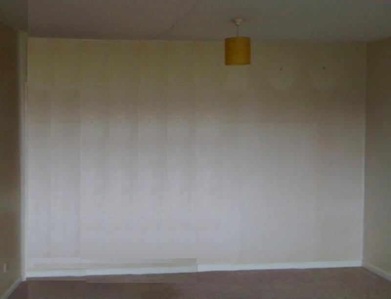

With the wonders of MS Paint this is the efect on the lounge!
to this (without glazing)
If I was doing it as an investment Owain I think I would go your route but as it's for me there's a couple of issues:
1) I don't like the idea of a shower room of the living room.
2) I've had such bad experiences with SaniFlo sanitaryware in the past I don't think I could bring myself to install anything similar!
It is technically wasted space the hallway but with the benefits it brings I'm still erring that way......
Thanks so much for your time Owain, much appreciated.
Does this give you an indication of the space?
These are not exact measurements as it was just me with my measuring tape!
I've allowed 1m for the width of the hallway to match the one there already.

Instead of 'wasting' space in the lounge building a corridor, why not section the lounge off at the bottom instead? It will use less space and will allow you to use the space for something useful, like a shower room. You could then move the bed 1 door to be within the new entrance hallway, which means both bedrooms have access to the shower room without going via the lounge (great if you are renting a room out) and both have a much better fire escape route.
Something like this?
Taking it a step further, you could then make the main bathroom an ensuite from Bedroom 1, which means you could lose the now pointless corridor to the bathroom and have a bigger kitchen with a more open plan feel. Like this
Of course I have no idea whether the current building structure and pipe layout/access would allow this!
Just my thoughts :)

3.7m wide after the hallway is taken away is respectable, but it will seem longer and narrower than current.
Owain: It sure will, but I was always planning to create a natural walkway behind a sofa with the TV on the west hand wall anyway, so I'm only really losing that space really although it will feel and look smaller with a physical stud wall there.
Leccy: Your plans are good and if I didn't have a hatred of saniflow or if there were pipes anywhere near the space I might go for that approach.
I want o conform to building regs (unlike other flat owners in the block!!) so I need to do something. And if I have to do something I like the idea of creating a separate walk way through the apartment that allows the lounge to be a 'private' room that doesn't require walking through everytime someone wants to go to the bathroom!!

That's my boy! Much better, not just from a safety aspect but practically and for a good resale too. This is the layout to go with, ignore the other posters layout advice. :mrgreen:
