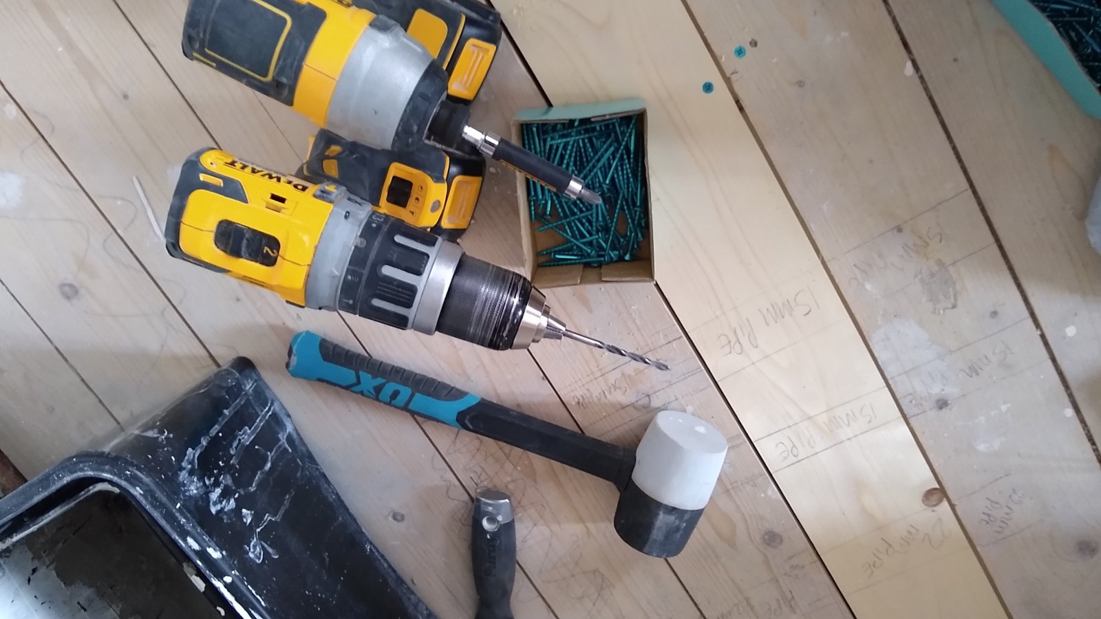

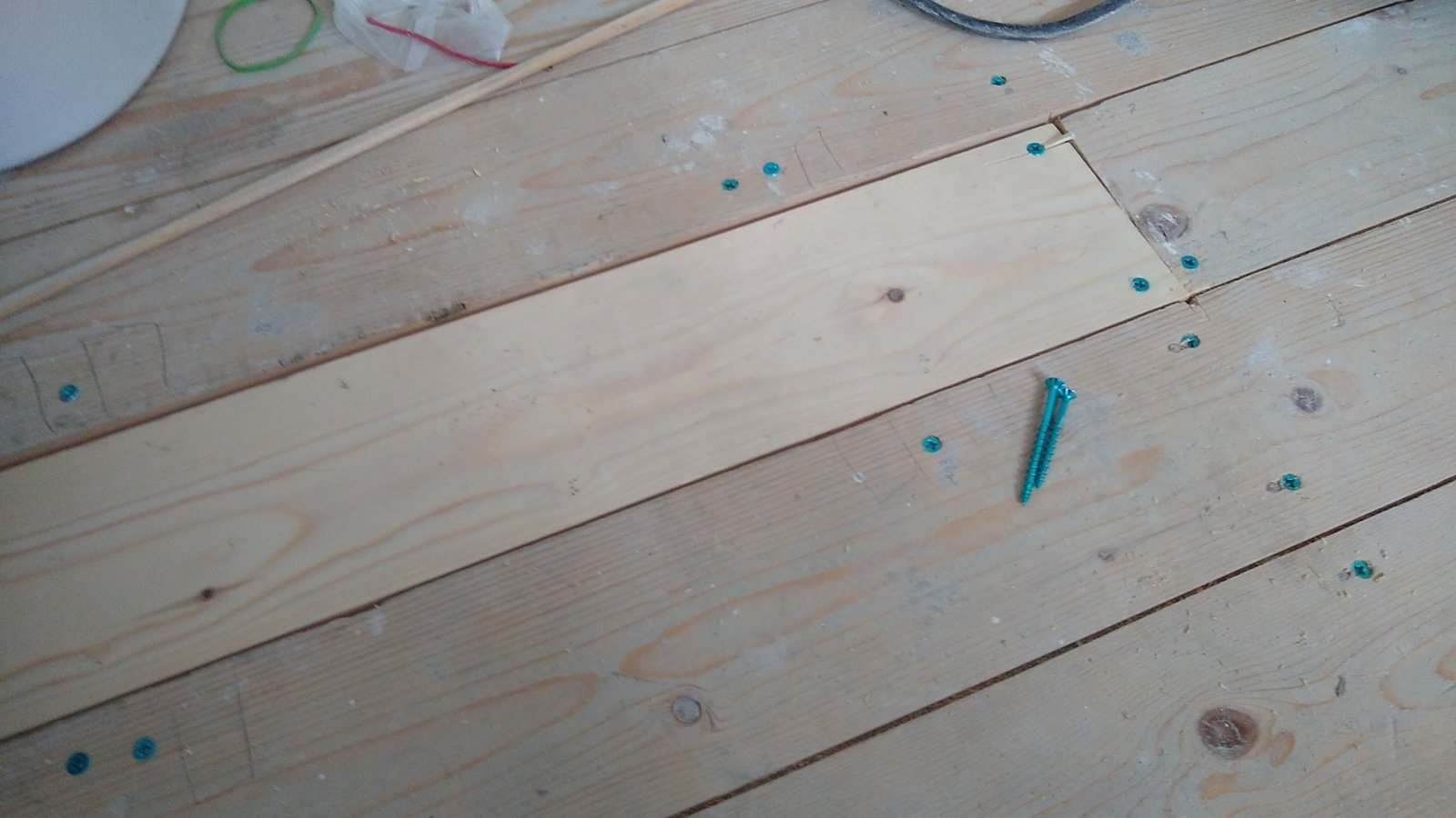

Well chuffed!
The replacement 18mm tongue and groove floorboard slotted in perfectly with the existing floorboard :D:D
I NEVER, EVER use MDF in a flooring situation. Plywood, hardwood and softwood can all be used as packers - MDF beneath a floor is likely to act like cardboard and simply wick up.any and all moisture, which is far from ideal. Also, like OSB and chipboard when used for packers it is hardly the strongest of materials.

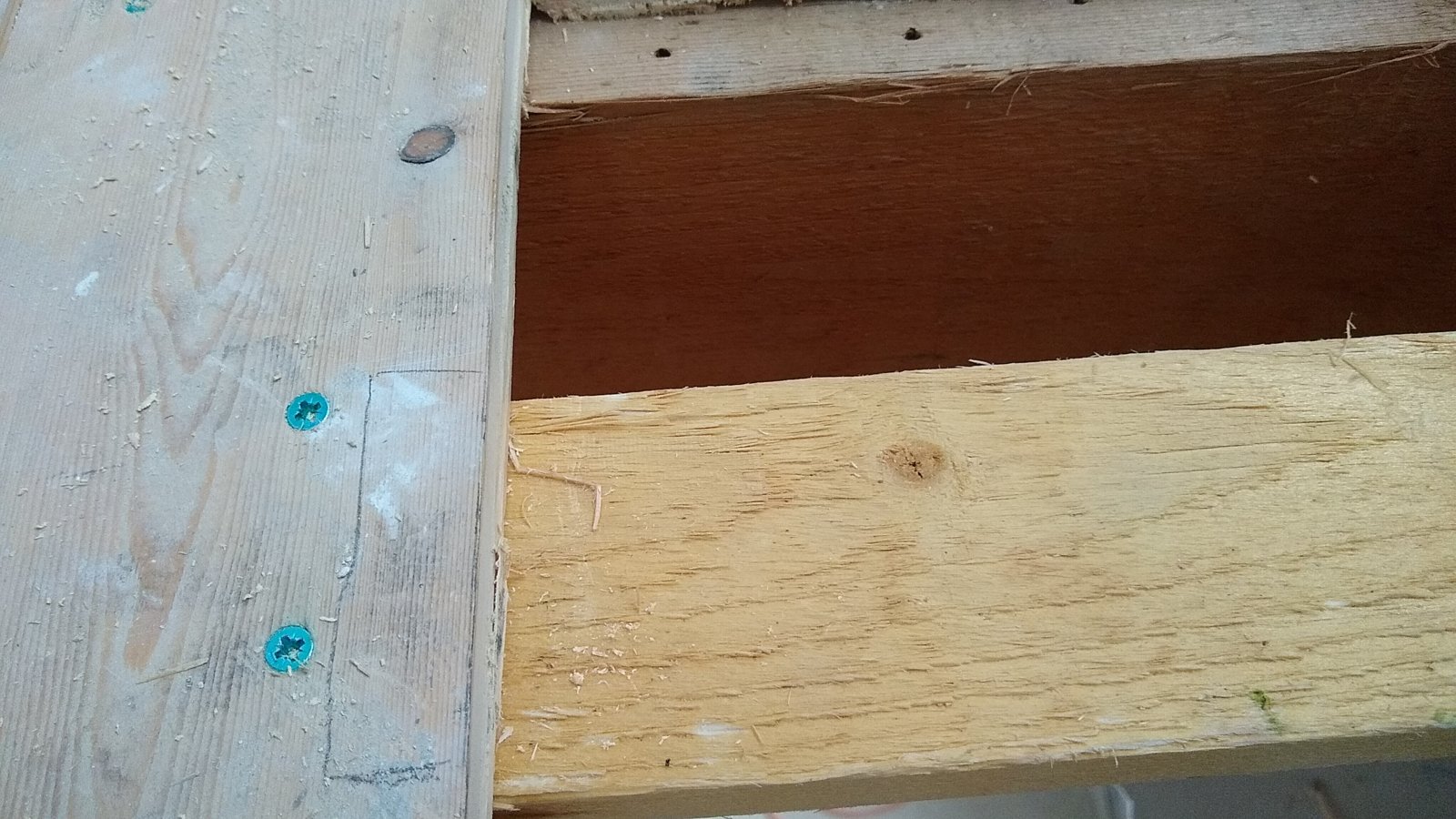

I screwed some scrap wood (from a pallet) underneath the floorboards for extra support
On first look, it seems like a decent job
And most importantly, no squeaks ;)
