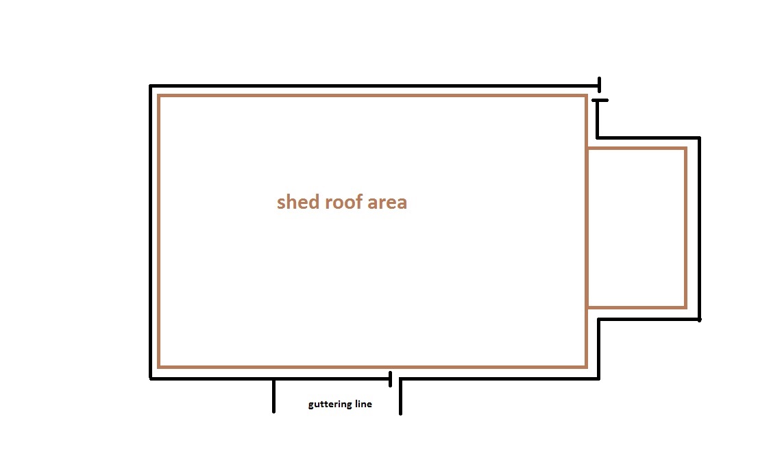

Thanks a lot, any advice on this plan I have to run guttering from the whole perimeter of my shed as per photo?

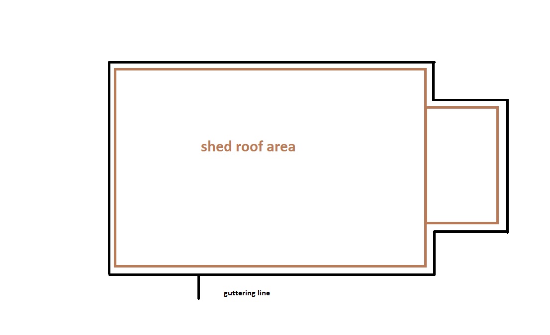

I'll start with the downpipe because it's the low point. I'm hoping this is right.

Downpipe terminate in an open water tank used to store the rainwater.
Is there any chance of having two running outlets and two water butts? That's a pretty tortuous route for guttering - trying to give it enough fall from the highest point without water remaining in it for ages! This in itself isn't an issue but there will be leaf blockages and overflows etc which could cause some rot over the years.
Regarding fall, the ideal is for the water to drain but take the solids with it, rather than water to shoot by leaving the solids behind. By solids I mean vegetation or debris from the roof covering or whatever.

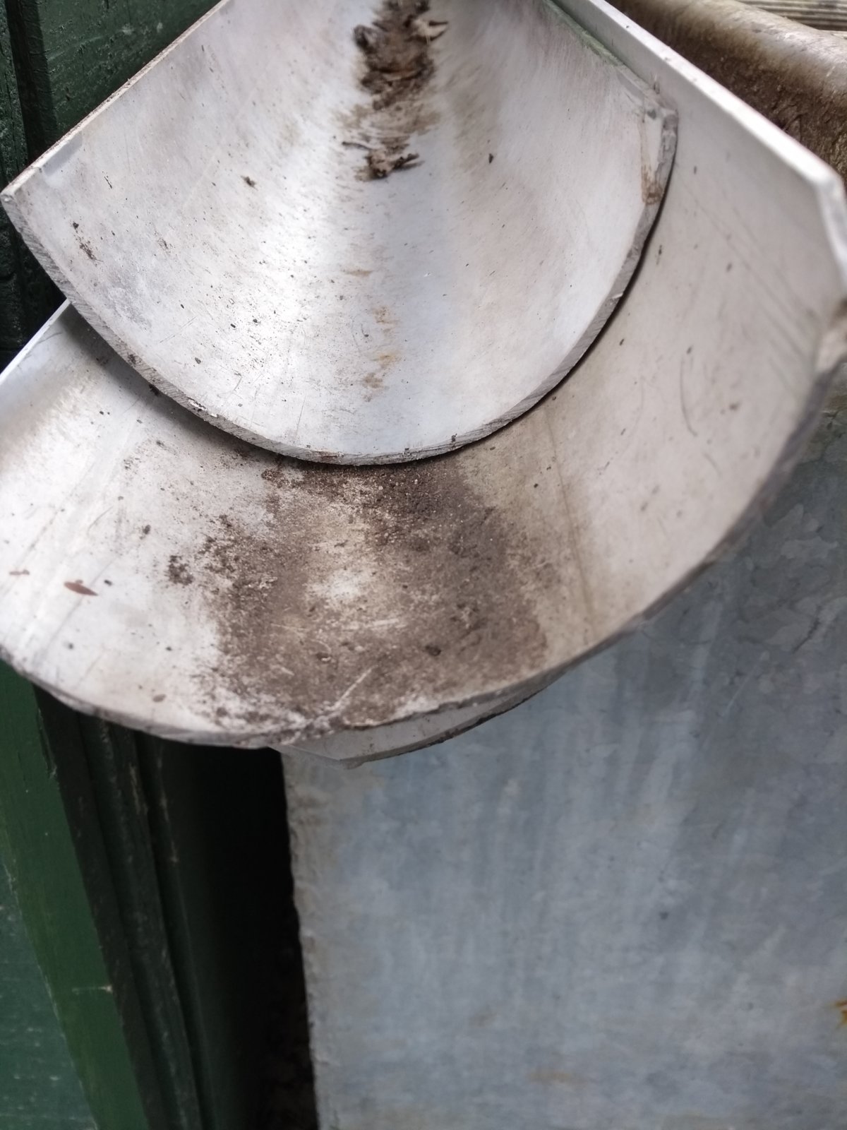

I'd also check if the old guttering is compatible with the proposed new brackets....some types seem to need notching to fit.

Burner, it's a flat roof. I've run it all the way around to capture as much rainfall as possible but now you've highlighted this point perhaps I should find which way the slope runs and just fit guttering there instead? Which is I'm assuming what you're suggesting should be done? Is there no benefit to fitting it everywhere to capture drips from the fascia?
For sure, there should be some fall on the roof, albeit slight.
That’s where you want the guttering, there’s no real point in putting it all the way round and as for the facias, just keep them protected with stain or whatever.

AFAIK the only gutter that needed notching was Marley 4" back in the 70/80's p*xy stuff - and it's brackets are smaller than new gutter, but they'll be knackered now anyway.

Here's a photo of the guttering I want to use.
Will this work with any/all fittings purchased from toolstation/screwfix?
As mentioned, I don't want to purchase the fittings to find the guttering is at odds with them.
