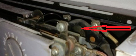

I can't help with the Creda but this is what it looked like in another:
A black thing with a round convex bulge which should be concave (I think that's right) just needs to be pushed the other way, my tenant had managed to trip all 3 heaters. Make sure the power is off when you do anything as there are plenty of exposed live terminals in the area.
