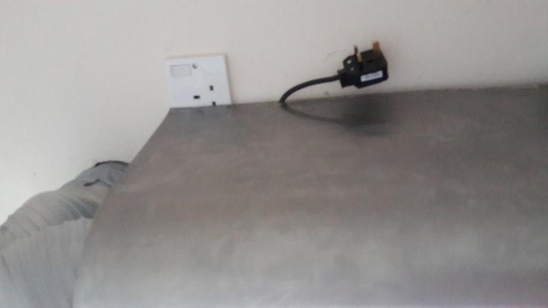

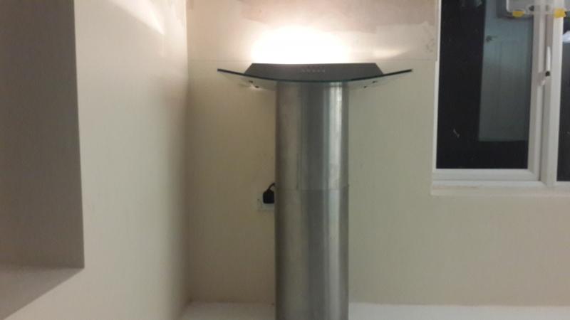

what I have tried to do : there are two parts to the chimney, one that slides in to the other, the first part I fixed flush to the ceiling (before it came crashing down last night) as it has a bracket that fixes it into the wall, the second part i'm assuming slides up under it then the main fan itself hooks into the bracket i have fitted on to the wall then the vent flexi pipe attaches in to the fan.
I suppose my question is how on earth do i hook the fan part whilst simultaneously feeding the power cable through the pre cut hole in the lower chimney section, attaching the flexi pipe and also slide the chimney part in place?

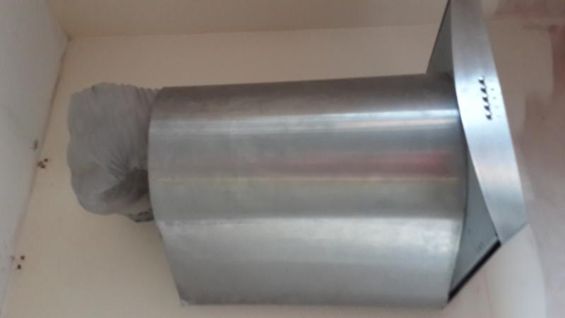

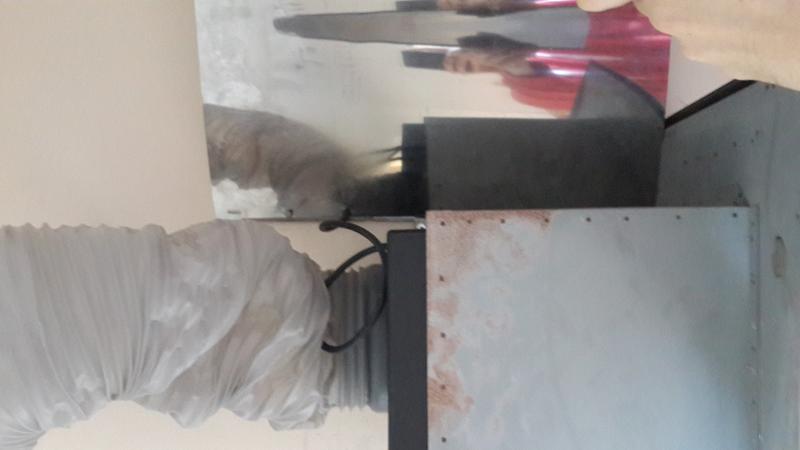

Not quite sure why you are having a problem. The bracket needs to be fixed firmly to the wall at the top and the main fan unit also fixed to the wall. Then connect the duct from the fan to the outlet. Assemble the chimney and stand it on the fan unit so the top piece can be slid up and fixed to the top bracket on either side (usually small self-tappers or similar).
The bottom section of the chimney can be slid up to retrieve and locate the power lead if necessary.
Job done.

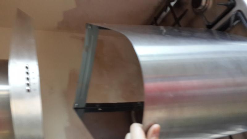

As kbdiy says,
You need to actually remove that bracket from the curved hood you are holding, and fix that to the wall.
Slide the two pieces in place, ensure the ducting and cable are routed ok not pinched.
Lift up hood sit in place on extractor. Ensure the holes in the side of the hood line up with the bracket and screw them in.

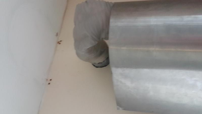

Just a note : looking at the pic, the round ducting looks a bit baggy in places im not sure why, im concerned as it wont promote the best airflow exiting if it's expanding too much between the coils, anyway wack it up and rejoice with a beer.
