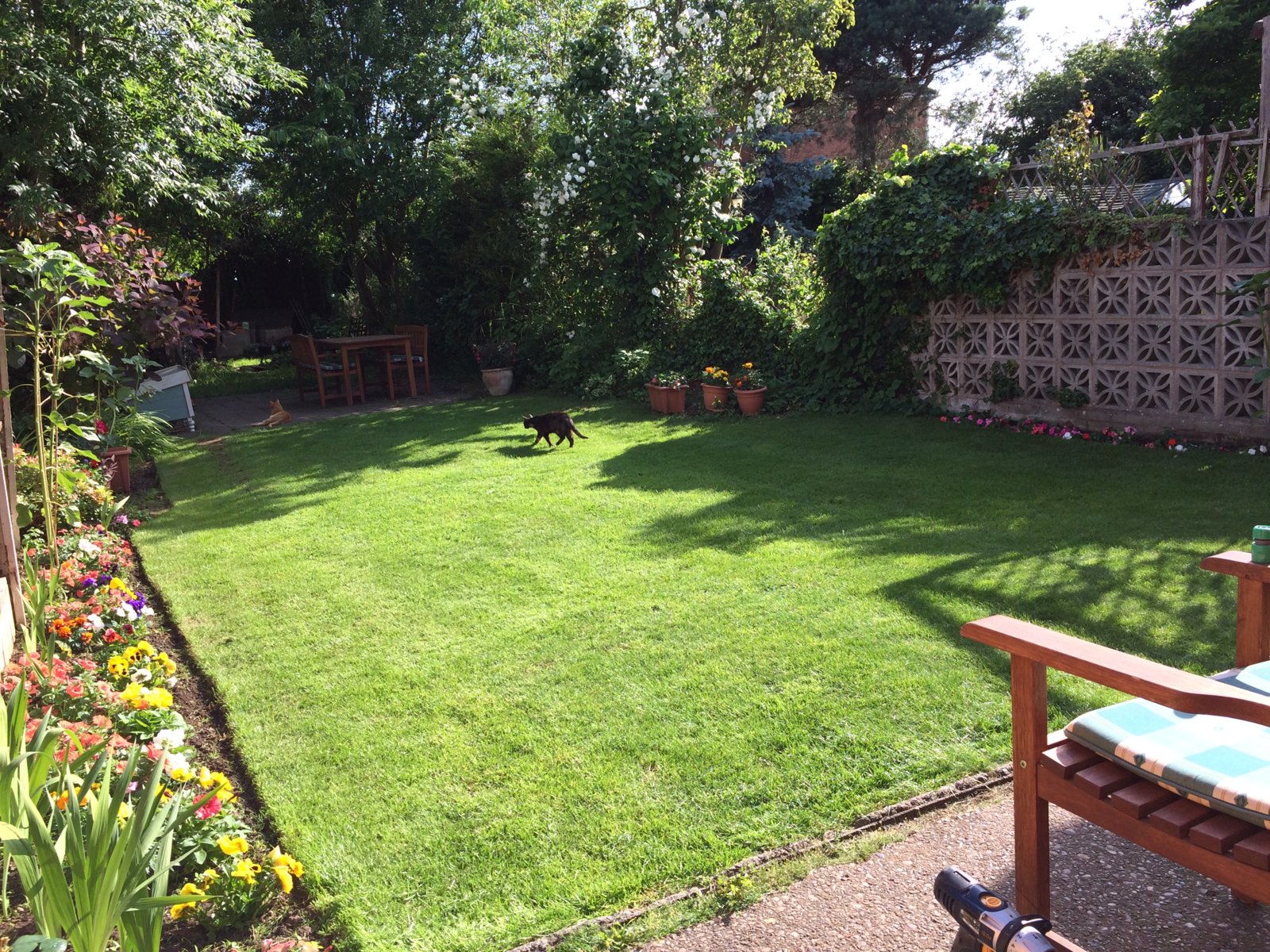

Last summer my lawn - although uneven - was something I was fairly proud of. I'd fertilised it, laid a few new rolls of turf to the left and got rid of the moss and weeds. It looked like this:

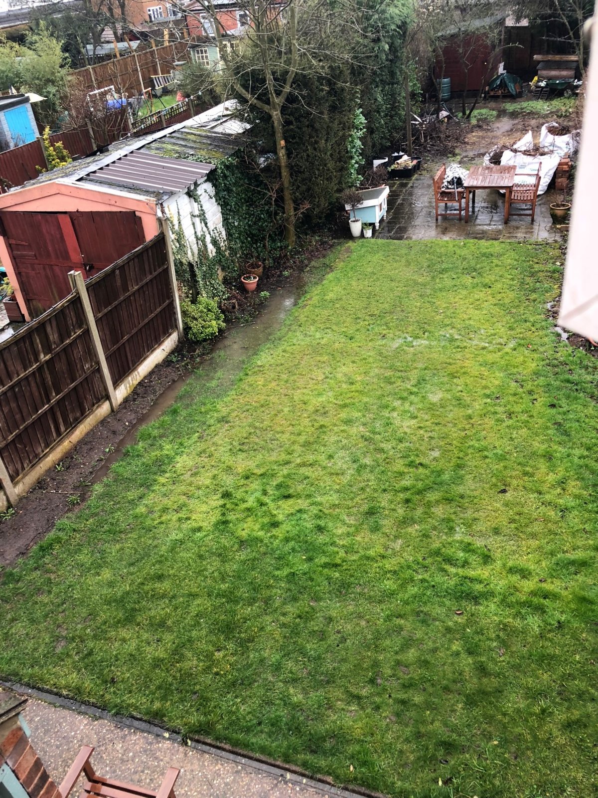

This snow and rain this year though has taken a very bad toll. The new turf on the left was given to me free and I clearly didn't raise that side high enough when laying it. We also have soil which is full of clay and this obviously hinders drainage. As well as the slope towards the left, there are several pits in it about 3 or 4 inches deep (around the yellow areas). It now looks like this (excuse the mess, the garden is this spring's job):
So how can I level the lawn out? Can I cut out the dipped sections, fill will soil and then re-cover with turf? As for the new section which has flooded on the left, I will re-lay this - just don't want to be re-doing the whole lawn as I know it can look good!
Thank you.
You may find you can still lift the turfs that have sunk, add some more soil, and then rebed them. And if you have to do this, then it might be a good idea to put in a french drain at the same time.
Take a look at the paving expert, but beware of the caveat at the bottom of the page.
Thanks for this - that website is a great resourse. The piping seems to be quite cheap which has surprised me if I'm honest. Once I've lifted the sunken areas in April-time I'll look at what I'd need to do to run a few trenches down the lawn. I had used a fork earlier in the year but I think this just compacted the soil even more.
The soil is so full of clay in areas it's possible to re-create that scene from Ghost.
Clay keeps the moisture in the soil, and if the area doesn't dry out, then that helps moss grow. Putting holes in the ground is supposed to help aerate the soil to reduce it, so shouldn't have caused a problem. Don't wish to sound negative, but with that much clay, would it be sensible to either rotovate the soil, or dig in some roughage to help the clay areas.
We are going to get hotter summers, and may even get colder winters, so getting the ground done properly may help the grass survive better, than doing remedial pipe work that is remedial, rather than getting to the heart of the problem.
I agree - we had nearly a foot of snow a couple of weeks ago which lingered for a week keeping the ground very wet as it melted. Subsequent rain has also topped up the water levels. I think using the fork just compacted the soil around it - I've been told I should have used one with hollow tubes to actually remove soil.
I'm going to raise the sunken areas as you suggest, bring the left-hand side up to level, use an aerator and fill the holes with fine sand. I'll also look at French drains.
If the same happens next year then digging in some better soil and raising the lawn up may be the only option - I dread the thought of the work though! Although flood defenses put up 70 years ago have stopped flooding in the area, the ground can get saturated in heavy rain. After all we are on a flood plain within 2 miles of 4 rivers (Soar, Derwent, Erewash and Trent).

If you're on a flood plain CW, then you may be faceing an uphill battle, as the water level in the ground may be having a certain affect on the lawn. I hadn't heard about the iron in lawn sand, but you can get washed sand for plastering and for block laying as well. As to the squelching going down to the shed, sounds as though some blocks in the lawn might be a good idea.
Keep us updated on this one.
Thanks both. TicTac - yes on a flood plain but I think the real problem is the layer of clay acting like a skin on top of the earth. I forgot to mention, but below the clay/soil (around a foot down) is a layer of sand so it's just about getting through the clay I think. British Gypsum operate a quarry (or used to) 2 miles away near the A50 purely because of the sand found easily around here.
Stephen - thanks for the links I'll have a look when I'm back home. As long as I can get the water to drain into that layer of sand I think I'll be okay. If I level the area on the left that will raise the lawn 6" that side so I shouldn't see the pooling water. After that I'll go with the best way I can find to aerate it. I've since found out the local wood yard sell sand and do the horticultural stuff at £4.50 a bag so I'll grab a couple.
I'll update this thread next month when I start work. Weather dependent of course as we're forecast 8 degrees today and -2 on Saturday...!
I'm not an expert and I have never had to deal with this myself, but just raising that area on top of the existing clay sounds like, rather than draining away, the water will just fill up that top 6" until it has reached capacity and then start pooling on the surface.
What I think you need to do is to make that clay layer more permeable. So when the turfs have been removed did a load of sand / organic matter into the clay.
Maybe you have that in mind and I did not pick it up. I just wanted to be sure.
Sorry yes that is part of the plan.
As I say, there is sand below the clay - it's the same at the house I grew up in about 1/2 a mile away. If I can allow water to pass through the clay and into the sand and then raise with top soil I can't imagine I'd see pooling water again.
