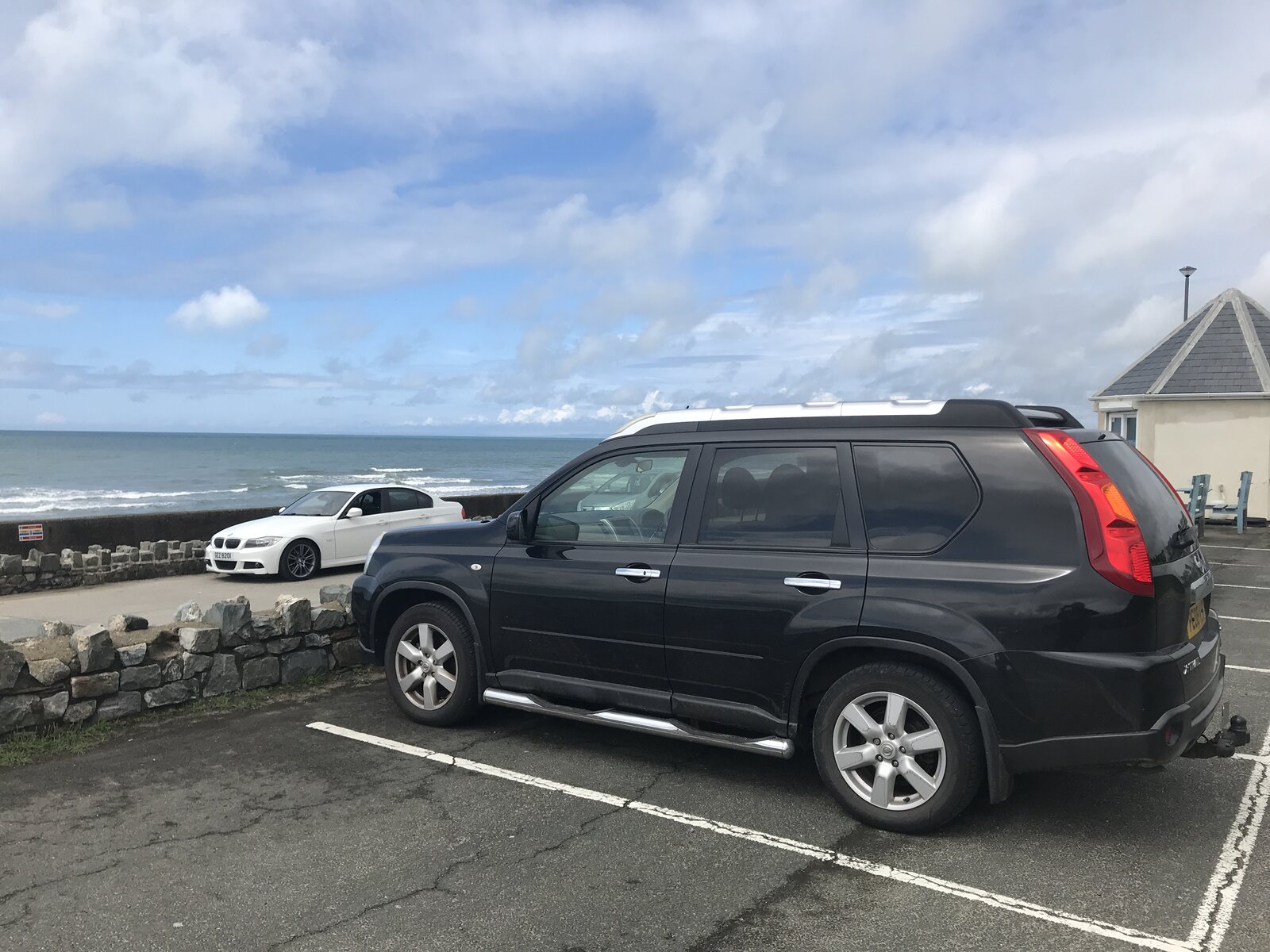

The Warranty appears to be very flexible , they said it was 6 months, but like most warranties there’s lots of wriggle room to get out of them
at least the Cars running very well , hopefully for a good while, the Cars a keeper , it’s an 08 Plate with 91k on the clock very nice condition, I’d lose money on it , so it’s going to be here for a good while
