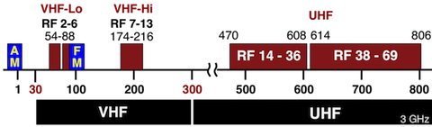

In your friend's case there are a couple of things that don't quite add up. The wall plate is a filter. A mixed radio and TV signal goes in, and then the frequencies are split into the TV and the FM bands. These are quite separate from each other.
FM is 88 to 108 MHz. The UHF TV bands don't start until 470MHz. That's a big gap to bridge, so even if the (VHF) FM aerial is picking up UHF signals, I'm left wondering how they make it through all the filtering and combining/decombining stages so that his TV picks up signals from the FM radio socket.

Running two wires to each aerial point is a colossal PITA. How it's done properly is to have a device that combines the two aerial signals in to one. This is called a diplexer. They take various different forms: For example, sometimes it's a box up on the aerial mast. Other times it might be the aerial distribution amp itself which has an input for UHF (the TV aerial) and one for VHF which is the radio aerial. However it's done, the result is the same; the FM and the TV signal go down the same cable(s) to the various TV points.
The wall plate with the splitter is more of a convenience thing, but it does help reduce the risk of crosstalk between the FM and TV signals. It shouldn't really be an issue, but the FM aerials will pick up TV signals, albeit very weakly. TV aerials will also pick up FM, again, at weaker strengths than TV reception, but some TV aerials will tolerably well as an FM aerial particularly if the FM and TV transmissions come from roughly the same direction. Combining two aerial signals where they're both picking up the same transmissions can result in some odd effects. Certain signals can be reduced. That's called destructive interference. To get around this problem, the diplexer responsible for combining the signals should have adequate filtering to isolate the VHF and the UHF ranges. However, we can't rule out the possibility that something isn't quite right at the head-end or in the signal cable run down to each room, so having the filtering at the wall plate does make sense.
