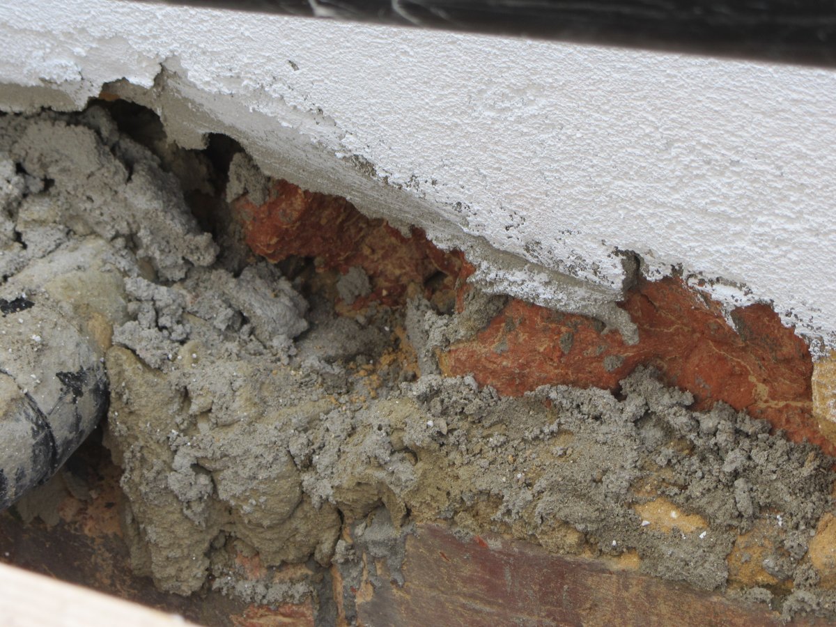

our house is a detached house two storey house with render on the top half and brick on the bottom. There is a brick decorative ledge separating the two floors it sticks out about an inch. The render has been taken to the brick ledge but no bellcast put in , this means that the rain water will run down onto the brick ledge and either pool there or soak into the brick ledge. There are small gaps between the render and the brick ledge, I imagine that the water will run into them and then soak up into the render behind the paint, causing problems in the future. I am wondering if I am worrying too much, or if I am right to worry, then how can this fault be remedied. I am due to sign off the job in the next few days and I am being told that this situation is ok, but I don't think it is. Sorry no pics but if they are needed I can get some. Thanks for any replies

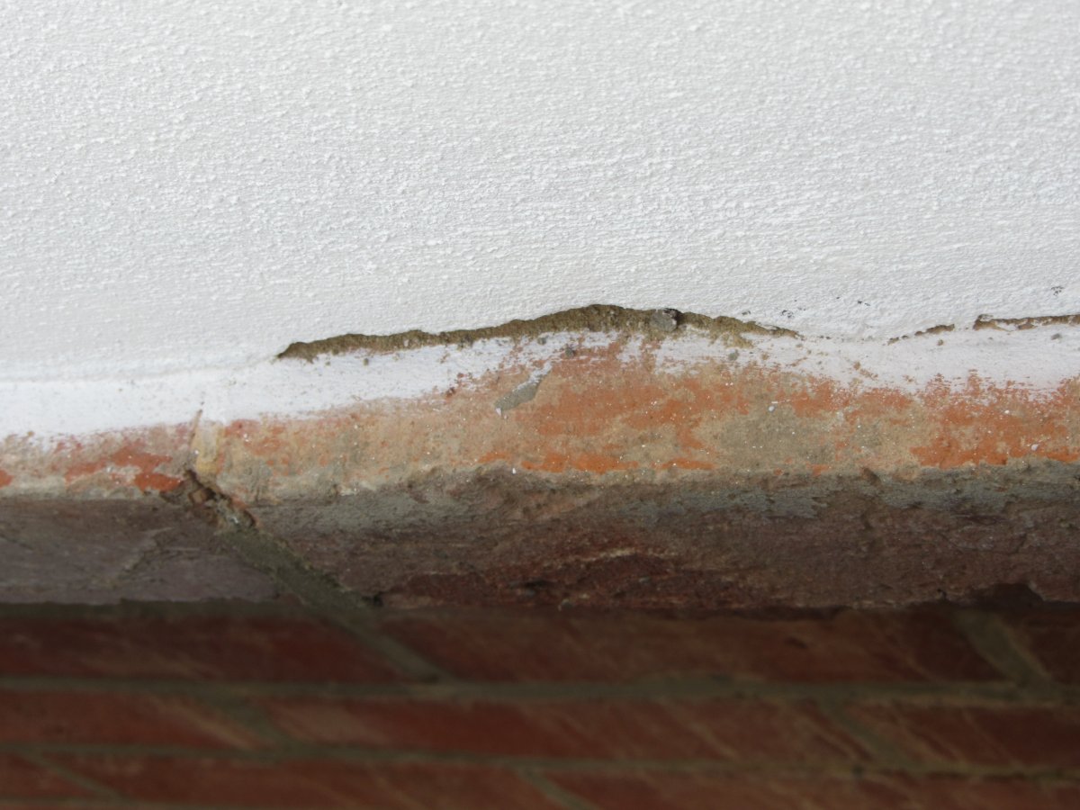

1. A section of the wall showing an undamaged part of the ledge, the wood is a scaffolding plank, it clearly shows no bell cast.

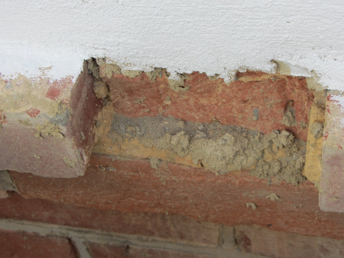

2. A bit at the side of the house where there is a clear gap between the mortar and the ledge, there are about twenty of these mainly smaller.
3. Rendering around the flashing on the conservatory
4. A missing brick in the ledge, top course
5. A section with two or three missing bricks, the scaffolding goes right up to it, the reason for these bricks not being replaced I suspect.

What your photos show is mostly wrong.
Reference the brick ledge: first all brick re-newal and re-pointing should be done & then a fillet of sand & cement should have been laid and then covered by lead flashings recessed into a brick bed & drooped out over the ledge to shed water away from the wall.
Best practice would then have a Bellcast fixed above the flashings and the render brought down to the Bellcast.
A Bellcast is an obvious requirement for the job - for most render jobs come to think of it. As a general rule why should you as a householder have to request one or even know about one? Are you expected to specify the type of sand or the height of the scaff lifts?
The "cavity trays" in photos 3 & 5 are well wrong. Great dollops of sand and cement and lack of stepped custom made cavity trays. This aspect was wrong before any render work. Do you have photos of the whole elevation and above the conservatory?
Landing the scaff lift at the ledge was foolish - they are in their own way.

A Bellcast alone wont be wide enough to shed water beyond the brick ledge. The Bellcast should be fixed to the bare brickwork.
First, as mentioned above, you must have a cover flashing.
Google the widest Bellcasts available - 60mm plus if possible in plastic or SS.
