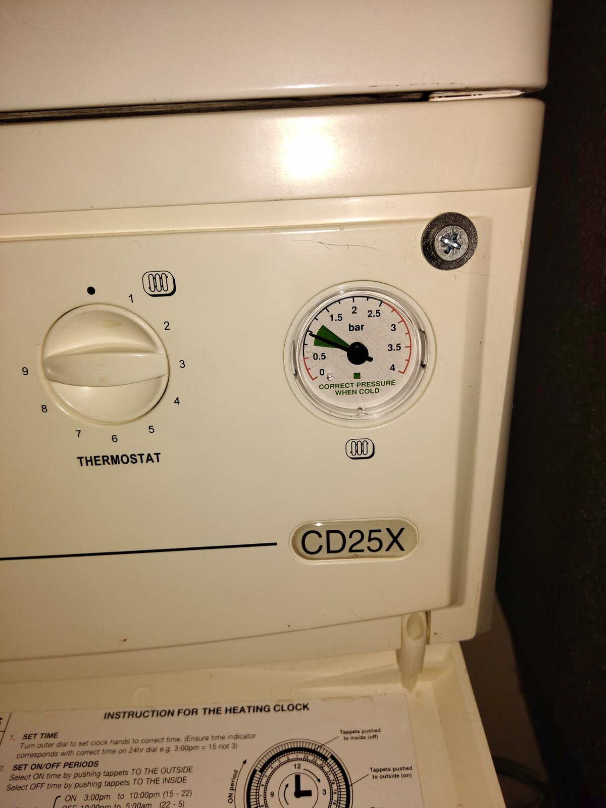

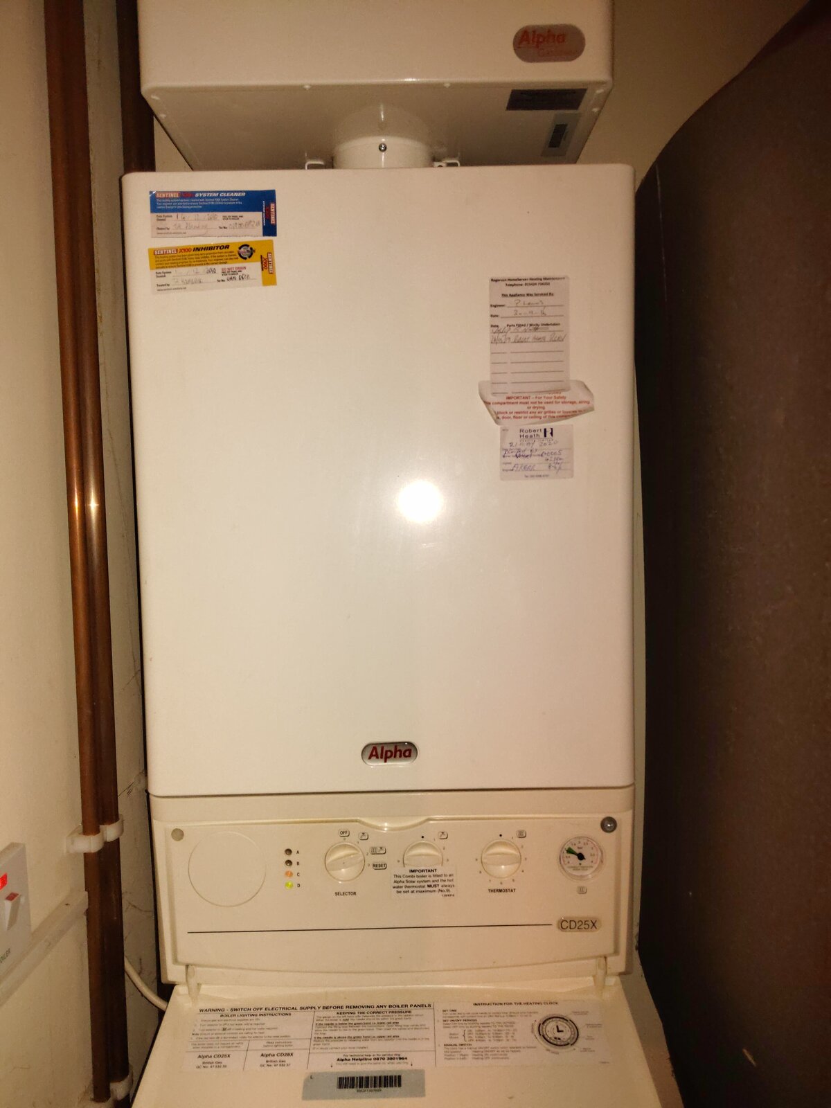

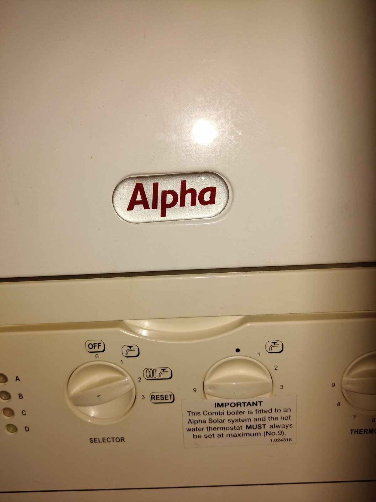

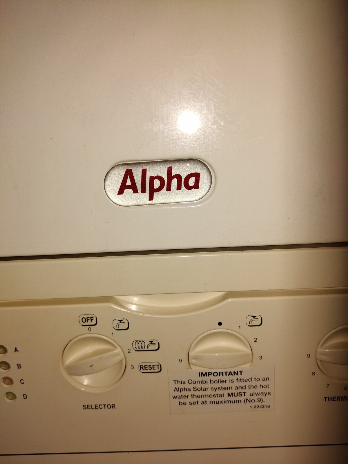

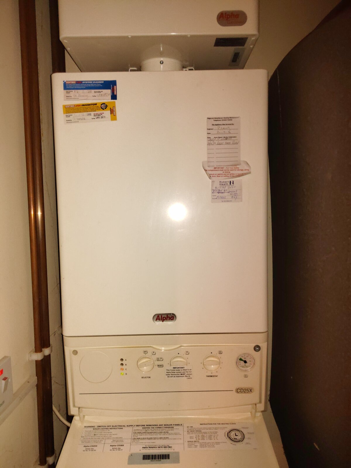

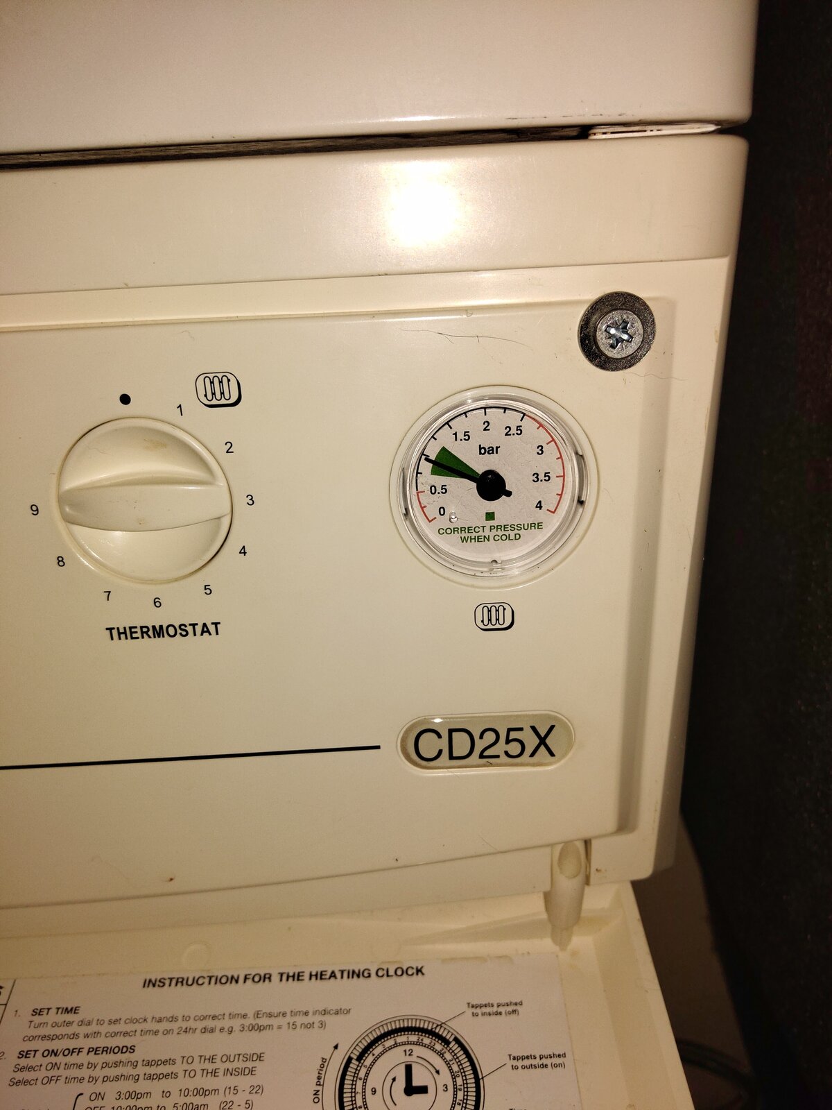

I only have these photos to hand right now of boiler. I'm not home right now but will take some more photos when get home. Silver/grey thing next to it which you can see in one picture is water tank.

All this would be consistent with the cylinder supplying the downstairs taps, and the boiler supplying the upstairs taps.
And the cylinder only being hot on sunny days
Meaning the cylinder is not being heated by the boiler (or possibly a fault in the solar plumbing causing it to drain heat from the cylinder)
I don't know what's wrong with the cylinder system, but some photos of the pipe layout, pump, thermostats and valves might spark some ideas.
BTW a dishwasher uses less water, and less energy, than washing up by hand.
ignore all the comments about the solar supplying the upstairs and the boiler supplying the downstairs , that is completely wrong, stop calling it water pressure it is water flow rate, and the flow rate to the downstairs taps is restricted, you are not getting enough flow rate to trigger the boiler sensor to start heating the HW, there may be an isolation valve somewhere for the downstairs circuit that is not open properly, but might be that the sinks are fitted with flexible hoses, some of these are very restricting, try opening all the downstairs HW taps at the same time, does the boiler fire and heat the water now ? that will confirm it is a flow rate /restriction problem, the upstairs taps work when the solar has depleted so the boiler is working correctly
