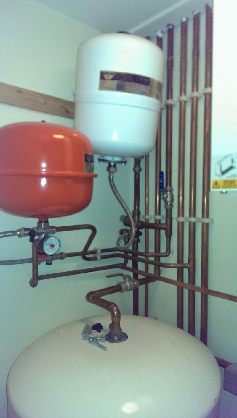

I've been having an issue with my hot water in the last week.
Essentially the hot water has stopped working, the timer is working correctly, but the boiler never turns on and the water doesn't get heated.
The only success I've had is to turn on the central heating at the same time, this allows us to use the hot water, but it does mean fiddling with the thermostat whenever we want hot water.
The motorised valve has been suggested as the fault, but there are only 3 in my airing cupboard and none of them are related to the hot water as far as I can tell. Two of them are on the central heating pipes and one of them is connected to the solar powered heating system.
I assumed the solar powered heating system is a closed system and won't have any affect on the hot water, it just takes water from the panels into the water tank. Although I'm not sure if the motorised valve is working correctly as the switch is lose.
I have an engineer coming out on Tuesday but any advice on things to look at what be great.
Thanks in advance

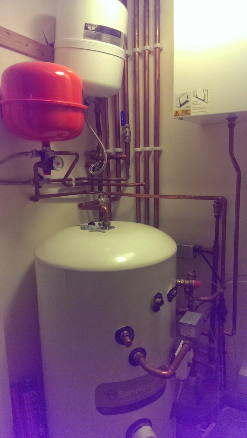

Can you post a pic of the airing cupboard? We need a general view - not close ups - so we can see how everything connects together.
Thanks for the reply - I've uploaded some photos, some are a general view and some are close up.
I did try and draw a technical drawing, but it gets quite complicated quite quickly in the cupboard. I can still give it a go if you think it would be useful, might look amateurish though.

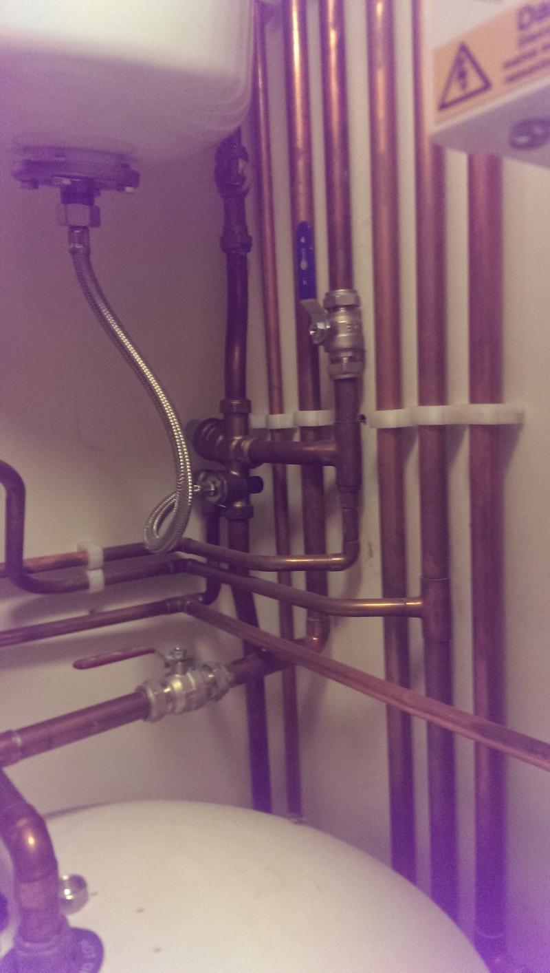

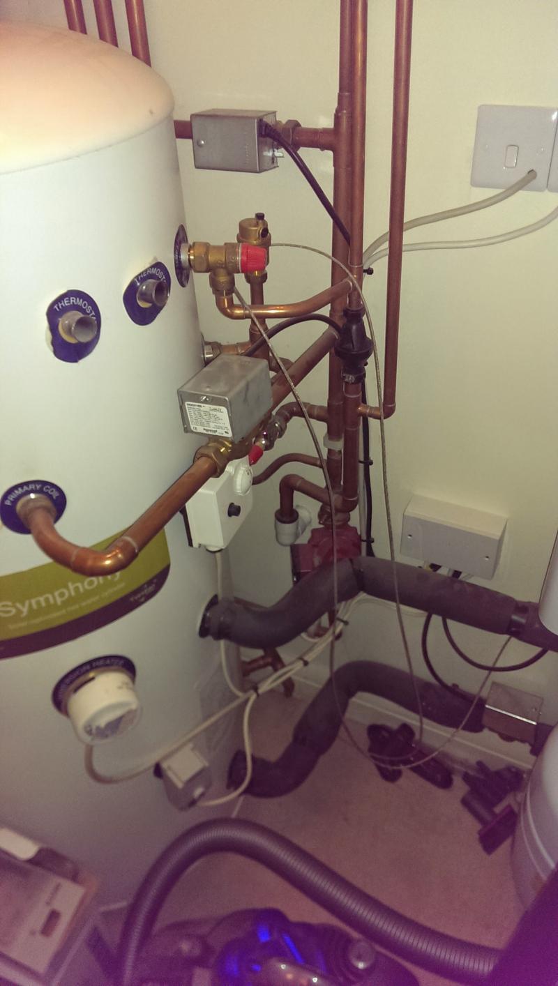

3rd pic from left. the metal box that that is on the pipe that leads into the cylinder.
its faulty.
needs to be replaced. you can get just the head on its own and simply remove/refit it.
Thanks for that - think I'm starting to figure out how it all works.
Because that valve is failing and I have the central heating valve open the hot water from the boiler is going through the primary coil and the central heating loop, which in turn gives me hot water.
It the valve was working correctly the central heating valve can be shut off and the hot water from the boiler only goes around the primary coil. Which in turn heats the hot water in the cylinder and I get the hot water.
