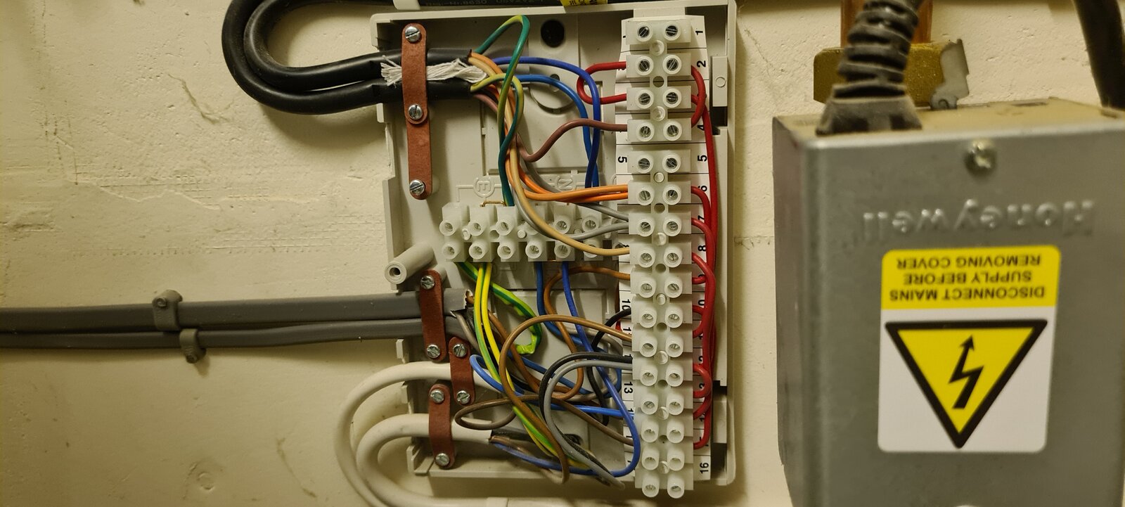

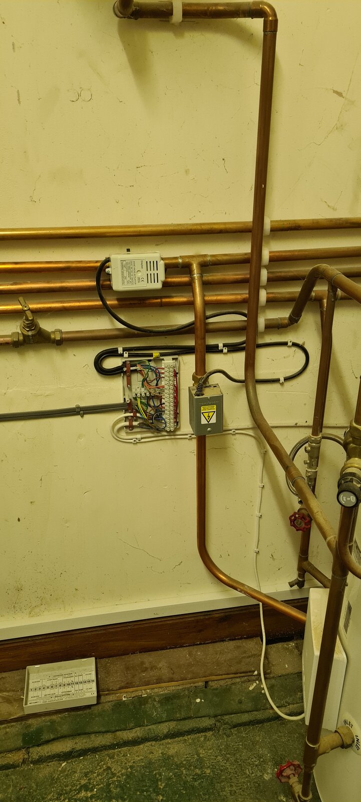

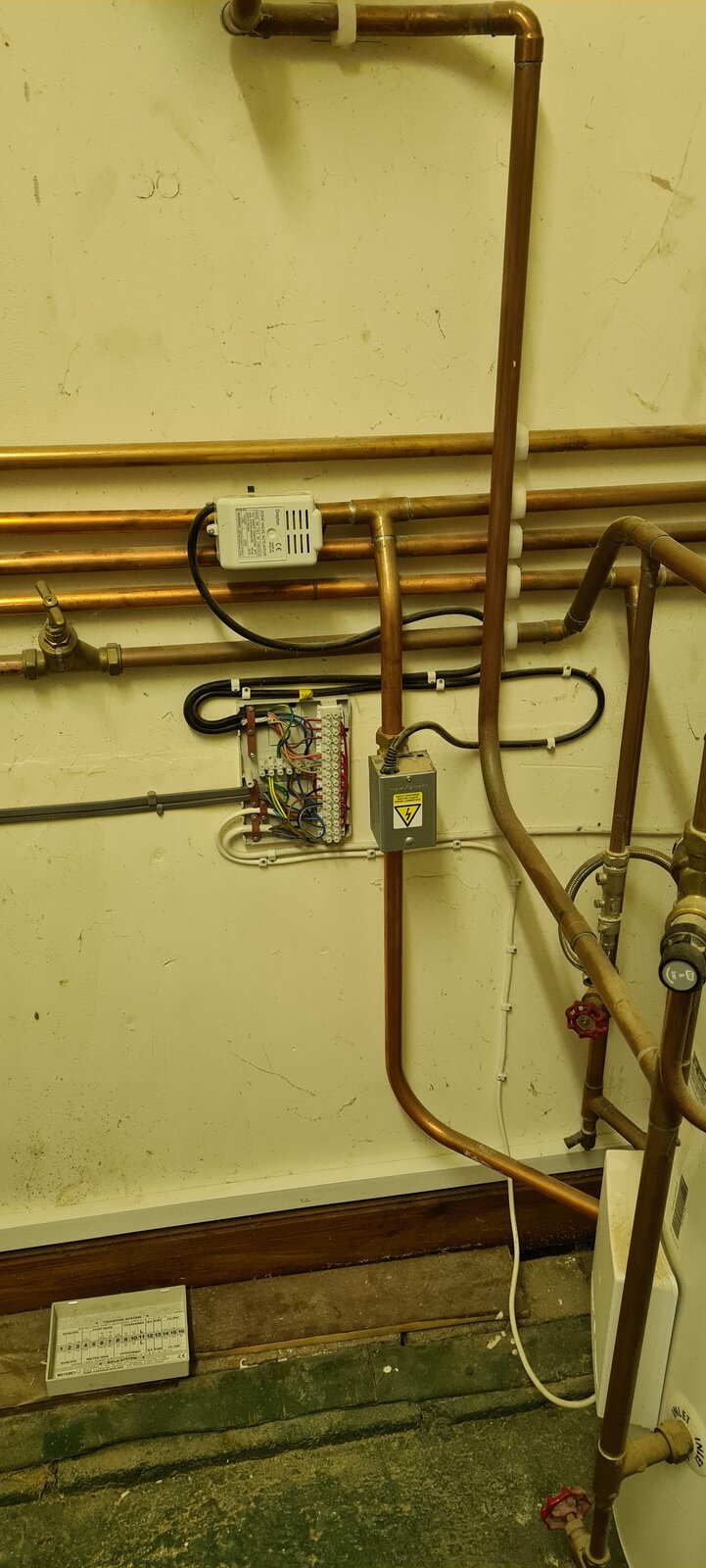

Post a photo of your wiring, explain the type of system you have, eg 2 port valves, or 3 port mid position valve, did you set the Hive up as gravity?
Hi CBW
It is 2 port valves
Some pictures attached
It's like the hot water tank doesn't work without the heating coming on

  • Did it work ok before you installed the Hive?
  • Did you set it to gravity?

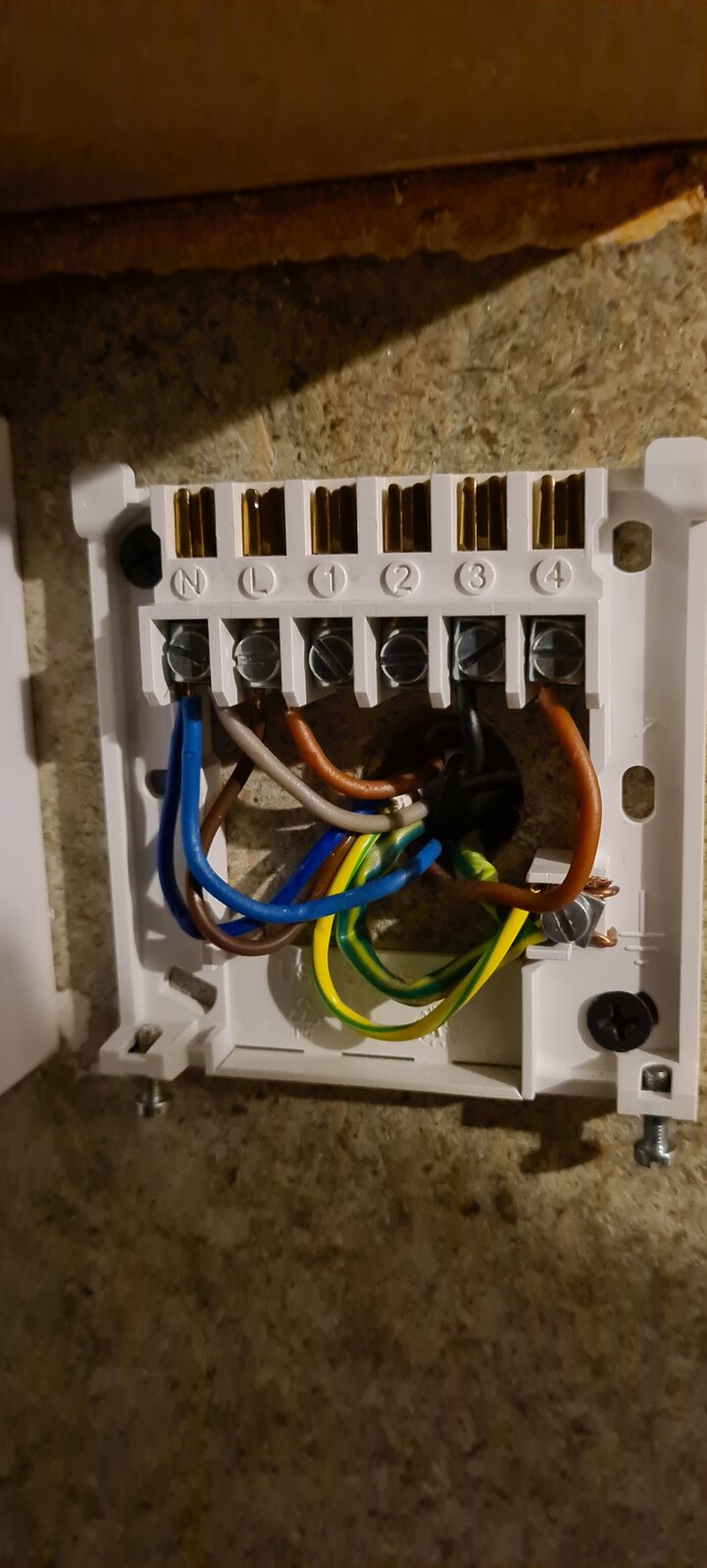

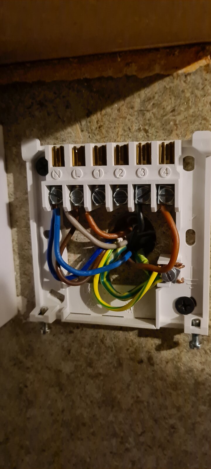

  • Can you post a photo of Hive wiring?
  • Did you alter any wiring in the wiring center?
It was a drayton in before which I believe would have worked but I have not long moved into the house.
I'm unsure what you mean by gravity?
No changes were made in the wiring centre

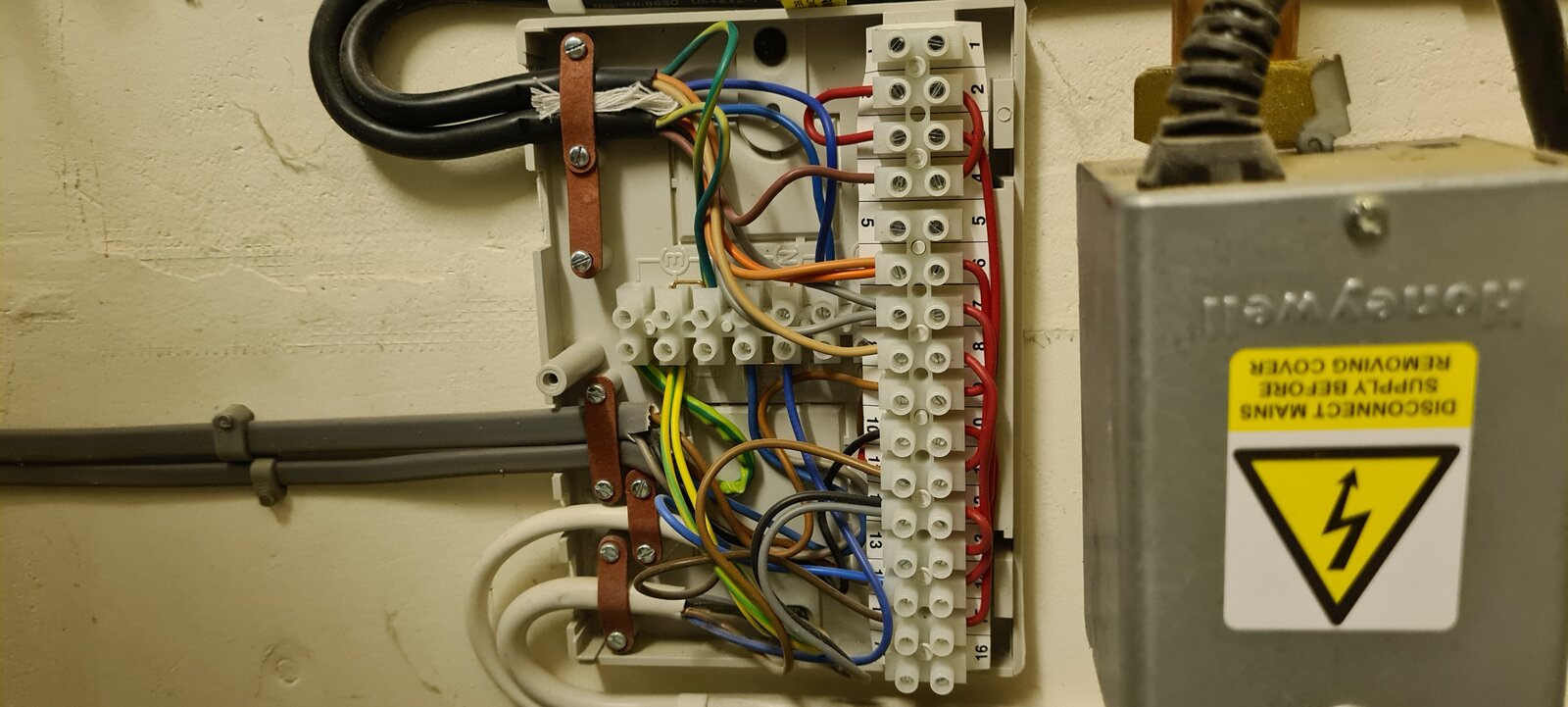

I have a brown coming from HW tank to 15 (COM) then a red from 15 to 10 (HW on) then black from 10 to number 3 on hive receiver (HW on)
Blue coming from HW tank to 14 (CALL) then red from 14 to 8 (HW off) the goes to HW tank valve
In the Hive setup, I believe you tell it what system you have, one being gravity. It’s definitely the Hive dual channel?
Hot water off isn’t used in an S plan, which you have.
I haven't changed anything at the wiring centre that's how it was before I installed hive.
I'm trying to figure out what is linked between the boiler and the HW tank that when I turn the boiler on I also get HW

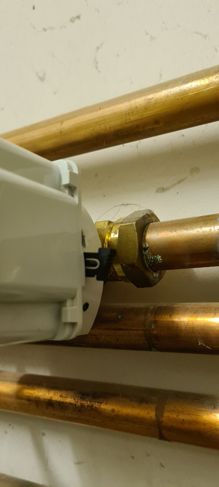

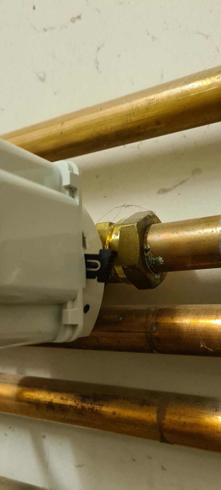

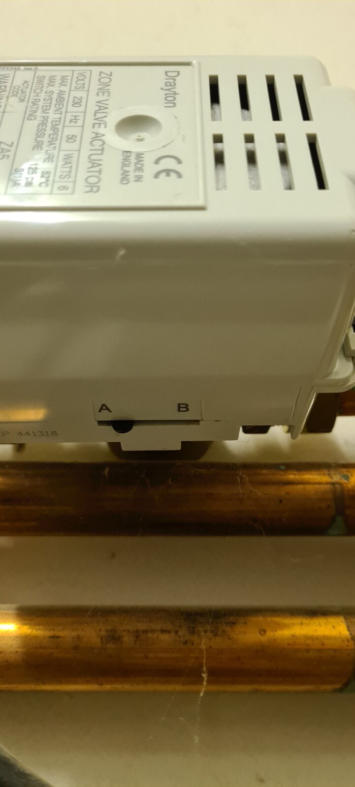

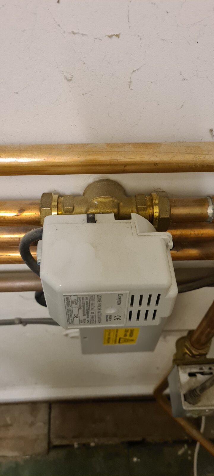

Ok, go to the cylinder cupboard, and providing there’s no call for heating or hot water, check the zone valves positioning, I’m thinking the zone valve is stuck open, likely to be the Drayton, so when you’re getting heating, that’s when it’s heating the cylinder.
Yeh it's only heating the cylinder when the heating itself is on. Although I have my settings in the hive app to always have the HW on and shows its always on on the receiver light but obviously isn't.
Not sure about these
