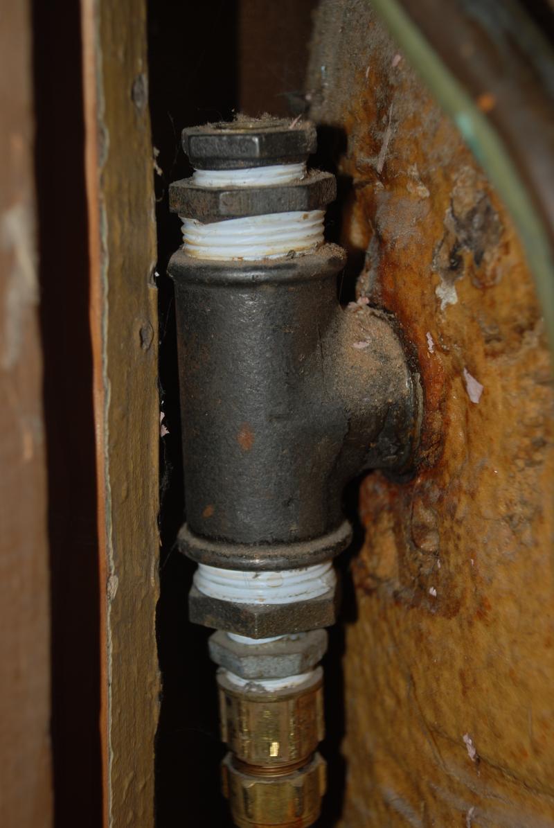

If you have refilled with the F&E tank then the feed is not blocked.
That then leaves the hot water heating coil. It could be airlocked.
There should be an air bleed screw or cap or a pipe to the vent from the upper heating coil connection.
Can you post a picture of this?
It could also be a blockage in the heating coil. This most often occurs at the actual connection to the coil. perhaps you should partially drain and disconnect both connections to the coil?
Tony
Thanks again for your help,I dont see anyway other than disconecting the pip there is ne bleeding valve that I can see, loaded some images just to make shure I am on the right pipes thanks again.Ian
That looks pretty horrific!
Are you quite sure that there is not an air bleed screw on the top of the top fitting?
Using black iron fittings like that is asking for corrosion blockages!
Its not clear to me just what the cylinder is made of. It may collapse if you started unscrewing any of those parts.
If its not a bleed screw at the top then I suppose you could risk unscrewing the smallest plug at the top a few turns and see if air comes out.
But at the end of the day its probably blocked and a very difficult scenario to even contemplate any work on!
Tony
Yea I know it looks bad the tank is copper with a insulation foam sprayed onto it,the system was put in 35years ago. The only other thing was the back boiler in the fireplace which only heats hot water is not heating anything another air block I thin,k any ideas how to shift it or are the two problems connected.Ian
