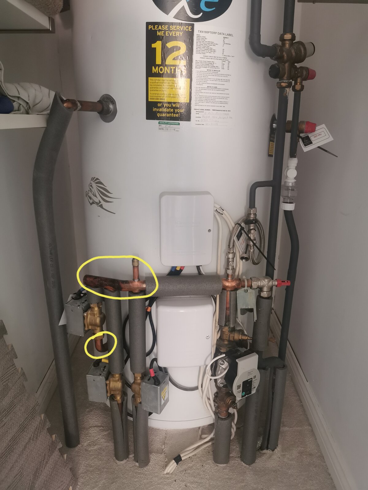

Afternoon all.
I'm hoping someone can help as I've noticed that the water is not getting hot at all. I have a vaillant combi with a Tribune XE unvented water cyclinder controlled by a Danfoss TPOne-m but the pipe work isn't getting hot at all (circled in the photo) The system pressure is right but the boiler isn't even kicking in for the hot water. It's fine when central heating comes on.
Any ideas please?

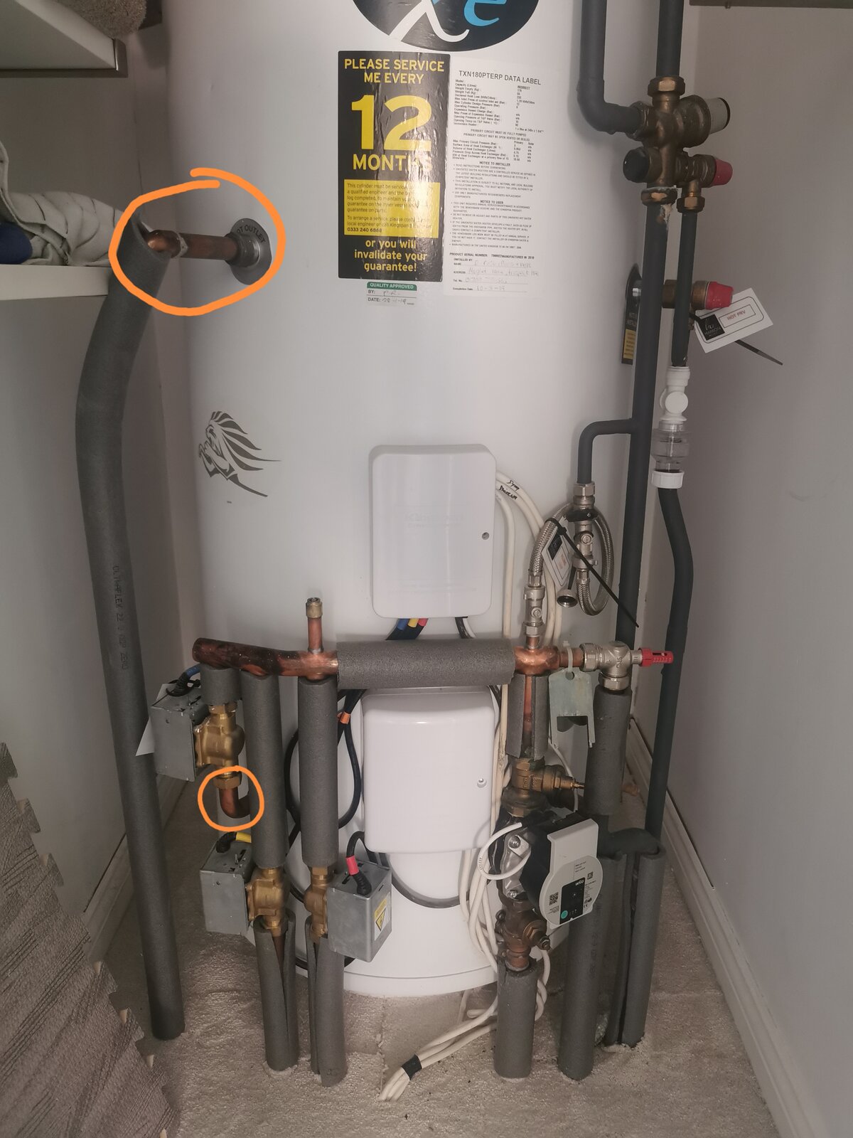

Yeah definitely a combi. That valve which I've ringed the pipe underneath it, there is no resistance on the lever at all, I can just wiggle it backwards and forwards unlike the other 2 valves which are the central heating circuit that have a resistance on the levers and you can hear the motors winding back

Now you've said that about the boiler I'm not 100% sure now. It looks as if theres a 1/2 inch gas supply going in at the bottom and then 2 x 22mm pipes coming out of the top which is the heating flow and return.
I can't manually open the HW valve at the cylinder as theres no resistance in the lever when pushing it to manual which is making me think the valve head is faulty?
When I put the heating on these circuits start getting hot which I've circled in yellow

Everying is off and there's no resistance at all from pushing the lever, it doesn't even return back to auto when you let go of it like the other 2 do which you can hear the motorised valve closing on those. If I start running just the hot tap downstairs in the kitchen nothing happens and the HW valve appears to do nothing with both pipes circled in red remaining cold. The boiler doesn't even seem to be firing up but as soon as you turn the central heating on, the boiler kicks in and the rads start heating as normal. Got no faults showing on the boiler either. I'm at a loss to be honest now.
