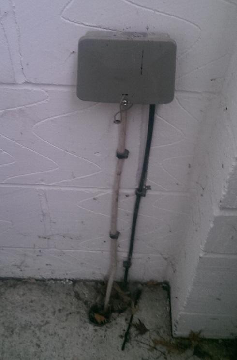

As far as I can tell, the property I have just moved into has no master socket. This seems a bit strange as it's only 10-12 years old and I would have thought it should have one? I'm not 100% sure where the demarcation point is because of this.
The line from the street enters into the garage into this small gray box.
From there the white cable leaves the box, runs under the garden and into the utility cupboard. The wire are connected straight into the Krone blocks which link in all the other phone sockets in the house (The bundle from the outside box is the thick collection of wires on the outside left of the loom, 2 wires from the bundle join a Krone block at the bottom).
There is no master socket. This raises my first question of what is BT's and what is ours? It also means we are lacking the standard surge protection.
What I am thinking of doing is putting in a master socket before the Krone blocks (i.e. moving the thick bundle to go to the socket, and using the extension from the socket to join the Krone and the rest of the plates around the house). I intend to do centralised filtering at the new socket, so house faceplates are phone only. Not sure which faceplate/socket I need for this?
The goal is to have the ADSL modem/router in this cupboard and feed straight form the new socket.

You have 2 cable coming out...where does the black one go?? ..that could be where your nte is on the end of that..I suspect who ever had the premises before you was working from home as there maybe a couple of lines going in there...contact your SP as this is a new line you should not be charged for it.
I think the dropwire might be the feed as the white cable could be the 10pr internal at the krone strips. op, as you know they're supposed to give you a master socket, but if nothing gets done id say your demarcation point would be at the krone strips as this is how Bt present business lines to a customer owned switchboard.
If it were me I would terminate the white-blue/blue-white pair from the 10pr cable (I assume it is 10pr) onto a spare pair on a Krone strip then join a short cable (prob 3pr - only using the blue pair) from there to an NTE5 as the incoming pair, mounted adjacent to the box conn. The line can then return from the customer side of the NTE using the orange pair in the same 3pr cable, terminate on another spare on the Krone strip and then jumper it away to the internal sockets, which are presumably all terminated on the other Krone strips?

Yeah that's right. The black dropwire is the feed and goes underground to the BT manhole in the street. The white 10pr goes from the garage to the utility cupboard. That grey box just links them together.

Thanks, I think this is what I will do. Also means if BT ever take issue then I've not actually changed any of "their" cabling.

Is that box con and krone strips BT branded? Usually BT on the middle of the krone, and BT on the lid Center.
Then I would say the demarcation point is the grey BT66B joint. Certainly not correct. It all looks like a bit of a bodge.
On a normal commercial multi line installation the punch down strips would be the de-markation point. Full line testing by OpenReach would not be possible as there would be no in service resistor or bell capacitor on the line if the customer di not use master sockets.
If this is gong to be a new domestic service then BT should arrange for a master socket to be installed as part of the new service. And remove the now redundant box and cabling.
If BT present to the krone strip, they usually fit surge arrestors onto the top of them too. These days, most installs will see ISDN, not PSTN for phone systems with several trunks. Still plenty of older PSTN types in service though.
As this box conn is not BT branded, they did not install it. It looks a friggin mess too - Not a BT installed one IMO.

The "neat" way to do it is to terminate the 10 pair that comes from the incoming service box onto a Krone strip.
Terminate all your fixed cabling onto other terminal strips, passing them down the back.
Then jumper things around as needed.
For a plain old phone line, stick the master socket next to the box and jumper as required.
And find a lid for the box.

Thanks guys. I've done this now and neatened it up a bit (there was also a cover for the box, it was just off for the photo). Internet connection is 4 times faster now which is great. No idea what the previous owners here were doing.
