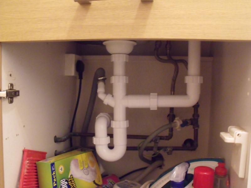

I am re-doing my kitchen and have fitted a new sink. It is a 1.5 size sink, neither sink has an overflow spout. When the plug is in one sink if you pull the plug out the other sink it wont drain (because their is no air behind it I assume) and leaks from the drainer unit under the sink. The drainer unit probably just needs tightening but is it odd that their is no overflow, should I cut one out?

As for your second point about not draining, can you post a pic of the traps you've used?

Yes I can see now how it would overflow. The picture of the traps are below. It is from a Marley 1.5 drain kit. The plug holes are Marley chrome drain/strainer units.
It drains fine when both plugs are out but if one is in the other sink drains slow and leaks from the bottom of the drain unit which can be seen at the top of the photo. When I installed thses drainers I didn't use any silicone because it didn't say to in the instructions. I have used a different brand before and that did say to use sealant.
Shouldn't need silicon, but if you can't get a seal any other way then it can't do any harm.

I can't see anything particularly wrong with your drain pipe work - the half bowl will drain slightly slower than the full one but that shouldn't give any problems.
Just seal up the waste fitting on the full bowl and job done - apart from one thing....tie up that dishwasher or washing machine drain hose high. The way it is at the mo, a good sinkful of water could find its way back into the machine.
