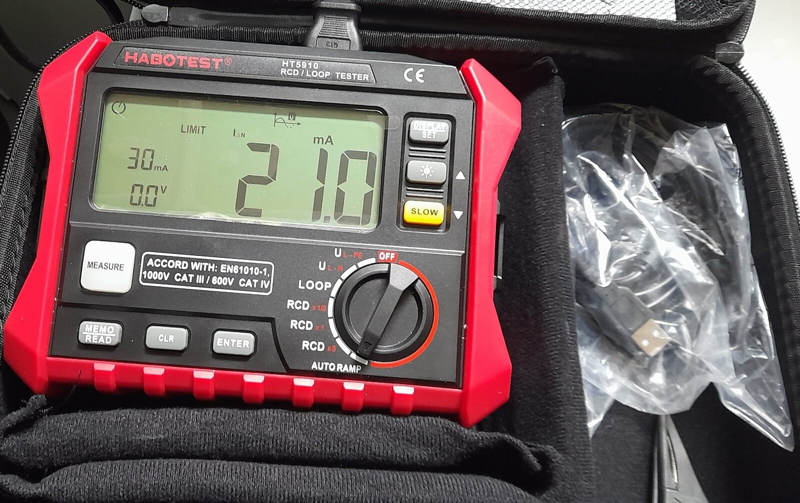

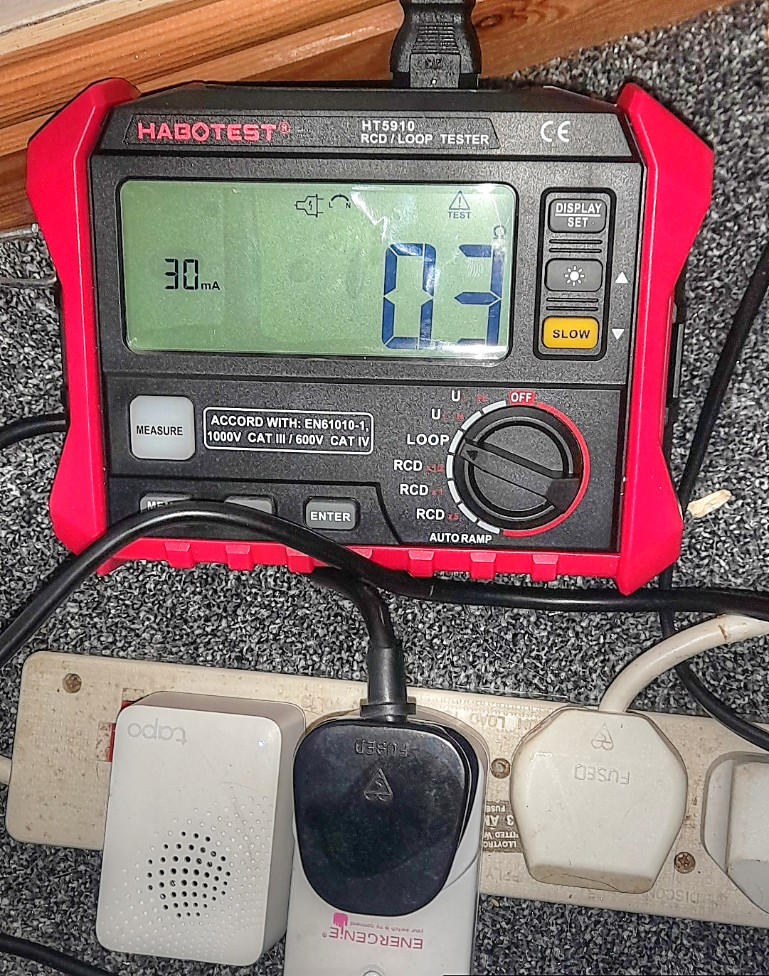

So I can test a socket, Loop-test.jpgRCD tester ramp.jpg both for loop impedance and if RCD works, and can test any background leakage, ⁣ but Diffrence line neutral 8 Feb 24 reduced.jpg does it really matter? Unless I go poking about, I am unlikely to have any problems, and OK I own this house, so I can poke about, but if I rented I can't really look inside the consumer unit, so the only way I can say "this socket is not RCD protected." is to say I have tested with xy or z meter, and it has failed.

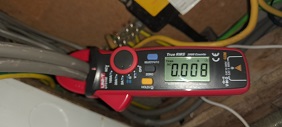

The big problem was lights, the aim with the old 2 RCD consumer unit was to have lights and sockets split, and no room had lights and sockets on the same RCD, however best split for sockets is side to side of the house, as more even load, less cable used so better loop impedance, and if one circuit failed, no temptation to run extension cables up/downstairs. But lights were often split up/down, if split at all, often when split it was not originally wired that way, so common to find a borrowed neutral situation with stairs lighting.
So 314.1(iv) reduce the possibility of unwanted tripping of RCDs due to excessive protective conductor currents produced by equipment in normal operation, and 531.2.4 An RCD shall be so selected and the electrical circuits so subdivided that any protective conductor current which may be expected to occur during normal operation of the connected load(s) will be unlikely to cause unnecessary tripping of the device. Became a problem until the general role out of RCBO's.
We are told no more than 30% of the RCD rating shall be background leakage, so 9 mA, but until rather resent clamp-on ammeters would not measure less than 10 mA, I had to update mine,
and my house is only just within the limit, not a problem as 14 x RCBO's plus two RCD sockets on the UPS supply.
