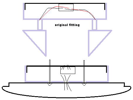

I've done something similar, the 'old fitting' was 3 spots on a 200mm diameter chrome base, I stripped everything off the base except the earth lead, drilled holes to match the new fittings cable and fixing holes, made off 3 flying leads to the connector block to go to the new fitting then mounted the new saucer shaped LED fitting using long screws through the old base :
