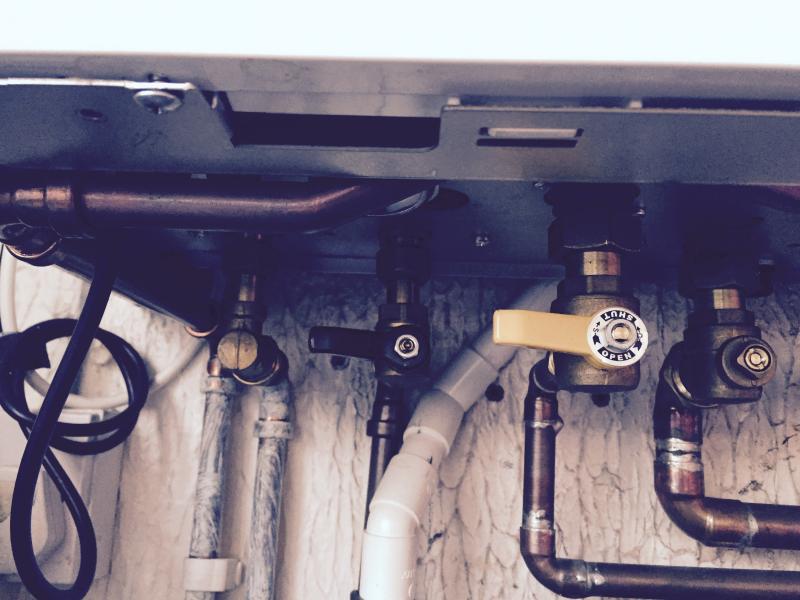

Would appreciate any help with this.
I have no running water from any hot taps in my house. But have water from the cold.
I have a sime combi boiler and this has also stopped working.
Any ideas ? Thanks
Everything was working fine until it happened.
First thing I found when looking was that it was a pressure lock but switched the hoses round and water ran fine.
Although I can't pressurise the boiler any more than it is.
Not sure if it's related at all.
is there power to the boiler and what is the pressure gauge showing
Yeah there's power. If I restart the temp just goes down then cuts out with al06 on the display. Pressure is showing at just below 2 bar but has always needed to be above the recommended pressure to get going.
Yeah everything is normal then when the valves are closed the temp decreases and water stops running from the hot tap. And then I get the error message on the boiler.
well the obvious suggestion is .......
stop messing around with the boiler and if you don't know what something is for then leave it alone!
do you think that maybe one of the valves you've shut controls the water supply to the boiler?
Doctor, doctor it hurts when I bang my head on the wall - well stop banging your head on the wall then.
Honestly don't know. I've only found this out because I was told to pressurise the boiler and the valves have to be opened. Accidentally found that it all started working when valves were opened
