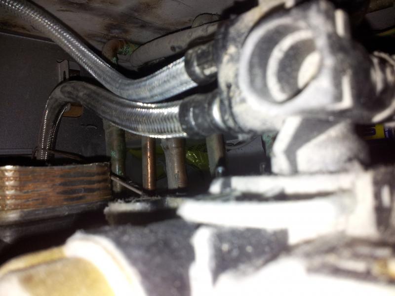

How do I get the pressure back on with a Britony Combi SE boiler? The pressure gauge is at zero and we cannot get heating or hot water. We need these urgently. There are four taps under the boiler, I believe from left to right they are CH flow, Gas (yellow), Water, and CH Return. There doesn't seem to be a filling loop or at least if there is I can't find any taps or valves on it as everyone keeps telling me. What do I do? Please help.
No can't see anything like, is that a filling loop? There is some silver flexible cable going from the far right tap (CH flow I believe) to some other part of the boiler at the back. It's confusing. Here are some photos
[/img]
Where did your pressure go in the first place? And from your description, you seem to be missing a water pipe. You should have cold mains in and hot water out. You must have a filling loop somewhere. Keep looking. We need a picture of all the pipes together directly below the boiler please.
Ah ok, you were right. There was a filling loop which I eventually found. So I turned it and things sorted themselves out - at first. The heating came on, we could get hot water but now the 'overflow pipe' is gushing water and our little garden has become a pond! Did I do something wrong?

I found a tap that changes the pressure, I assume this is the tap of the filling loop? The problem is if you turn it off the pressure drops to zero and we have no heating/hot water. OR if I turn the tap so that the pressure raises to approx 1 bar we can get heating/hot water but then the overflow pipe starts throwing out water. There's no happy medium with heating/hot water and no overflowing it seems...
Your pressure relief valve is passing, and you possibly have an undercharged/faulty expansion vessel, which may have caused your pressure problems in the first place. Sounds to me like you've reached the point where you should call in a RGI......
