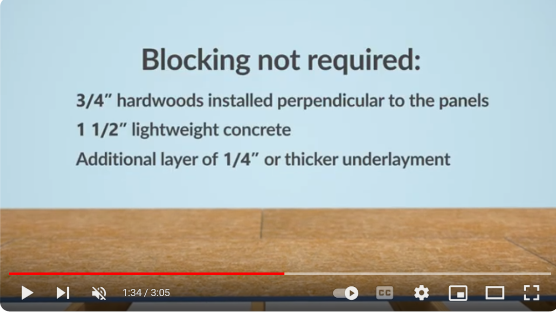

I have just built a new suspended timber subfloor, 3m length 95x45mm joists at 450mm centres. I am about to put 18mm plywood on top, perpendicular to the joists. The short edges have been cut so they meet on a joist, but although I have a fitted a couple of noggins across each joist they are not under the short edges. I maybe should have planned this better, but when putting together the subfloor it felt like the noggins worked better a bit nearer the joist ends rather than 1.2m in.
I will be refitting 18mm solid wood flooring that I lifted, on top of the ply, with tongue-tite screws and these will run perpendicular to the unsupported long edges of the ply, so I am thinking than noggins under these edges is probably unnecessary as the wood flooring should pull it all together?
Put them under all unsupported edges.
If you don't, there is enough deflection on the boards that if you are standing on one, it will be slightly lower than the board next to it.
Ok, thanks. There isn't very much flex at the moment on those edges and I had hoped the solid boards running across them would give enough support. I presume I could get away with less deep noggins, given the only purpose is to support the edges.

Just thought I would post the following alternative opinion on this (although I do still appreciate the advice above). This is from an American manufacturer, but the principles are the same, and they say blocking (noggins) not required if solid wood floor going on top. They don't explain why, but it's obviously because the perpendicular T&G finish floor is spanning all the ply joints. I knew I had seen this before but just stumbled on it again last night.
I tested the theory this morning and if I step on the long edge of one plywood board, at the point between two joists I can definitely see the slight flex that John mentioned. However, if I place even one of the shortest sections of the wood flooring across the joint and stand in the same place, I can no longer see any flex. Even if there is a slight amount of deflection that I can't see, I would imagine that by the time all of the boards are interlocked in the T&G and screwed into to the plywood it should be fairly rigid with the load spread out rather than point loaded on the join. I can totally see why supporting all joints is standard practice though, as trades wouldn't always know what kind of flooring is going to go on top and this clearly wouldn't be appropriate for tiles or carpet.
