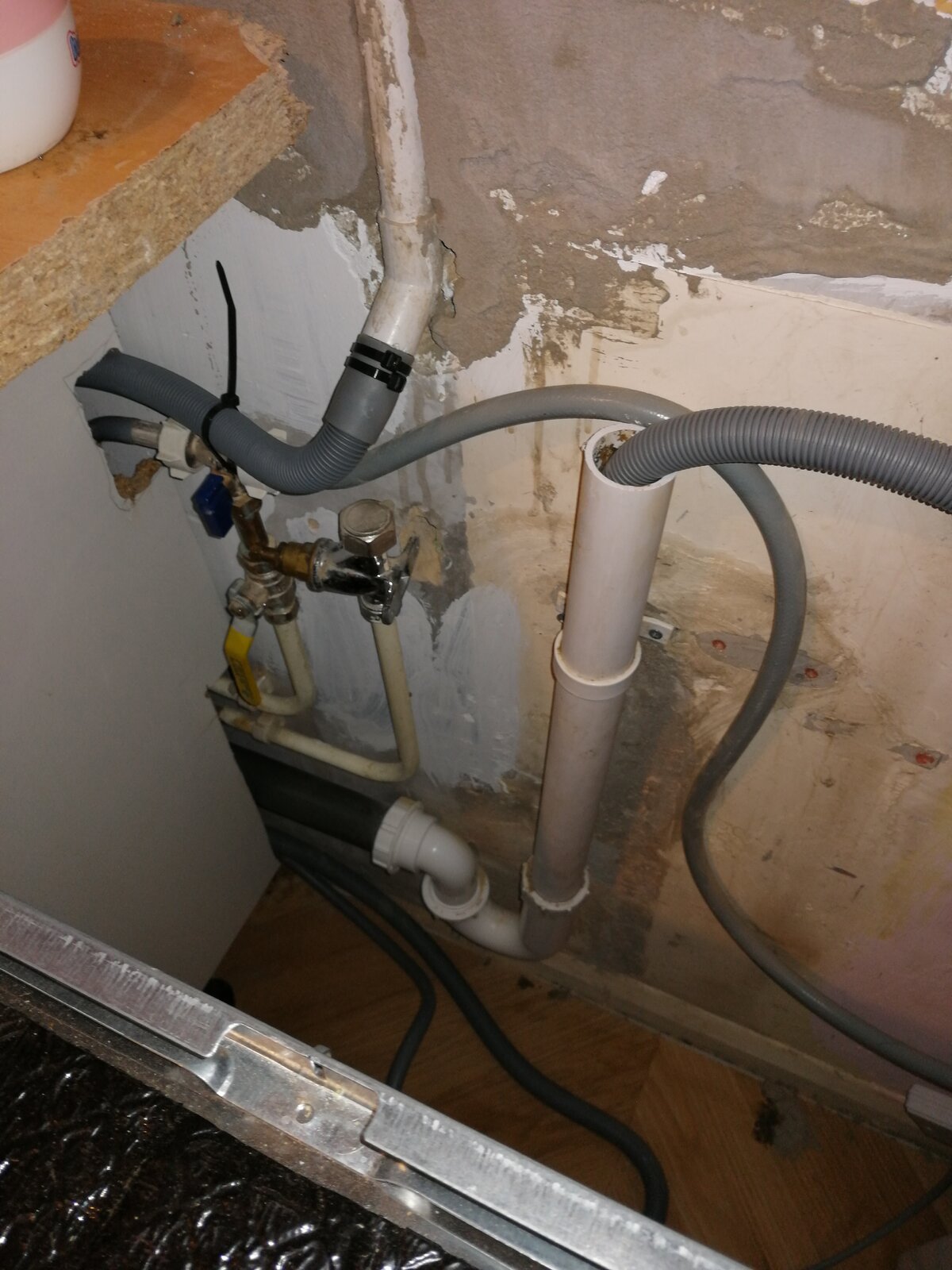

Hi all, bit the bullet had new boiler installed, now everytime water goes down sink get noisy gargling sound from boiler condense. How can I plumb to get rid of noise ?? Any ideas please. Pipe coming down in pic is new drain from boiler

Quite hard to tell on that photo, but it looks as though the pipe has a back fall. Did the noise happen straight after installation or gradual?
You need to fit an air break ( Item 2 ) between the boiler condensate pipe and the drain pipe. This will then prevent pressure changes in the drains from affecting the condensate trap that is inside the boiler.
A quick fix ( which may not be "legal" ) is to re-route the condensate pipe as in the red line. A slightly better would be the blue route with a "T" junction to the stand pipe.
In either case the condensate pipe must end above the end of the grey drain hose to prevent water under pressure from the grey drain hose entering the condensat drain pipe

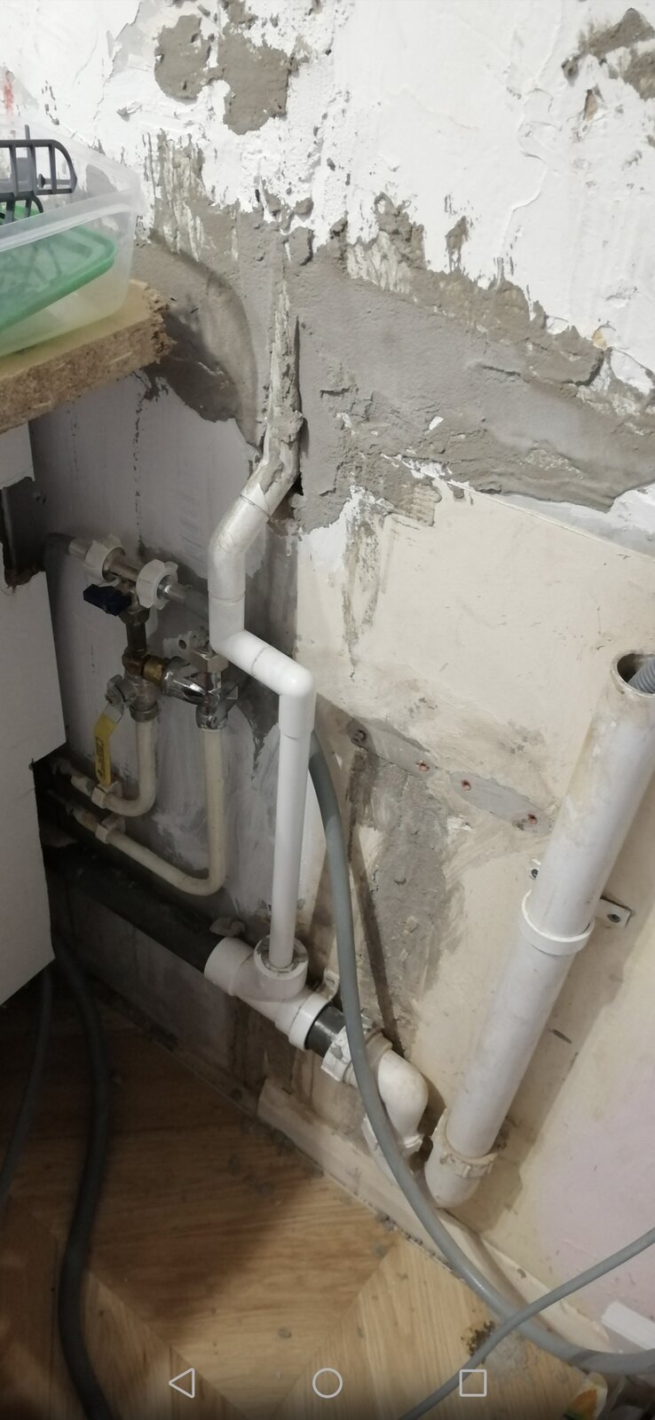

What an installation, look top right the entry to wate is next to electrical socket, one reason I want to move or liquidate this type of waste connection from washing machine.

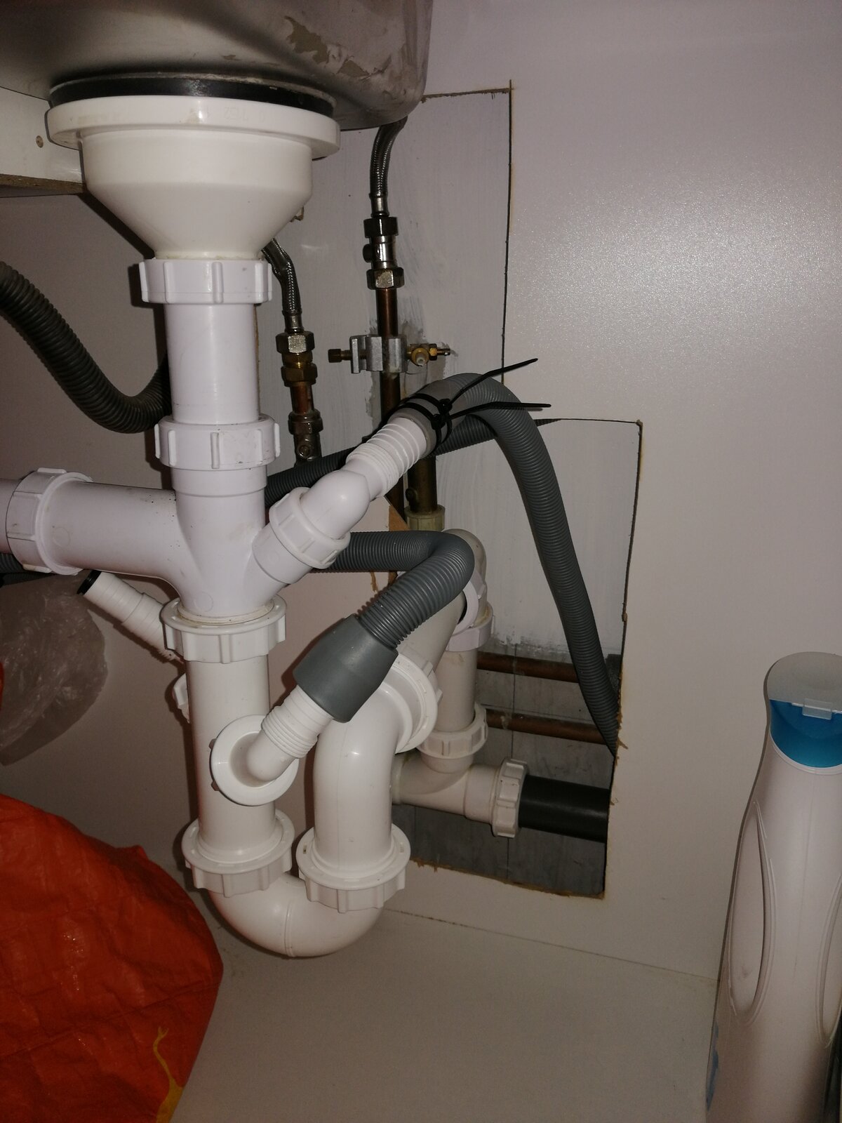

Fixed. No more noise. Got rid of solvent joints, brought pipe down to undersink and fitted additional waste connection, two in use, one blocked. I realise it's not intended for how I fitted it, bought wrong part. But I've elliminated nearly ten joints that could have been potential points of failure, though introduced a few more under the sink. Am considering running waste from washing machine to under sink to get rid of 40mm waste so I can get appliance closer to wall and have nice line for new kitchen that's in progress

:eek::eek::eek::eek::eek::eek::eek::eek::eek:!
Should of called him back, your repair is even worse,.........................................now we know why he was cheaper!

Anything to do with the condensate should really be dealt with by the installer (who is gas safe registered I would hope). It isn't really a DIY Job. Have you checked that nothing has become dislodged within the boiler? Or is that condensate pipe through the wall and mortared in? the way it is piped now, the sink draining and/or the washing machine could potentially pull on the condensate trap removing the seal.
Note item 4 ... most boilers traps have a 75mm seal these days so an air break not always needed depending on the termination or the MI.
That being said, always good practice to have an air break where possible to avoid the condensate trap being pulled dry, as may happen in this case.
