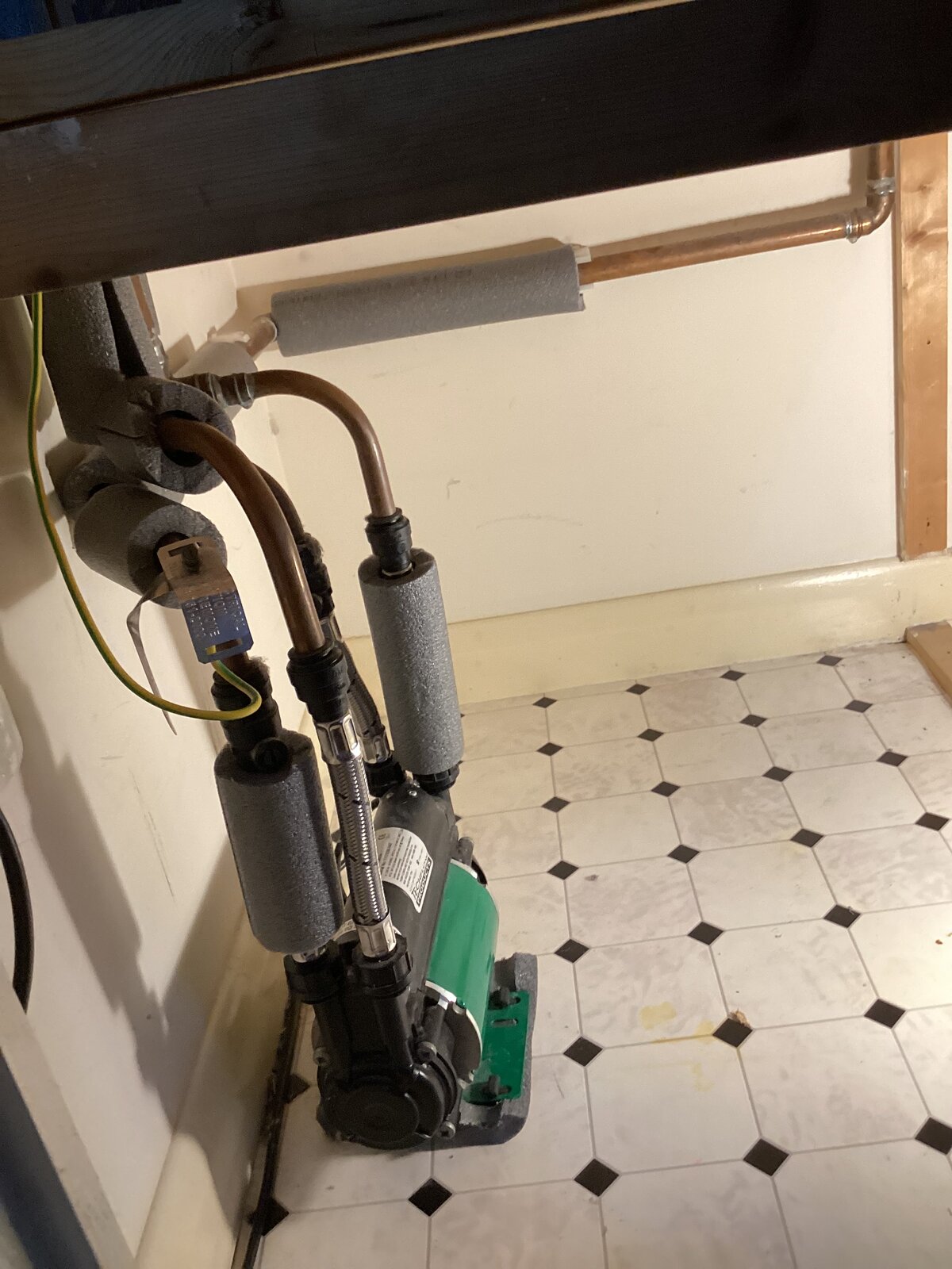

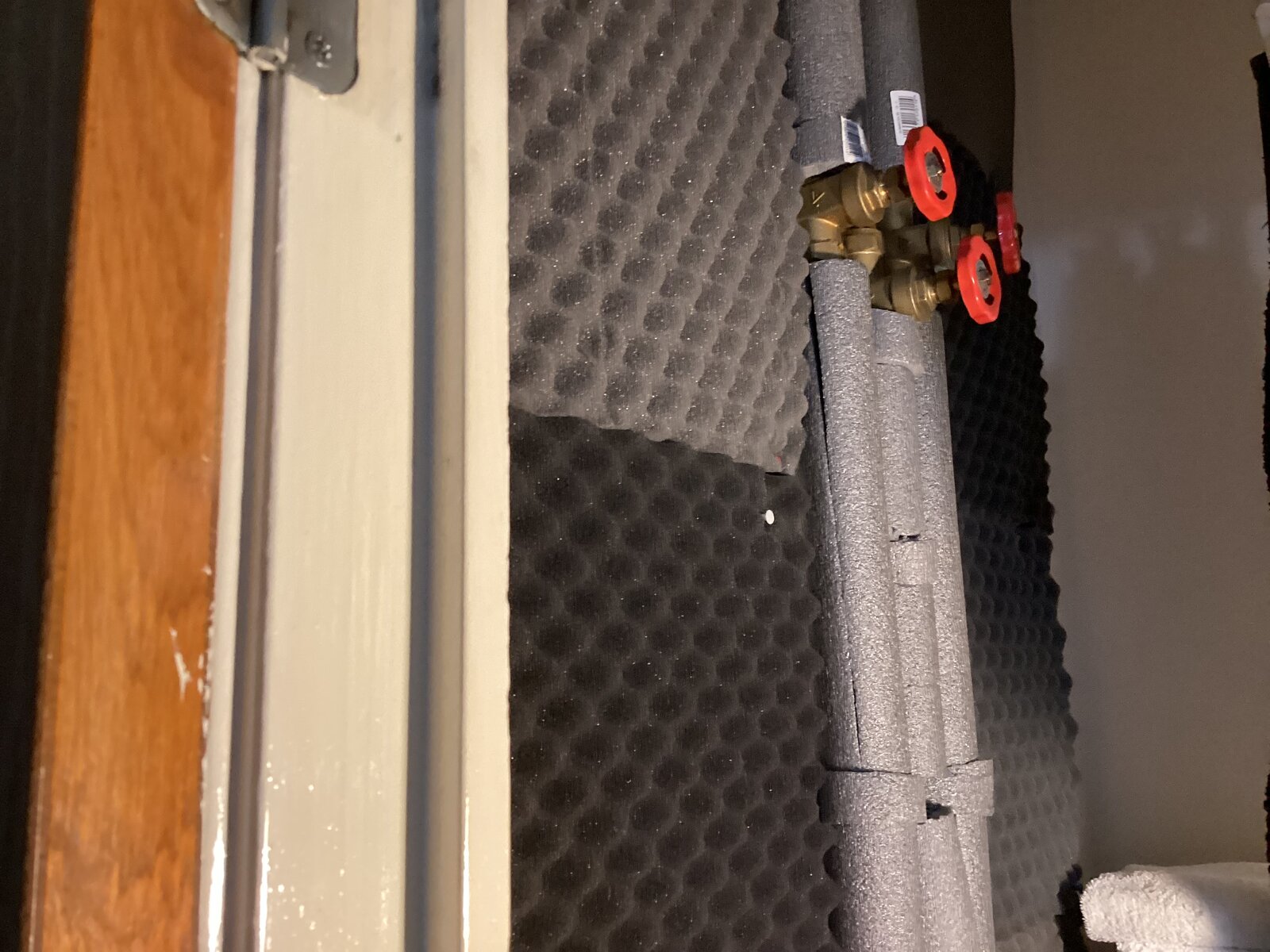

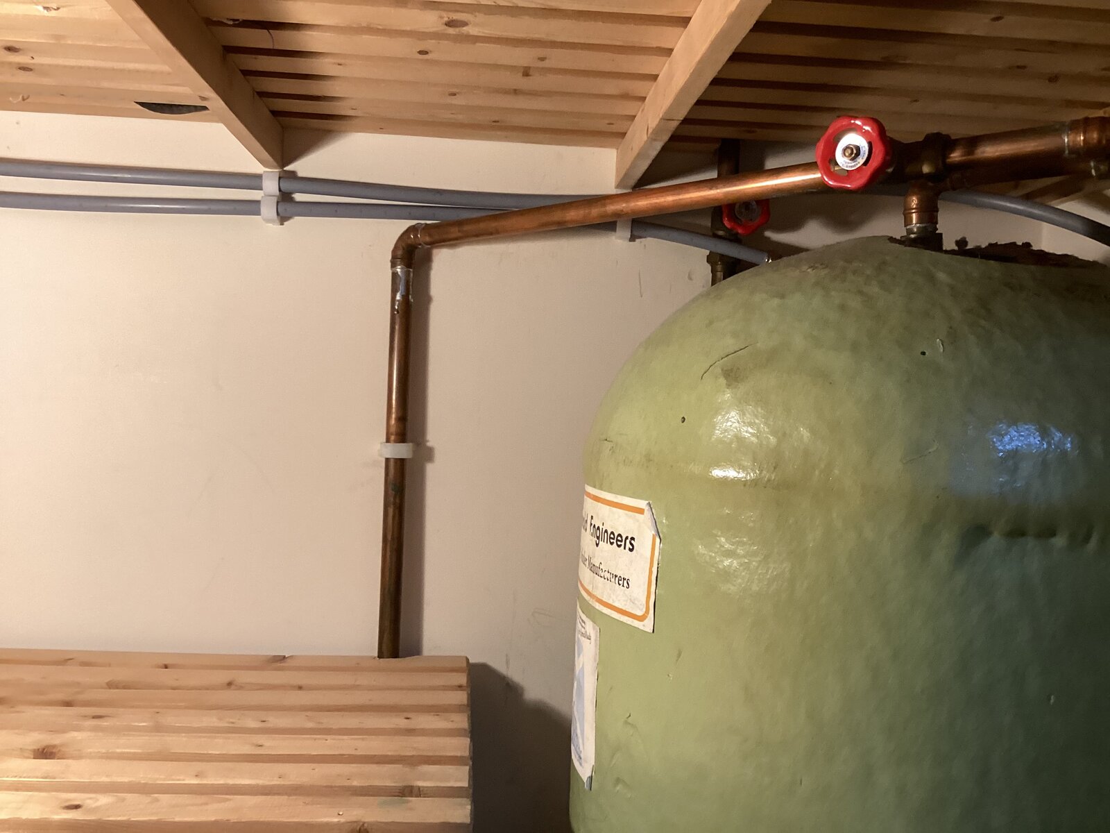

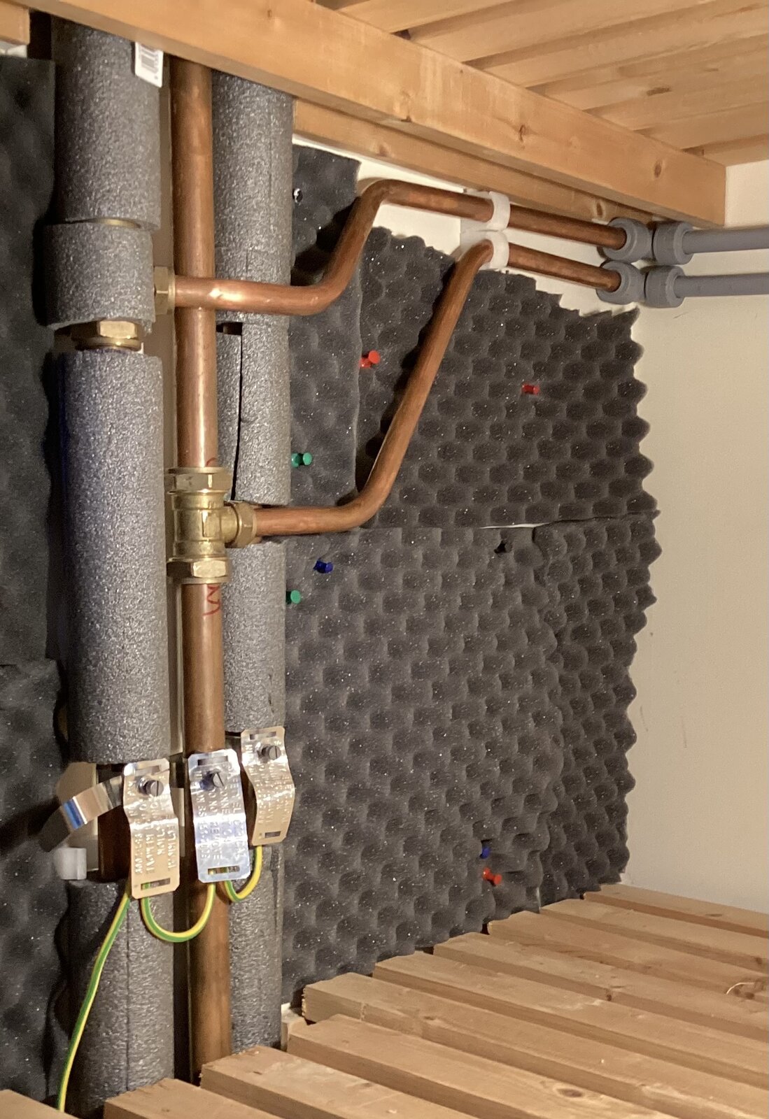

Following my previous’Noisy Pump’ thread which ended with Andy suggesting that I buy a new pump, I decided to start again by presenting in a series of photos showing what a plumber would be faced with if called in to remedy the problem.
One photo, ignoring the pieces of foam insulation, shows the pump in situ. Note that the plumber has used 2 pieces of pipe insulation below the unit presumably to minimise vibration and noise. From the pump via the flexible pipes, three 22mm pipes travel up the wall and into the ceiling space while a fourth, the feed from the.hw tank is fitted horizontally from there to the pump. Hopefully the pics will make the underlying cause of ‘the noise’ a bit clearer and the remedy a bit easier.

Is it just excess pump noise - I.E bearings etc are wearing out, or is it a resonance/booming noise? I think that needs to be understood first. That is also an older regenerative pump, which tend to be noisier than centrifugal pumps.
If, as suggested, it's 21years old then it could quite easily be the former, though if it's the latter then try a nice solid base - as suggested, something like a nice thick concrete slab to sit it on and makes sure the floor underneath, if floorboards, are well screwed down - that pipe insulation wont do much, especially if it's being compressed.

Bearing in mind that I know next to nothing in general about plumbing and absolute zero about pumps, I have an idea which may or may not work and I need advice. To the left of the existing pump there is room for its relocation or indeed the fitting of a new pump as suggested by Andy in my original thread. However, if I firstly lay a slab and sit the existing pump or its replacement on top of the slab the overall height would be increased. Would it possible to replace the short flexible hoses with longer ones to accommodate the height and increased length ?
Careful what you do with the flexi pipes - the ones that are supplied with the pump are quite specific and designed to run with a pump to minimise vibrations being transferred to the pipework and are stronger and thicker, to cope with the pump whilst operating, ordinary flexi pipes would not be recommended.
