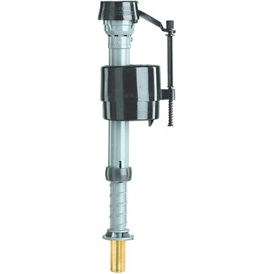

Get some one to remove the cistern cover to see what type of filling, either the ball cock type or the fast fill, (below).
it is an old style one - ball cock type similiar to this one (copied from someone else's post)

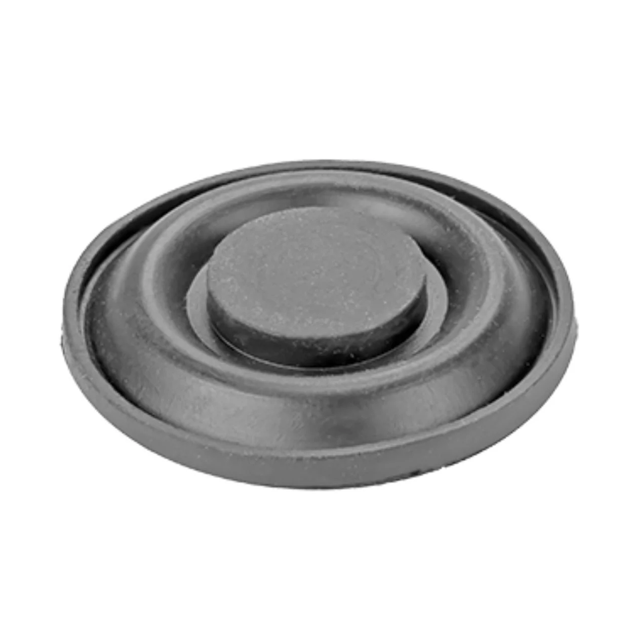

There's a diaphragm in these that presses up against the filling nozzle, maybe worth renewing this or the whole ballcock assembly, they are not very expensive.

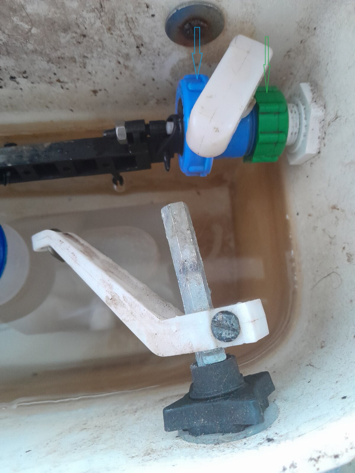

Get a photo of the actual installation, the diaphragm is located at the blue arrow, mightn't be the easiest to open especially if its been installed for years, I would suggest just renewing the whole ballcock assy by (after isolating the mains) opening at the green arrow. (this is mine)
