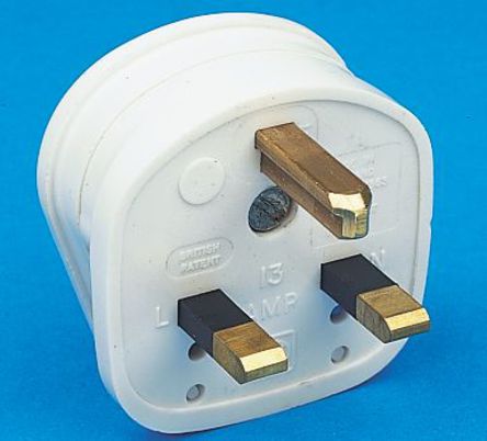

If I want to put my fridge-freezer on a non-rcd protected circuit, am I allowed such a socket on the ground floor, provided it is clearly labelled?
What if I don't use a normal 13A socket, but instead use, say, a fused IEC320 outlet on a spur?

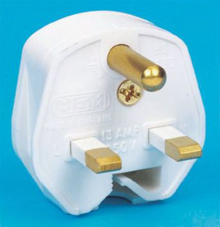

Or one of the "non-standard" 13A jobbies like these:
Or am I simply not allowed to have any pluggable outlet of any sort that might be used to supply something outside? i.e. is my only option a fused captive flex outlet into which I hard-wire my F/F?
You don't have to have every socket on the ground floor protected by an RCD. If it's a single socket behind the fridge, with the fridge plugged in, then it could not reasonably be expected to be used to supply equipment outdoors ;)
The regs say something like " any socket outlet which is reasonably expected to power equipment for external use should be protected by an RCD / 30mA etc "
In my own home I would put a normal socket on, because I know its only going to be used by the fridge freezer........but its more than likely against regulations due to the fact its on the ground floor sockets.
Fuse spur idea is the safe option.......the non standard jobbies....to be honest, I'm not a 100%...but I cant see the problem, only if you were to use a non-standard plug-top on other equipment.
I have spoken to the NICEIC about this before asking them if a RCD socket outlet located at the front and back doors would satisfy regulations and labelled "Outdoor Equipment Only" but they said all ground floor sockets are likely to be used (something I still disagree with, but regs are regs).
I like the way your thinking though........... ;)
In summary, there is no regulation that says that every socket downstairs must be protected by an RCD. It's down to you to make a decision as to whether each socket could reasonably be expected to be used to supply equipment outside. Generally there are lots of sockets on the ground floor which could reasonably expected to be used for equipment outdoors, and therefore people tend to protect the downstairs ring with an RCD. There are exceptions in my opinion such as in your case where you are installing a socket specifically for an appliance which is very unlikely to be i) easily accessible with the fridge in place, or ii) unplugged to be used for something else instead. It's one of those regulations where it's down to interpretation, but from what you've said, in my view you will be safe to use a normal socket outlet.
