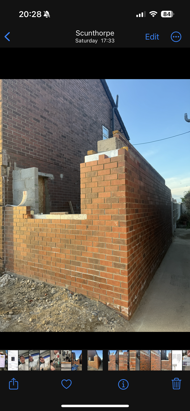

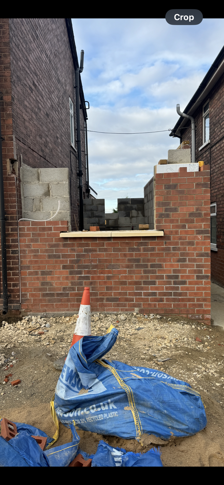

I've built a single storey side extension (300mm cavity wall) to a property I'm developing. The boundary isn't square and as such the front wall measures 2635mm to outside of wall plate, the back measuring 2282 to wall plate. It is 6m long.

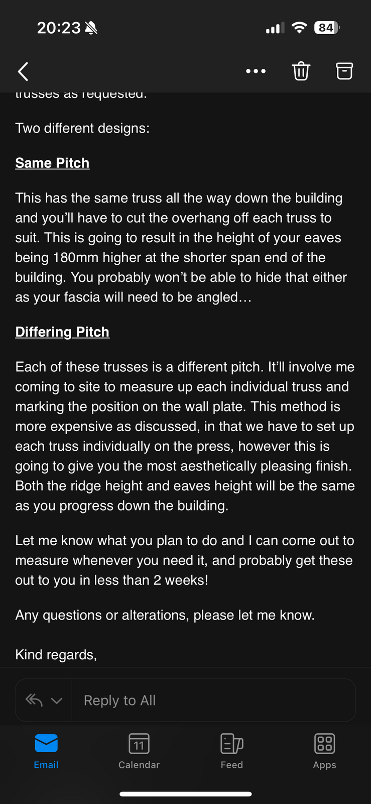

I was going to do a warm flat roof with parapet front and back, however I have had a local truss company come up with 2 different ideas.
One is where all the mono truss rafters are built the same and as you progress to the rear of the extension (the shorter end) you would have to cut the ends of the trusses off back to the facing brickwork. This would mean you'd have to have a fairly large fascia to hide the ends.
An alternative they proposed is each individual truss is at a different pitch, means the ridge height and eaces height remain constant - however going from 17.5* pitch at the front to a 19.4* pitch at the rear. My concern is can this slight twist be accommodated within the roof tiling? Has anyone successfully done something similar before?

I would keep the ridge and the eaves at constant levels, then you can have different angled rafters as you go along, provided they're all in one plane it will work, slates lend themselves well to this kind of roof as the gaps between the battens will need to diminish as you get further towards the narrow end. It just needs to be (very) well thought out to avoid any silly slithers of the slates etc.

BTW we don't know where the boundary is but you should not be overhanging it with your eaves or gutter etc.
Thanks mate. I can't find a photo or any information of a similar roof anywhere! I'd much prefer the tiled roof but don't know if it's too much messing about. I know about the gutters, kept 100mm in to allow for it
