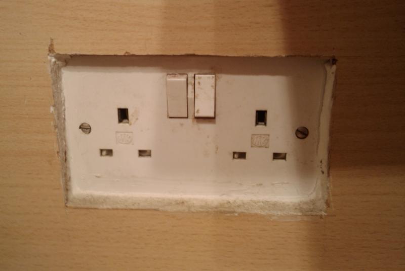

I've got a minor problem in my kitchen. When the previous owner has cut holes in the splash back for sockets, they have made them the size of a standard socket. Therefore the socket itself is sunk right back and looks a real mess.
I think a picture will make it clear what I mean
We are planning to sell, so I'd like a cheap fix to make this look better.
I thought I'd seen some brushed metal sockets that had a slightly larger profile than standard, so would cover up the rough edges of the splashback, but I can't seem to find anything now.
Anyone got any good ideas to fix this up?

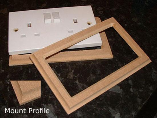

You might find flat plate items with a slightly larger faceplate, but I doubt they will cover that hole completely.
Go to a DIY store, and see if they still sell those awful plastic surrounds for sockets and switches. They are designed for covering up rough plaster around switches etc, do the job, but I hate them.
You may also need longer screws, or fetch the metal backbox forward a cm or so.
Also buy a new socket, it'll dress it up a treat ;)

Also, the flat plastic ones will do the job better than those wooden mouldings.
