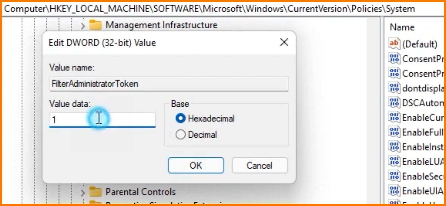

A few things here to try, but you've probably already tried them:
I haven't seen the regedit change mentioned anywhere else.

I haven't seen the regedit change mentioned anywhere else. Nor I, but tried that and the DWORD was missing.
It probably won't acheive much, but did you try creating the DWORD?
(A restart would be needed afterwards)
Yes, I tried the DWORD and also now, another account too - still not working.
